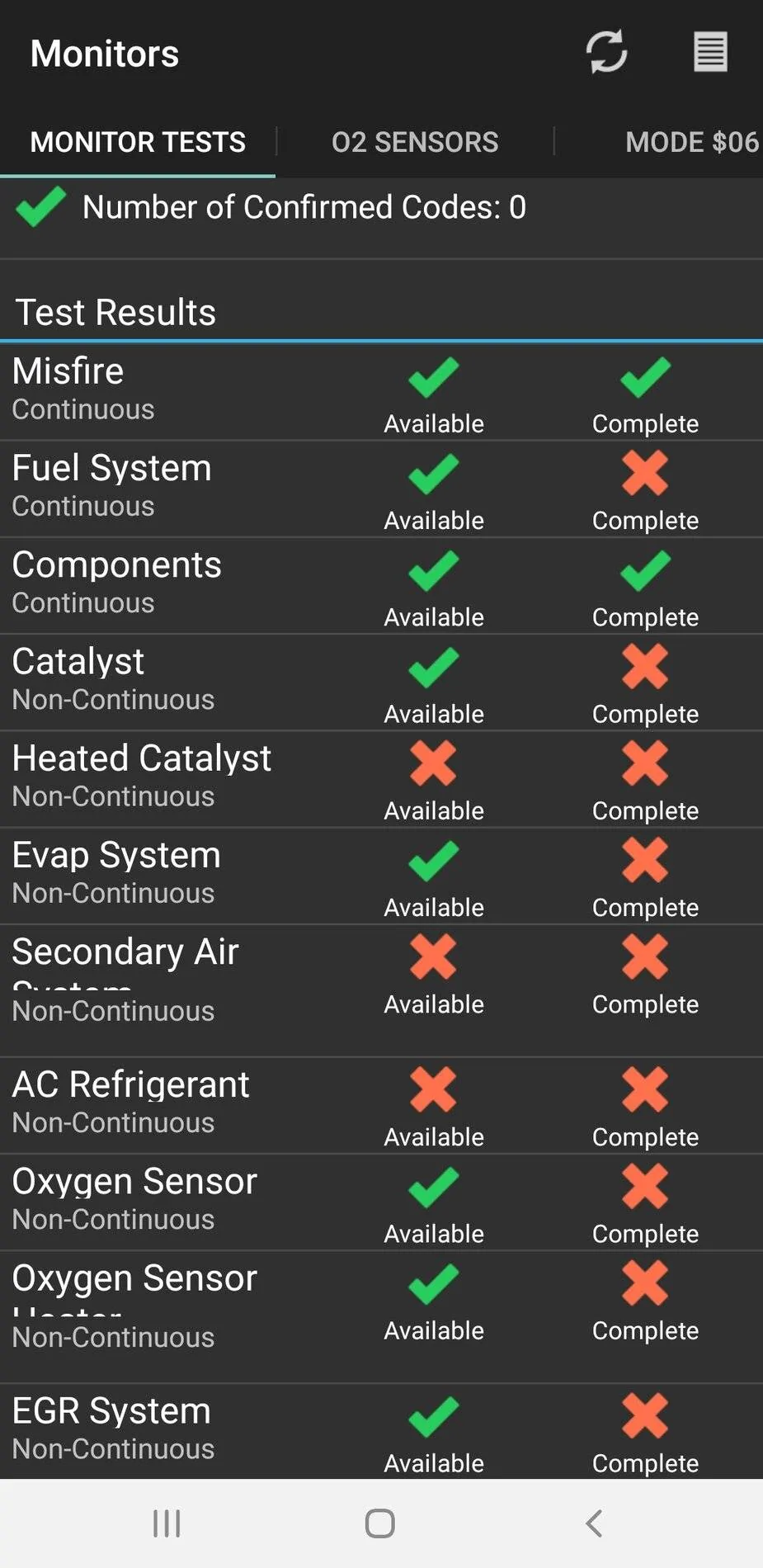

Yeah definitely try your new tune before buying defoulers. I thought I'd need them but so far so good.
Good to hear its possible. Gonna be home soon to try this
Just watch your LTFT’s in real time. If they are correcting, and your DFCO is active, you will have the ability to have all monitors go ready.

His reader said O2 not available. Means they were turned off

Flash the tune. If the cat and O2 show incomplete you should be good. Do a drive cycle and hopefully they will show ready. If they show unavailable you need to investigate more.
If the LTFT’s are shut off, it will say INC forever.

Many tuners forget to enable DFCO as well.

I know if you tune it completely out, 02 Monitor and catalyst will stay INC. I like that idea of having it active above certain speed though!

Ok so everything is showing available now with the tune updated. No CEL yet. Hopefully the drive cycle will complete. Torque now shows catalyst as incomplete instead of the previous unavailable
