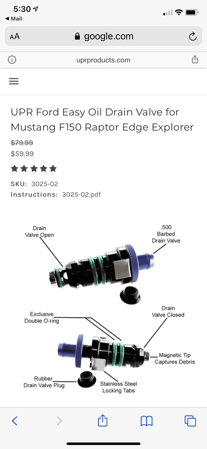

I’m just going to try one of these the next time I change my oil. Throw a hose on the end and not make a mess everywhere. I’m tempted to do the oil filter relocation so I don’t have to put a plastic bag around the filter every time.

I just don't trust any of those plugs. Plus they're metal, which could mess up the plastic pan. Not worth it to me. And the good news is I could control the flow with the stock plug perfectly fine, so no reason to even consider any of those things. Plus I want to drain as much oil as possible, and both UPR and Ronin say not to remove it with every oil change (probably due to the risk of damage to the oil pan with the metal). But to each his own, of course :).

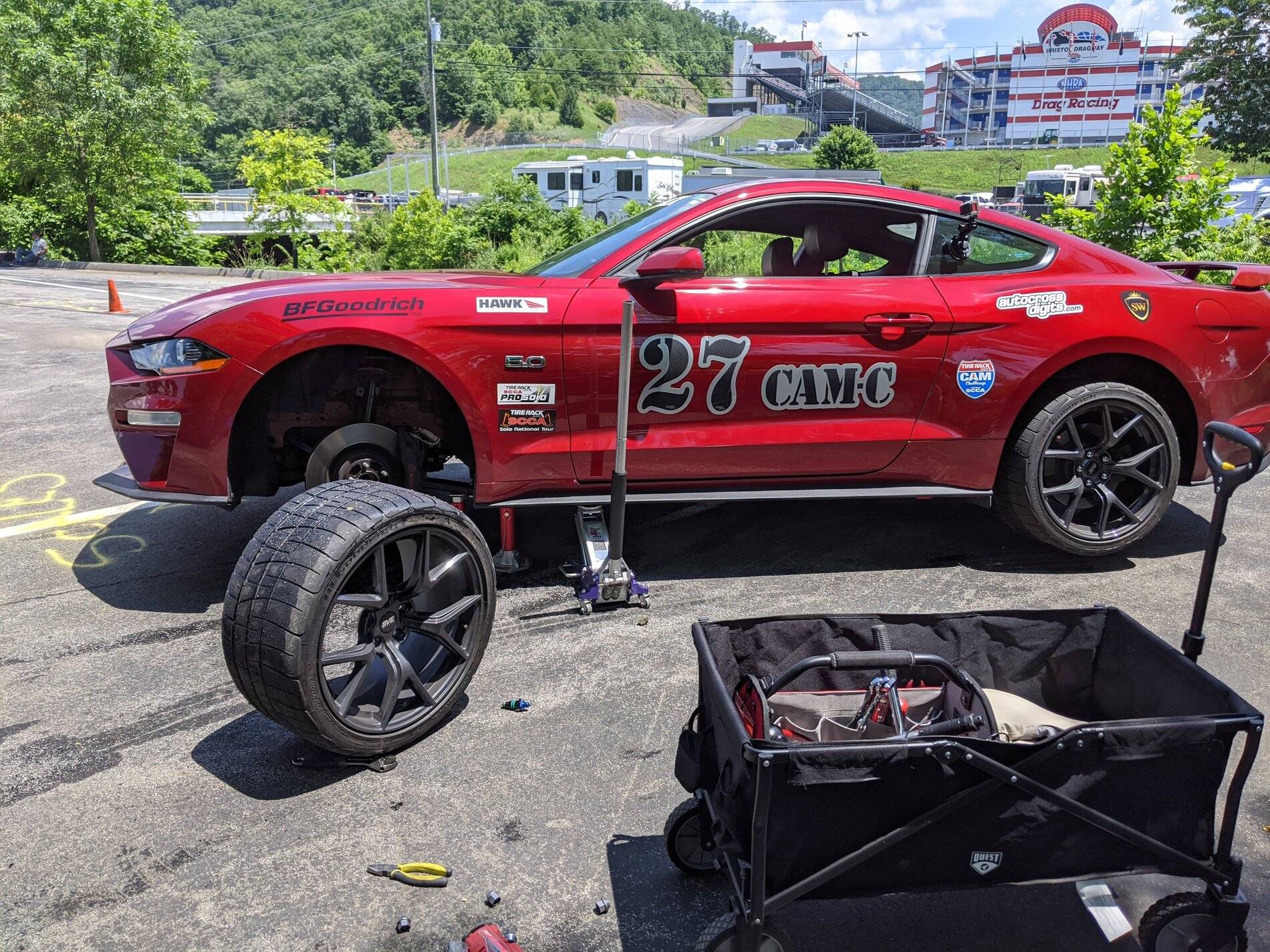

As for UPR drain plug - I had unfortunate experience with it when a cone ran over during autocross turned it open is I started losing oil. Shut the engine down in time.
I am back to yellow OEM plug.
(look at the concrete around and the tire - it's all oil on it - in process of replacing the UPR plug with OEM one I've had as a spare while my people went to get oil and funnels since the engine eventually ended up completely dry).
