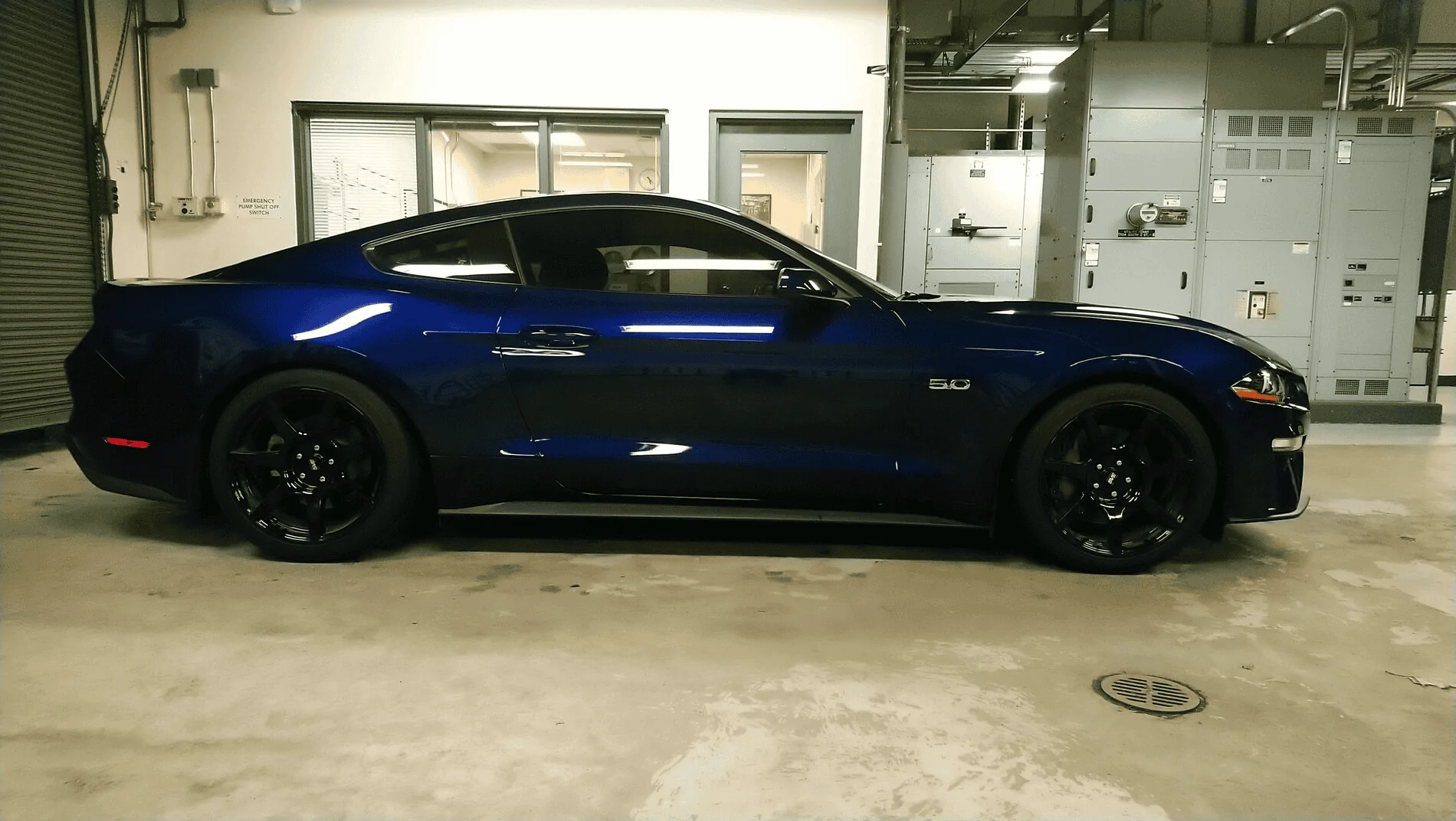

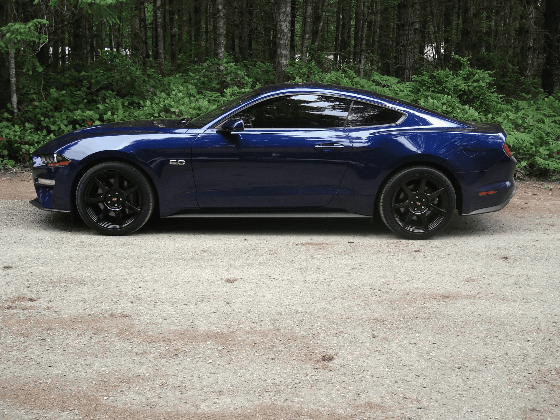

This is sort of an adjunct to my other thread where I just installed a set of SVE Progressives for a 1" drop, along with a set of Koni Pro Actives. From what I've learned, the Springs are basically a set of rebadge Eibach Pros, so it's not as if they're some garbage made in China.

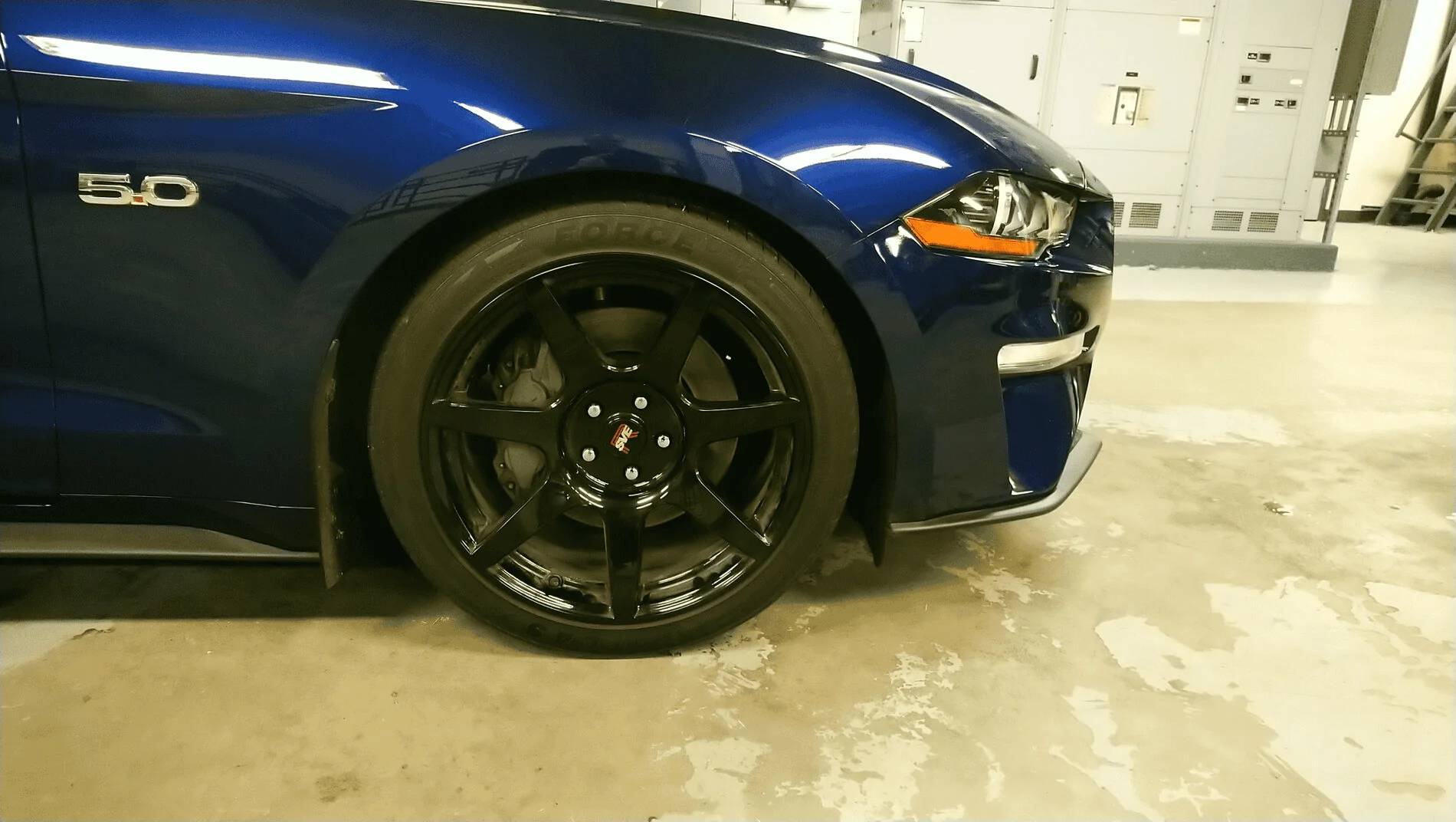

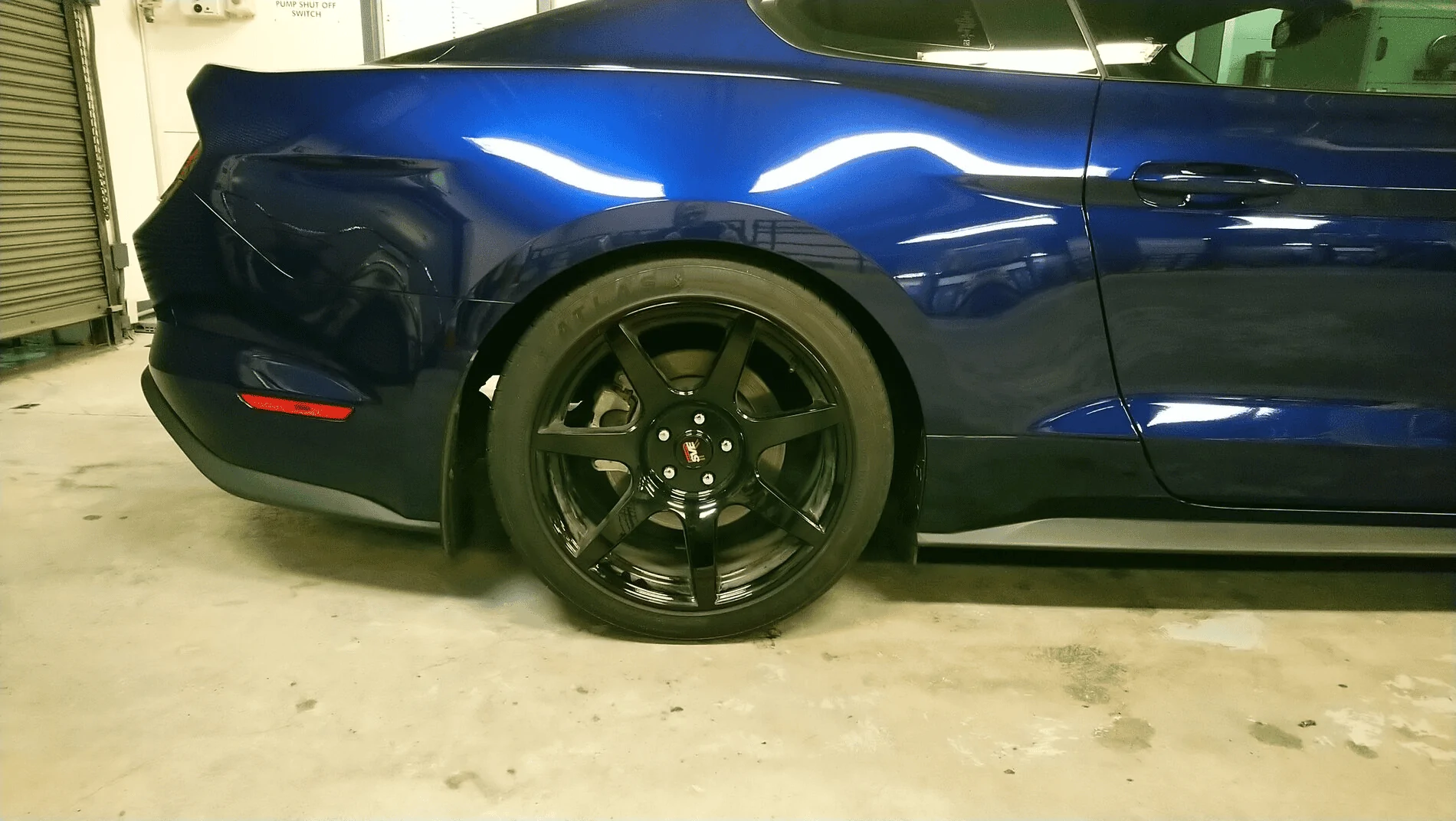

Anyway, I installed the setup, and the rear has settled about 1/4" to end up at 27". The front has not settled at all, even after clocking the bushings with an alignment, and numerous drives around town for the last couple weeks (~100mi). The front is still basically at 27.5", a full 1/2" higher then the rear.
I guess what I'm asking is, how many of you have had this issue with your drop?
And, did it eventually settle out and level itself after weeks or months of driving?

The fact that the front looks like it dropped only about 1/2" really has me a bit disappointed. The back does look like it dropped about 1", which is advertised. But the front.... makes me wonder why I spent the money and time to get almost the same thing.
The way I see it, I have 2 options. Just add some spacers to the back, and raise it back up 1/2" to match the front.
The second option, is to tear apart the front, cut the springs to get another 1/2" drop. Then, add some Steeda camber brackets to the rear, since the rear is at -2.7deg, and out of spec.
I honestly don't know what to do.
