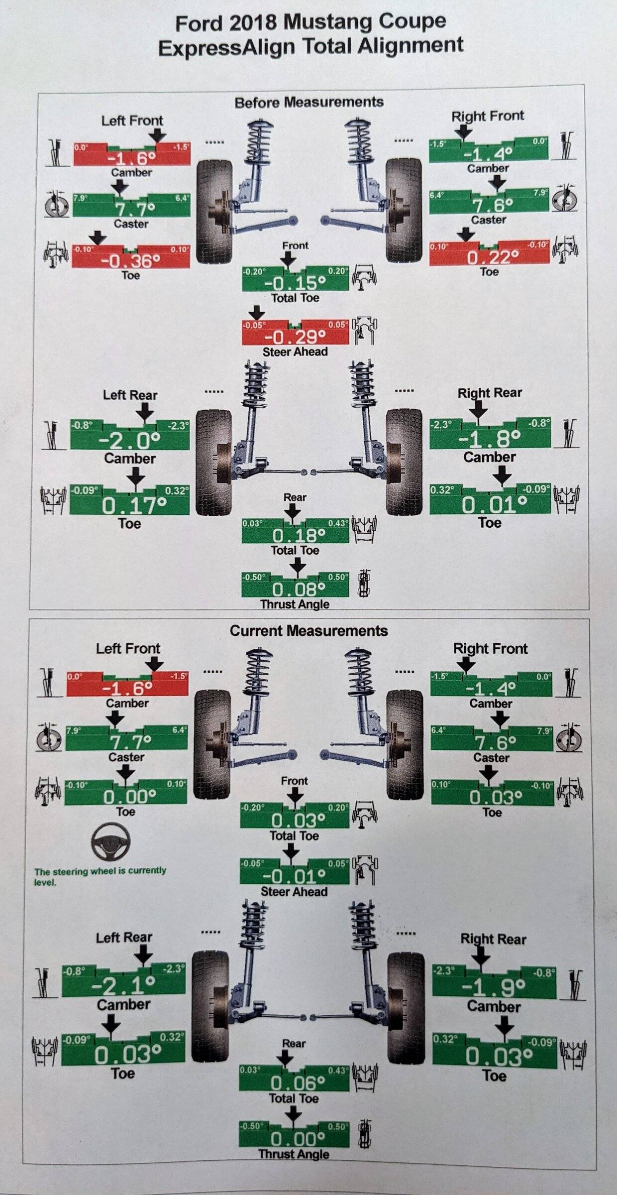

I recently went with the BMR Performance Lowering Springs ( 1.2" drop front and 0.5 drop rear), just had it aligned. Camber on the passenger's side is just fine. The driver's is just out of spec. I'm getting -1.6 in the front and like -2.5 in the rear. Odd it's only the driver's side that's out. Anyone know the camber specs of a 2020 Ecoboost Premium?
Here's where my 2018 EB was before/after an alignment after installation of Eibach Pro-kit springs.

Just shoot for 0 front toe, -1.5 camber in rears and 0.12~0.15 rear toe and you should be good.
Front cambers will be off a bit after a 1 inch drop but not worth spending more money to dial it in imo.
