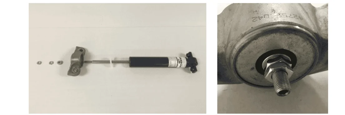

What are you calling
i recently installed upr billet shock mounts. I got everything tight as i was able to. Problem is you can't get wrench on the threaded nut that goes on shock shaft. I could only use socket and once it is snug the shaft spins. I notice over small bump i get a light clunking sound from the rear area. Any ideas?
Reading what you posted, sounds like you mounted the shock mount to the body first and then tried to install the shock.
Looking at the picture, you need to install the shock & shock mount as one unit.
The shock appears to have an Allen head, using an Allen wrench will prevent the shaft from spinning, as you torque the nut.
When the shock and mount are placed, you will clearly be able to torque the 4 upper and lower shock mount bolts .

There were no instructions. And the the top of shock has a flat spot not allen head. I dont see how mounting them with shock on or off car makes a difference
The picture was from the Steeda install manual seen on the web page.
Assumed that was suggesting the assembly was to be done before the shock install;
Reading the post, noise started after the shock install. Leads me to believe the spinning shaft, is indicating slop in the upper mount.
The sound describe fits that. But you'll work it out,
Me I'd have known that loose parts and noises that show up, after the fact. Is a red flag to inspect the last area worked in... but that just me.
