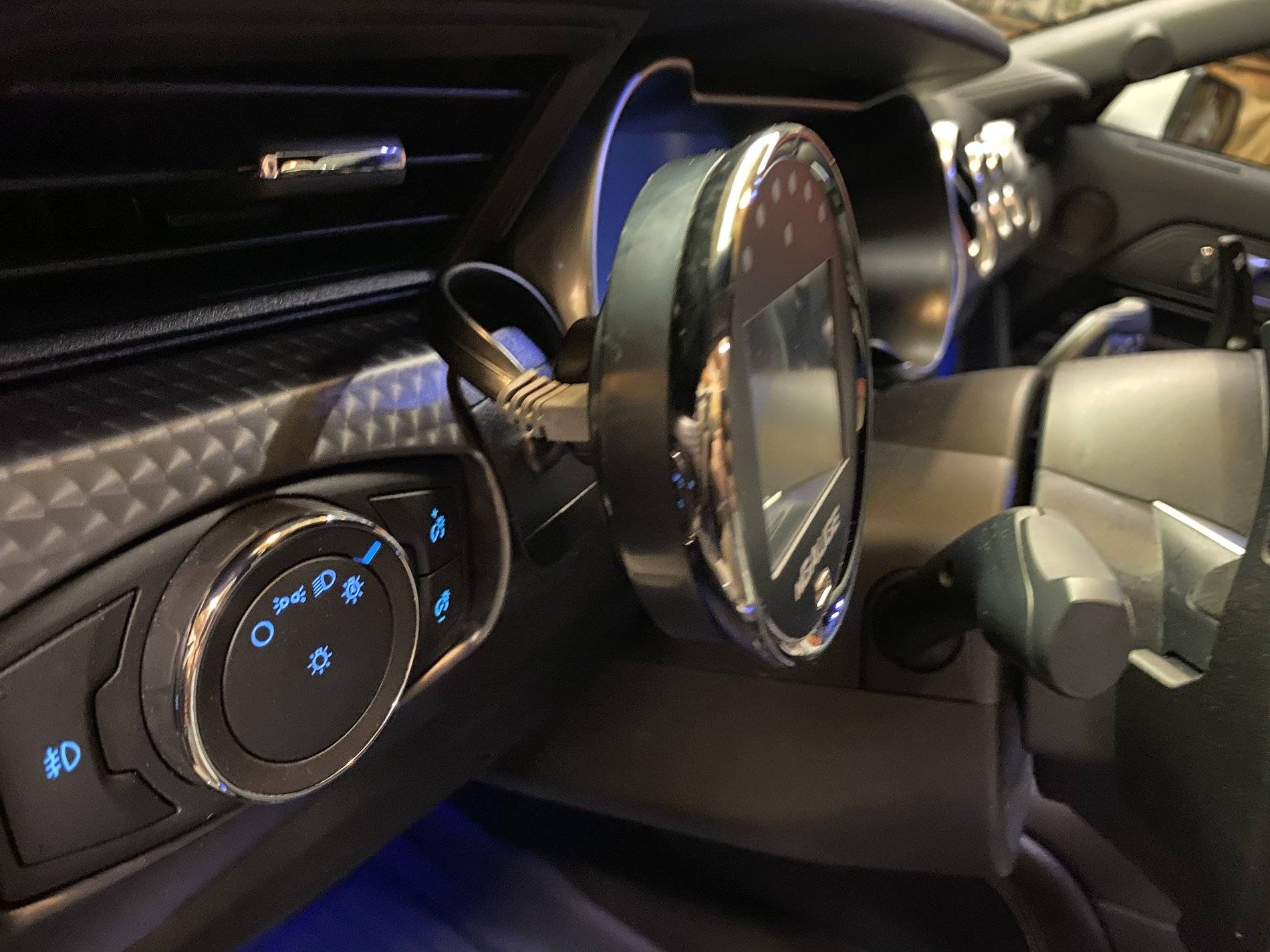

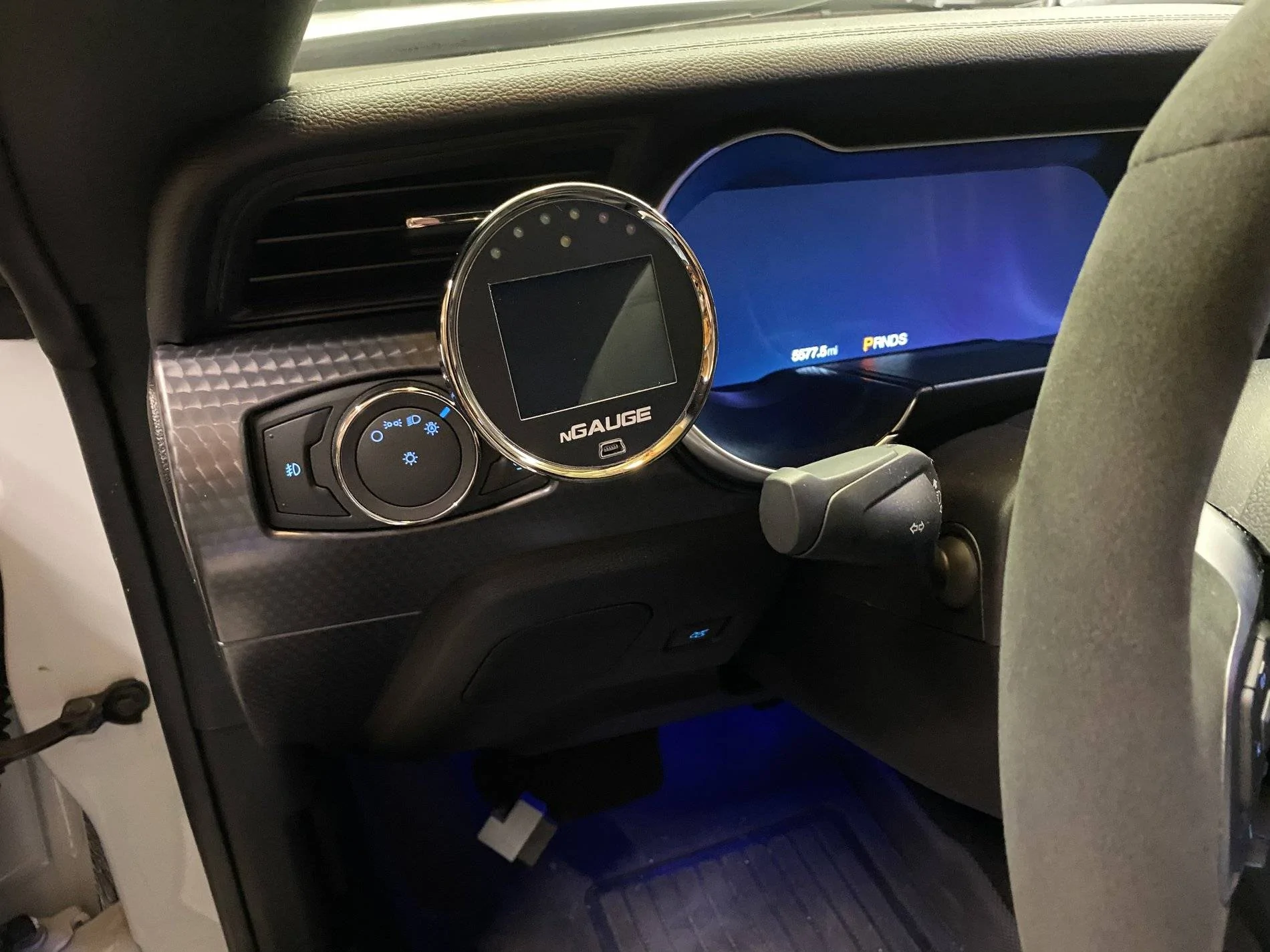

I went with a $12 cellphone magnetic mount. Didn’t use the back cup mount that attaches to the gauge. Perfect for me. Eventually route the wire out of the vent. But for now it’s fine

Looks good man. I use those same mounts for my cell phone. Not sure why I didn't think of that. lol
I like the flat cable..
Wonder if I can buy that separate.

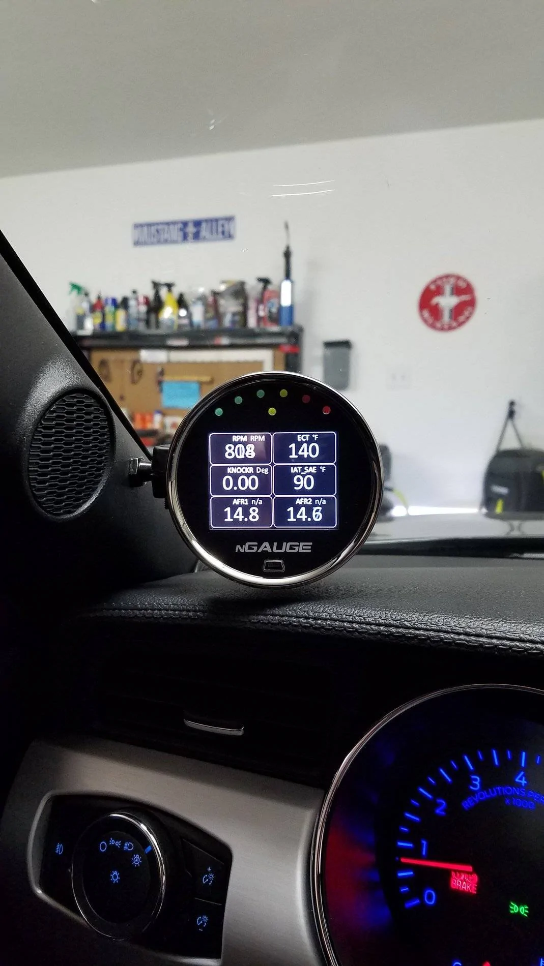

I mounted mine around the same location but used the windshield mount

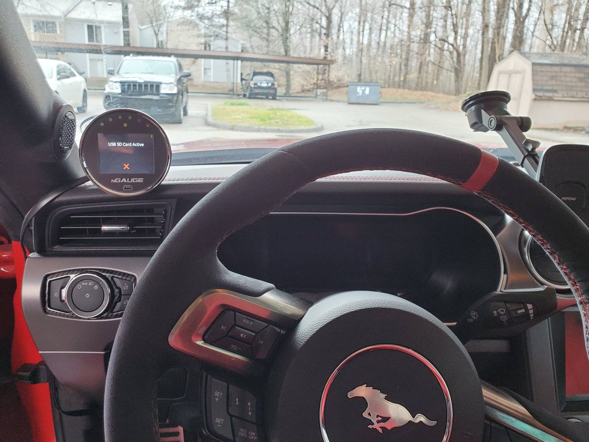

I had a windshield mount but the motherfucker come falling off the windshield if it sat out in the heat for long.
This is why I finally got fed up and did this mod....lol
The windshield was fine for me too but when I open my car after work and my ngauge is laying on the floor really pissed me off.

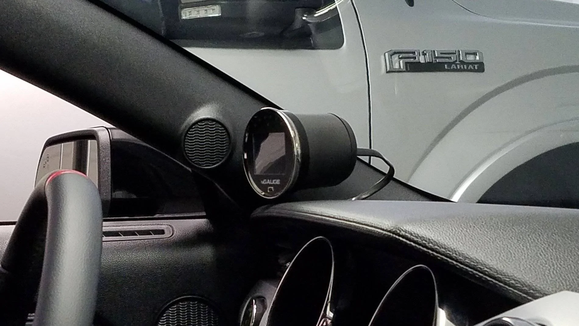

Got around to doing this install last night. No more getting back in the car and having the nGauge hanging from it's cord after falling from the windshield. Here's a couple of pics after the install.

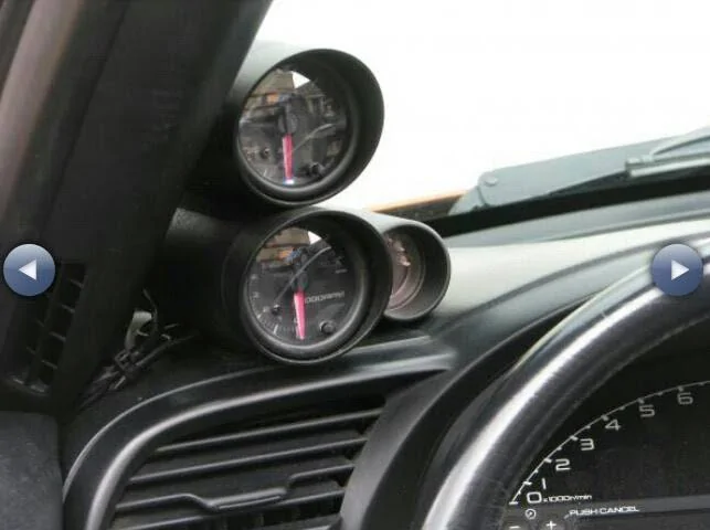

I have been installing all track have to have gauges on my A pillar long before it was cool to do so,(mid 70's) here is a snap shot of the A pillar set up on my Honda S2000 I used simple 2 1/8" gauges and housed them in 1 1/2" black pvc tubing cut to match the windshield angle. Everyone that looked at it thought it was very nice.
They do look good. Is it just my eyes or are the tubes wrapped in something too?

I cut a groove on the side to slide the wires thru , used a old windex bottle cut into the oven shape of the back side of the tubes and glued into place. Coated them each with Crinkle paint, then sprayed over with satin black. Gluded them together and secured them in place on the A pillar. The shift light had the same treatment and glued to the tubes. All held togather for 6 seasons of track time
