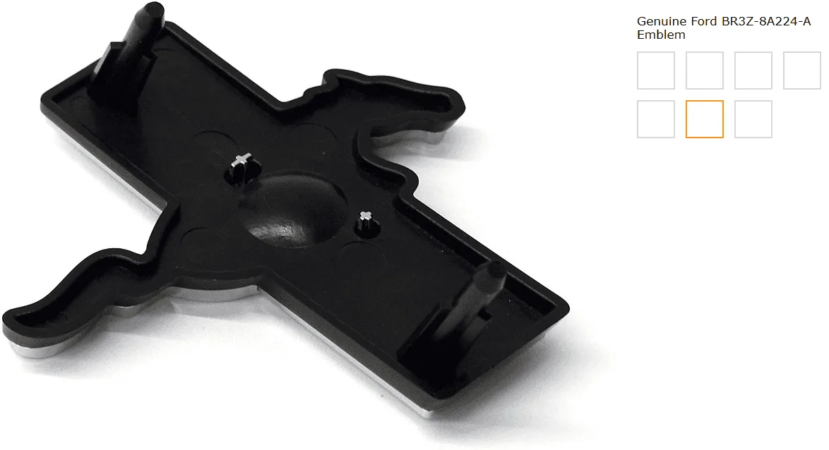

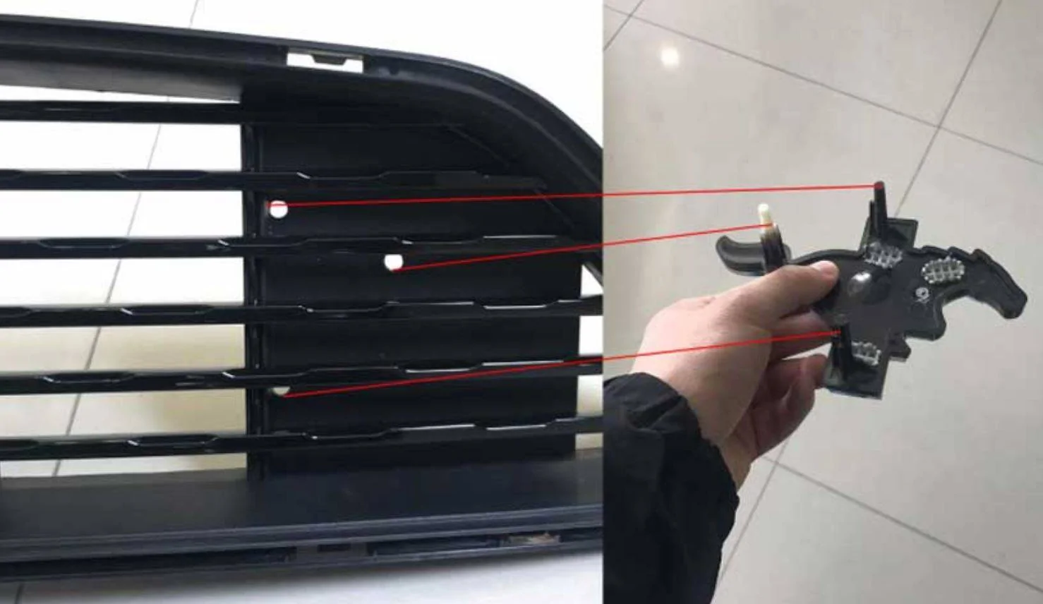

That is how the factory GT/CS emblem is made and mounted, its a chrome emblem in a black housing. you use three one time use lock washers you slide along each of the three pegs till it is tight against the grill surface. That method will work fine with a curved grill, but would need to ensure some sort of contact, meaning at least the top and lower peg and the push lock washer can contact well with honey comb portion, the washer can be angled if needed, does not have to be on a pure flat surface
However the stock GT/CS emblem pegs are thicker early to not go too far into the holes and length is designed for the depth of the grill to the base plate.

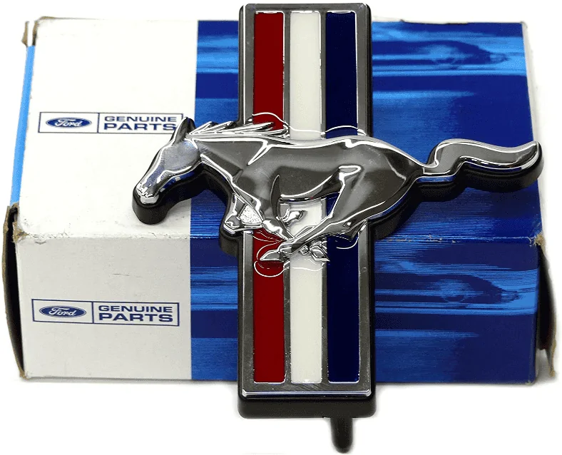

Oh, I'm just old enough to be sentimental about having a tribar pony somewhere on the car.
This is what I have:

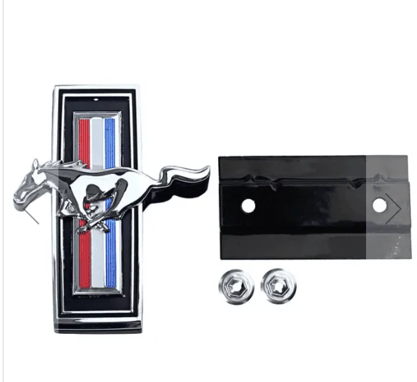

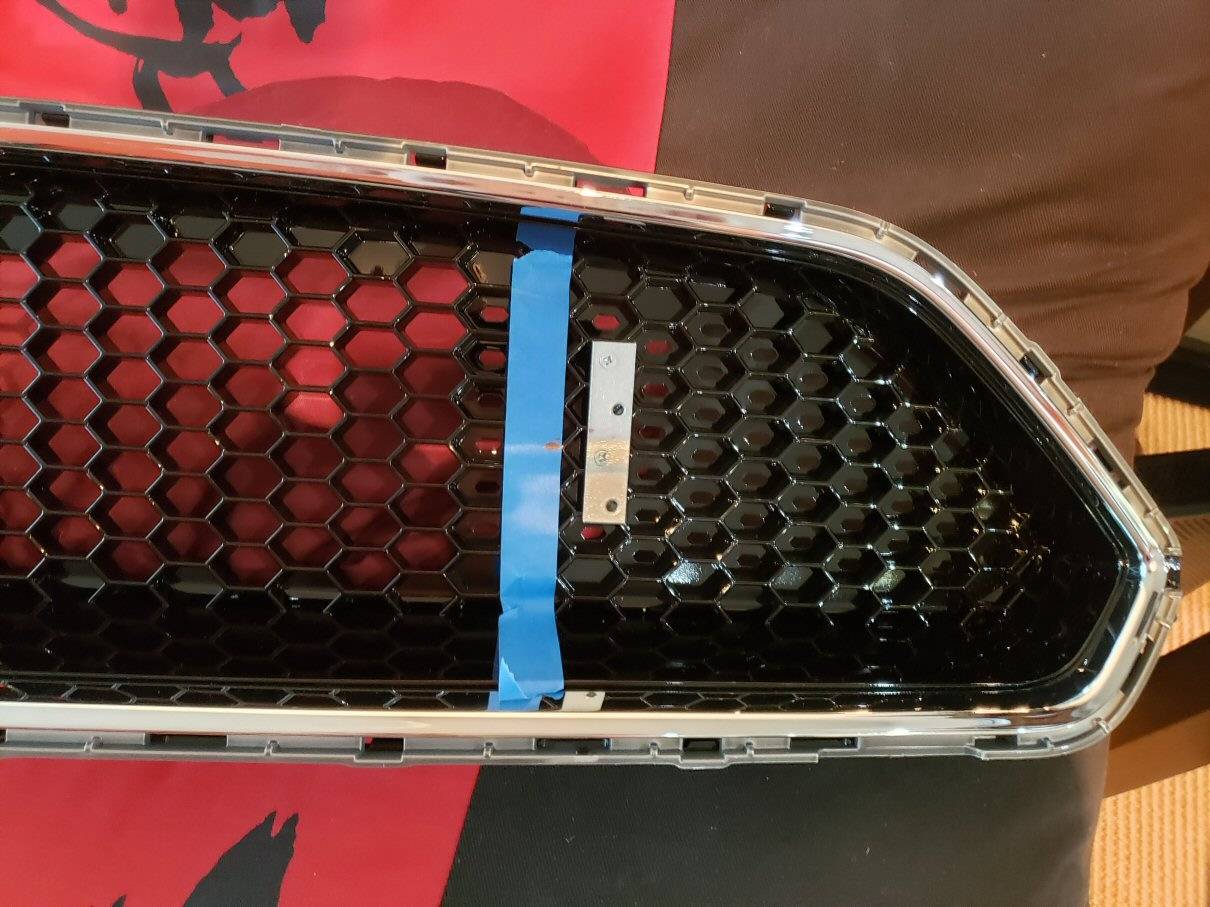

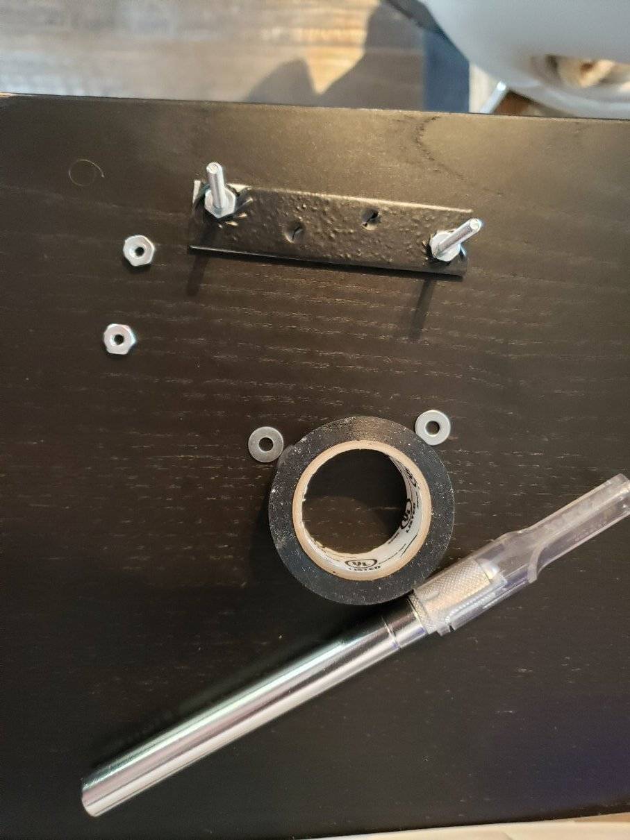

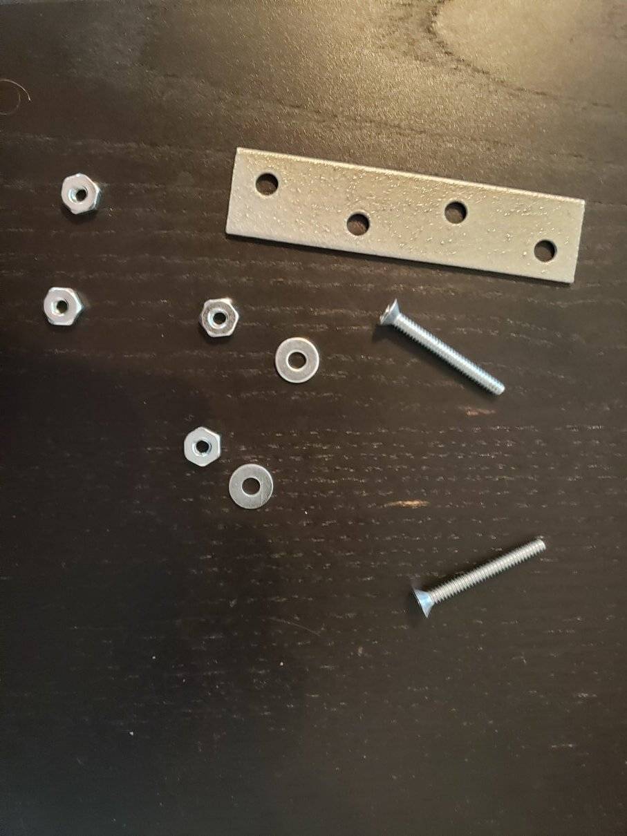

Part I: The Plan, (such as it is):
A galvanized steel plate that's only slightly smaller than the tri-colored bar should give the central part of the adhesive backing something to grip to:

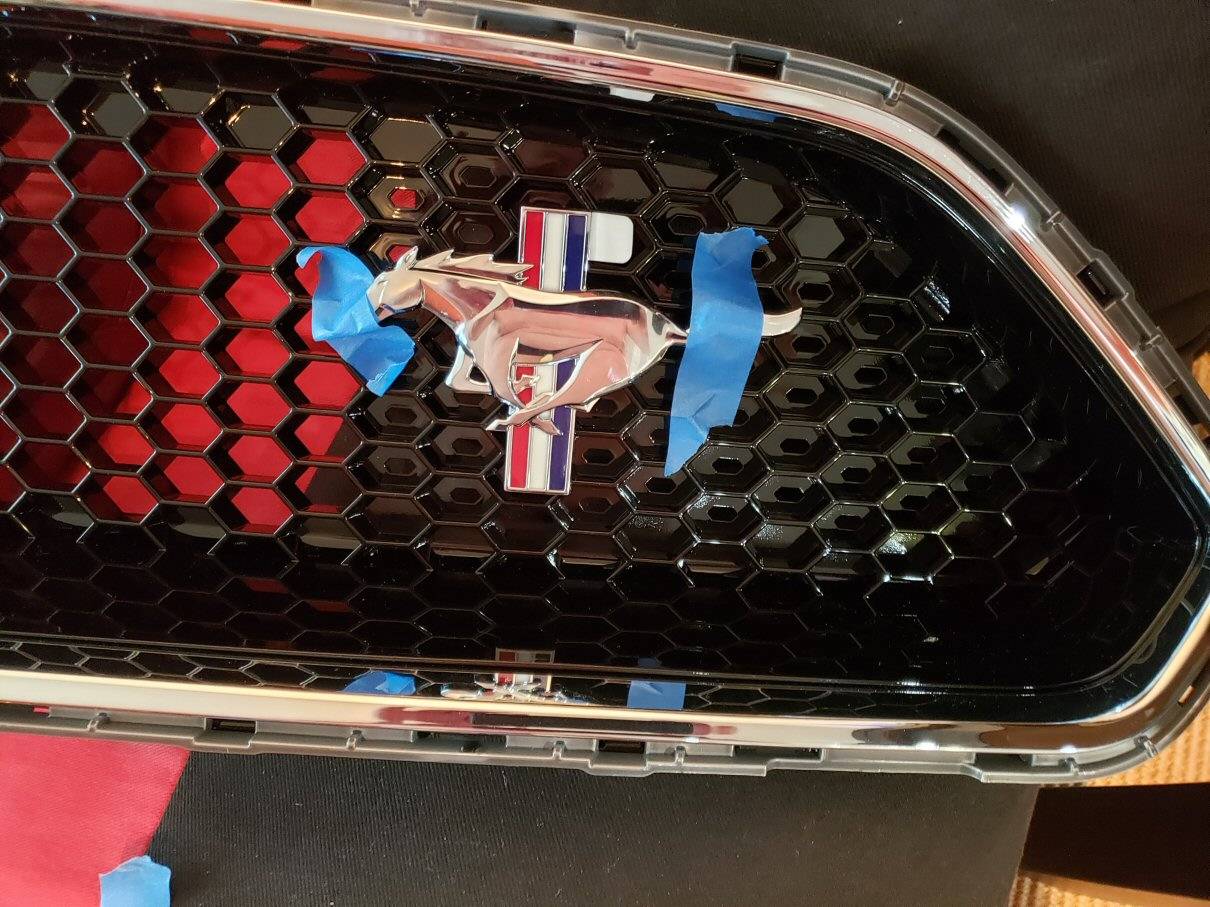

Part II, or What Could Possibly Go Wrong?
That I can think of? All of this:
  1. Will it hold on, under normal wear, with just the center attached? Probably. I dunno. The adhesive should also attach to part of the eggcrate; I just don't think it's enough. I may find out.
  2. Will it withstand a little abuse like a car wash? I won't be finding out.
  3. Would someone be able to pull it off? Uh...yeah, there's that. I've never had anyone try to pry an emblem off one of my cars that I know of, so one can hope...
  4. What happens if it comes off or disappears? I unscrew the galvanized plate, hope there's little or no visible wear behind it, and chalk it all up to experience.

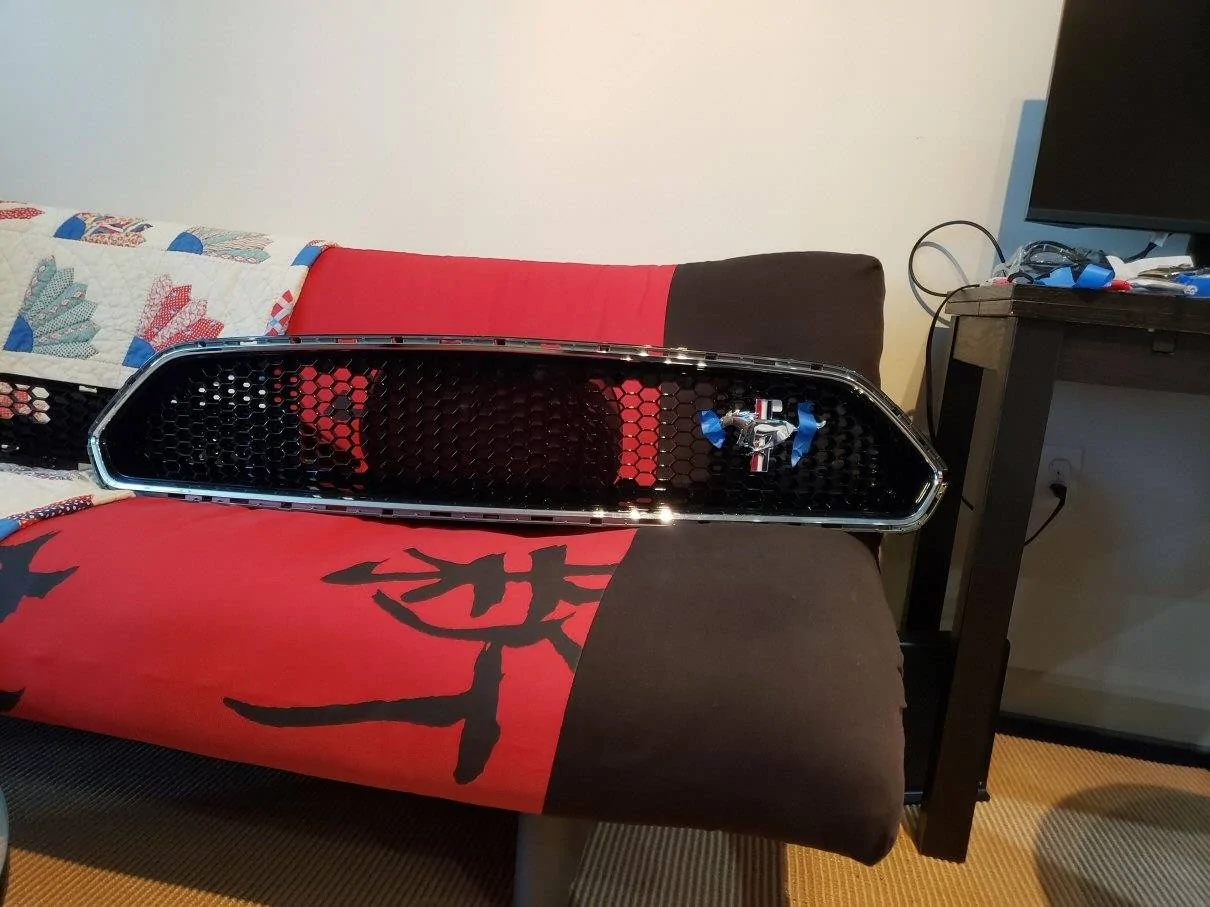

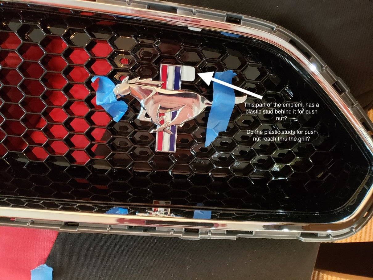

On the right track, couple of questions, seen in the photo. Stud locations, arrow is pointing to a plastic stud ? The other stud, is low about mid point (white strip) ?
Creating an upside down L .The white tab to the right top is a no brainer paint to black, all gone.
Give some thought to the idea, of mounting the galvanized steel plate on the back side of the grill.
Sandwich the grill, between the galvanized steel plate and emblem.
I have a couple of things in mind. Can you measure the stud length, and grill width'. Also is it possible to snap a picture. Showing how much stick or poke out of the emblems studs, Is there beyond the rear grill face. Galvanized steel plate shown looks to be 1/16" 3/16" maybe
Interested in what you can tell me about the parts

First of all, thanks for your suggestions and help.
A couple of quick things -
  1. The studs on the back of the emblem are very small. intended to enable accurate positioning on a professionally pre-drilled or formed piece. They're not really useful for anything else. The actual plastic studs for the push-nuts are on the backing piece shown in @Mustangpursuit 's post here, which is the part I don't have and was trying to substitute the steel plate for.
  2. The white tab at the top right is part of the protective backing on the 3M adhesive. You take hold of the tab to peel it off.
And with all that said, and thanks to the posters who've made encouraging suggestions...I'm putting this aside, for now. Two reasons:
  1. I'm not mechanically inclined, but I tend toward perfectionism where the look of things is concerned. And to my eye, this ain't perfect; and
  2. I had to follow this through to see what it looked like, but at the end of the day I just don't love the look as much as I'd expected I would.
So...thanks for the interest and support, guys. I'm sure I'll circle back to this obsessive/compulsive state of posting next Spring when I go to change out the seats. :crackup:
