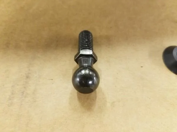

Next I found a 16mm ball stud for a gas strut piston.
http://www.atomicmall.com/view.php?...rut-Shock-Ball-Stud-Mount-Lid-Bracket_2514775

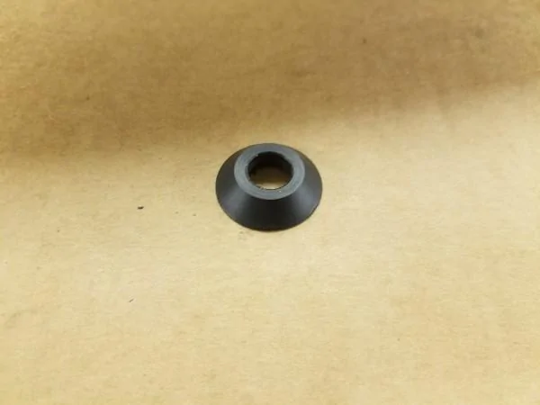

I then machined a spacer from some black plastic I had.

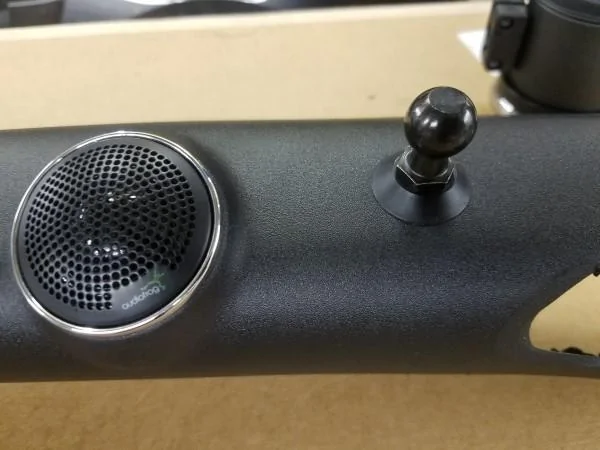

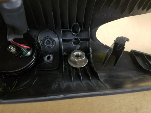

Next I drilled into the a-pillar cover.The inside needs to be ground open as the are some support ribs inside.
Here is the outside.

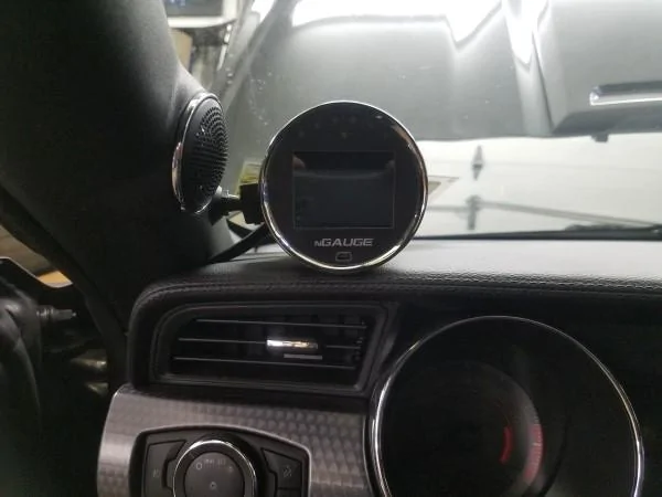

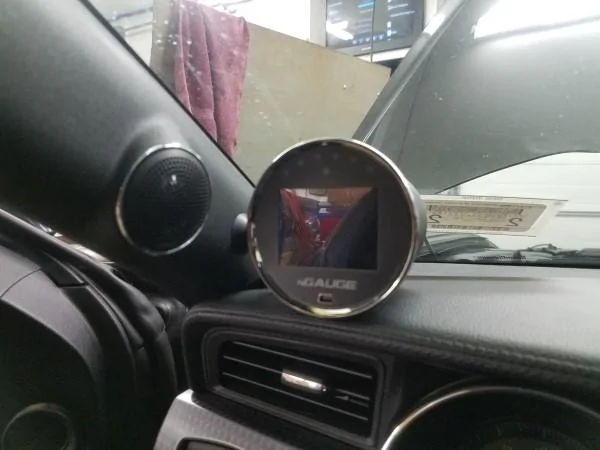

And now with it all mounted back in the car.
It is out of the way and in the line of sight perfectly.It is angled so you can still remove the SD card.
If I had to do it again ,I would move the bolt up abit higher and not use the spacer.But I'm not taking it apart.

I would forget the spacer.I was trying to make it look nice,But it pushes the gauge over more.
So the best bet would be to cut the stud in half down to about 3/8".
