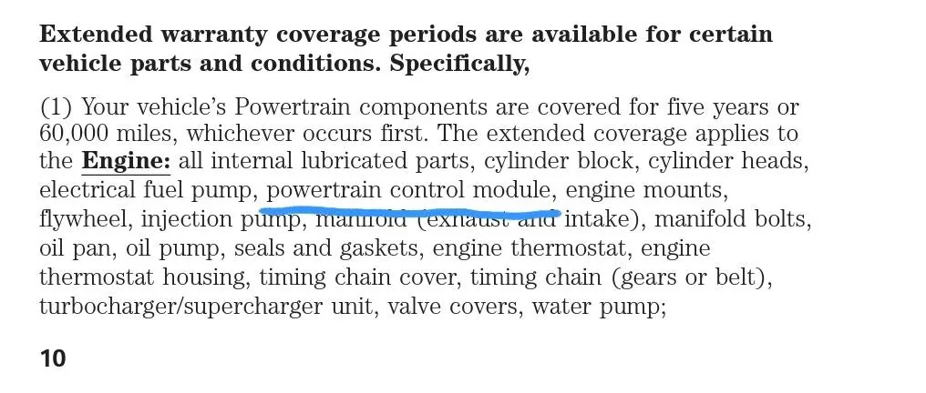

@Cobra Jet
Well, well, well, look at this. Cut right from Fords 2018 Warranty Guide...
Why would they say it's not covered? Because it's a programming issue and not a replacement?

Glad you checked, right? Not many folks realize what the Powertrain covers and it covers quite a bit.
I would point that out, because whether the PCM needs to be reflashed for a warranty repair OR say a PCM replacement, to me they should not be trying to charge you for any PCM programming.
The AG shutters, if it were me, I'd tell them it's not a priority for you at least not at that expense.
