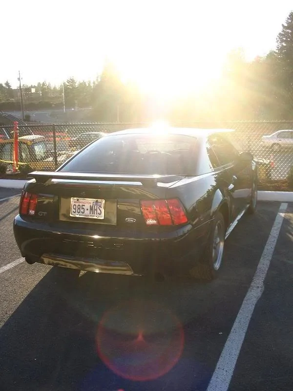

I think calling it throttle response would be incorrect. I had a 2001 GT 5spd car that I had driven quite hard in stock form and in full bolt on form.
2001 GT mods:
JLT CAI
Professional Products 70mm TB and Plenum
BBK LT Headers
BBK Offroad H-pipe
Magnaflow Magnapacks
Fidanza Lightweight Flywheel
FRPP King Cobra Clutch 10.5"
TKO500 Trans
FRPP Aluminum DS
Diablo Sport Tune
I do remember the way it felt when I installed the FW and the DS and the car had a bit more git'up and around town driving was improved immensely.
With all of these modifications the car had a very crisp feel, the pedal feel was very direct to what I was putting through the rear tires. I could literally use my right foot and start wheel spin as soon as I wanted, drifting/powersliding had a very organic feel, I could place the car where I wanted. *sigh* I miss that car too.
