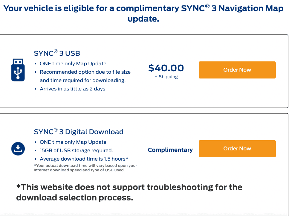

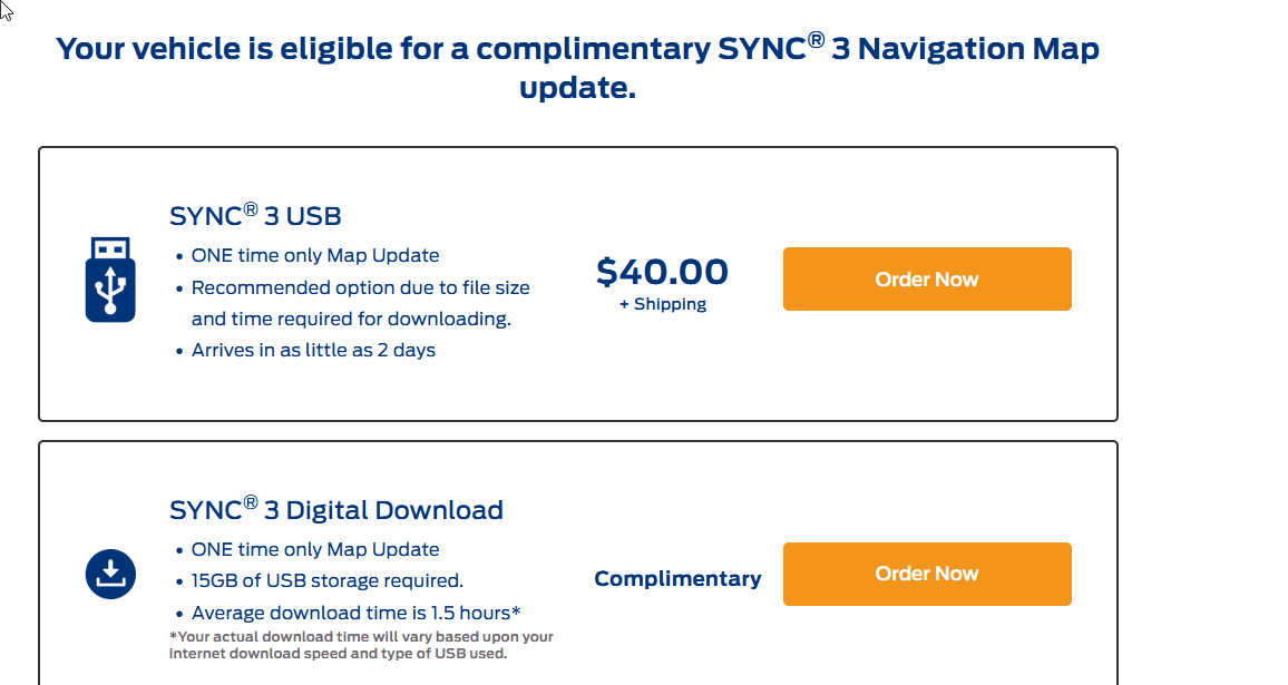

So it looks like Maps NA 2 20 is ready to go. And, at least for me, it's still free. Now starts the fun.
Make sure to start with a clean, properly formatted, drive with at least 32gb of space.

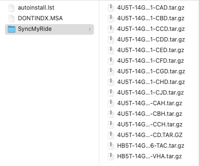

OK all done. Just over 45 minutes total. All I need now is time to upload to the car. Probably tomorrow.
Here is the final file structure. Note 4U5T-14G424-CD.TAR.GZ is the license file.

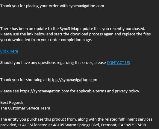

So i just got an email saying to disregard the previous download and to re-download the maps as there was an update made to them. Anyone else get this?
I downloaded the files yesterday and did not get this. I think this was for those of you who did the download on 9/1.
EDIT: :explode::explode::explode: Just saw this. Came in at 1:55 PM today.
Dear Ira,
Thank you for placing your order with syncnavigation.com
OrderNumber: XXXXXX
There has been an update to the Sync3 Map update files you recently purchased. Please use the link below and start the download process again and replace the files you downloaded from your order completion page.
Two hours I will never get back. :frown::facepalm:
