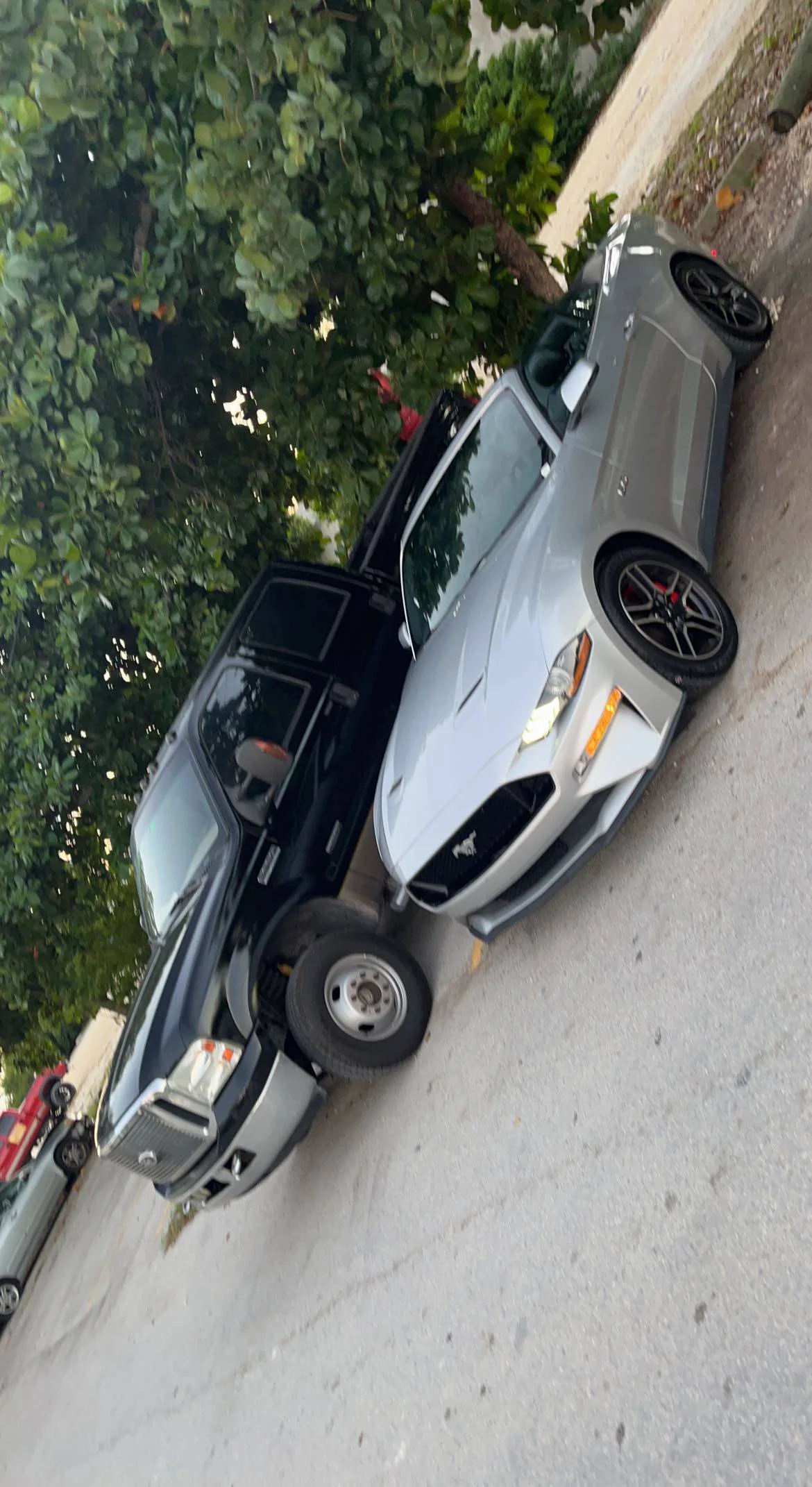

So I just got new rims on my 2019 ford must gt premium they are 19x9.5 all Al round and my question is if anyone knows what the biggest I can put on in the back with keeping stock suspension? Thank you!

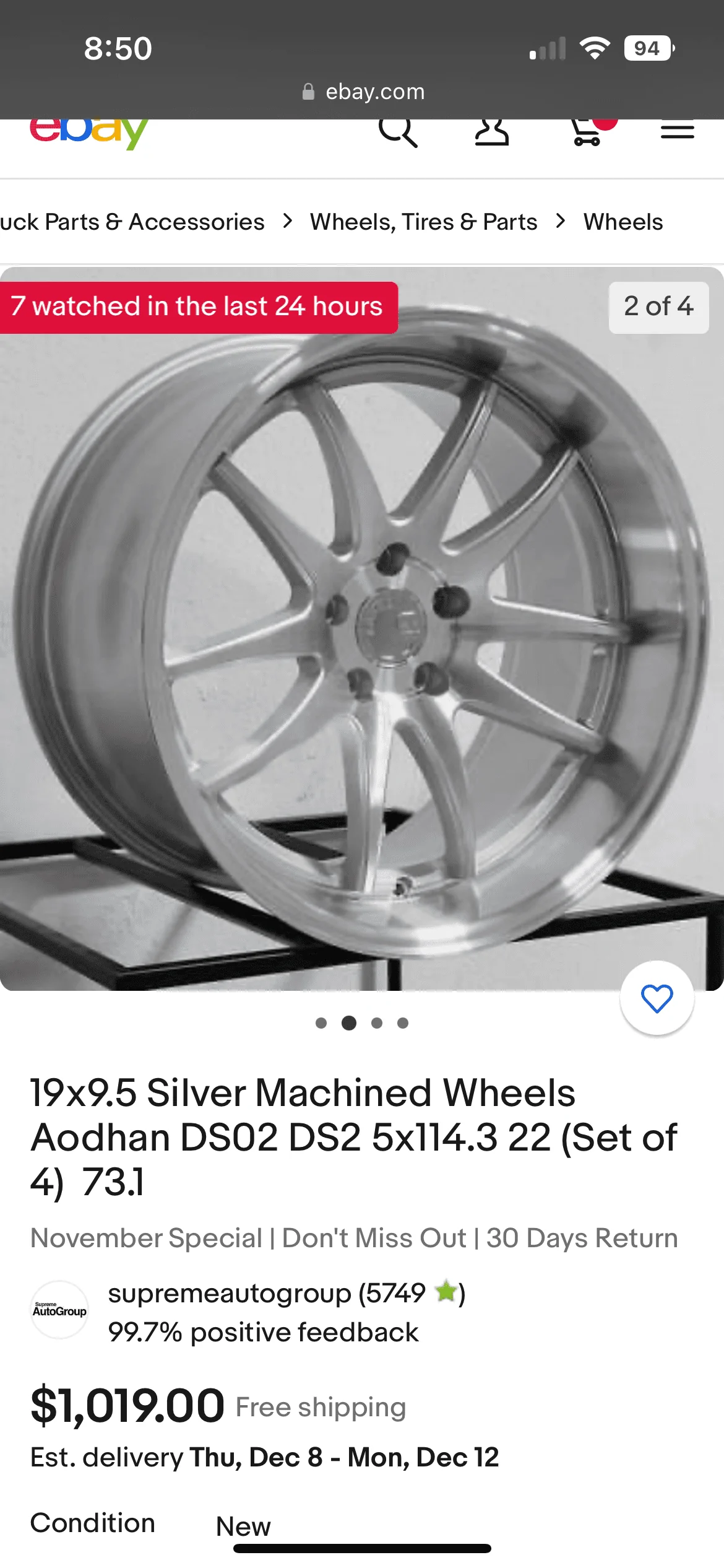

My mechanic had ordered 305/35/19 for the rears and 265/35/19 for the front so I’m curious how that is going to look I didn’t do wider wheels in the back because I was on a budget and this was the best pair I found
On this mustang

I agree. I can't see how the mechanic would recommend a 305 on those.....that 22 offsets may be an issue also. I am not sure those wheels in the pics are made for the Mustang. As they say, pay once and cry once. Save a little longer and get what you really like.
