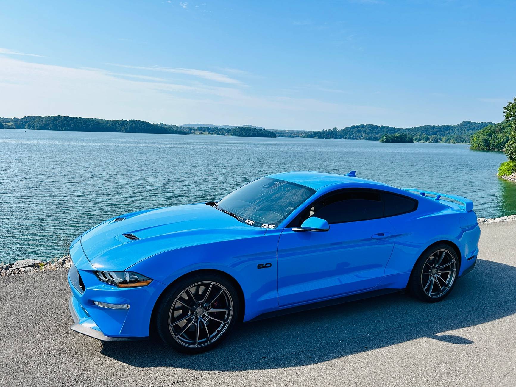

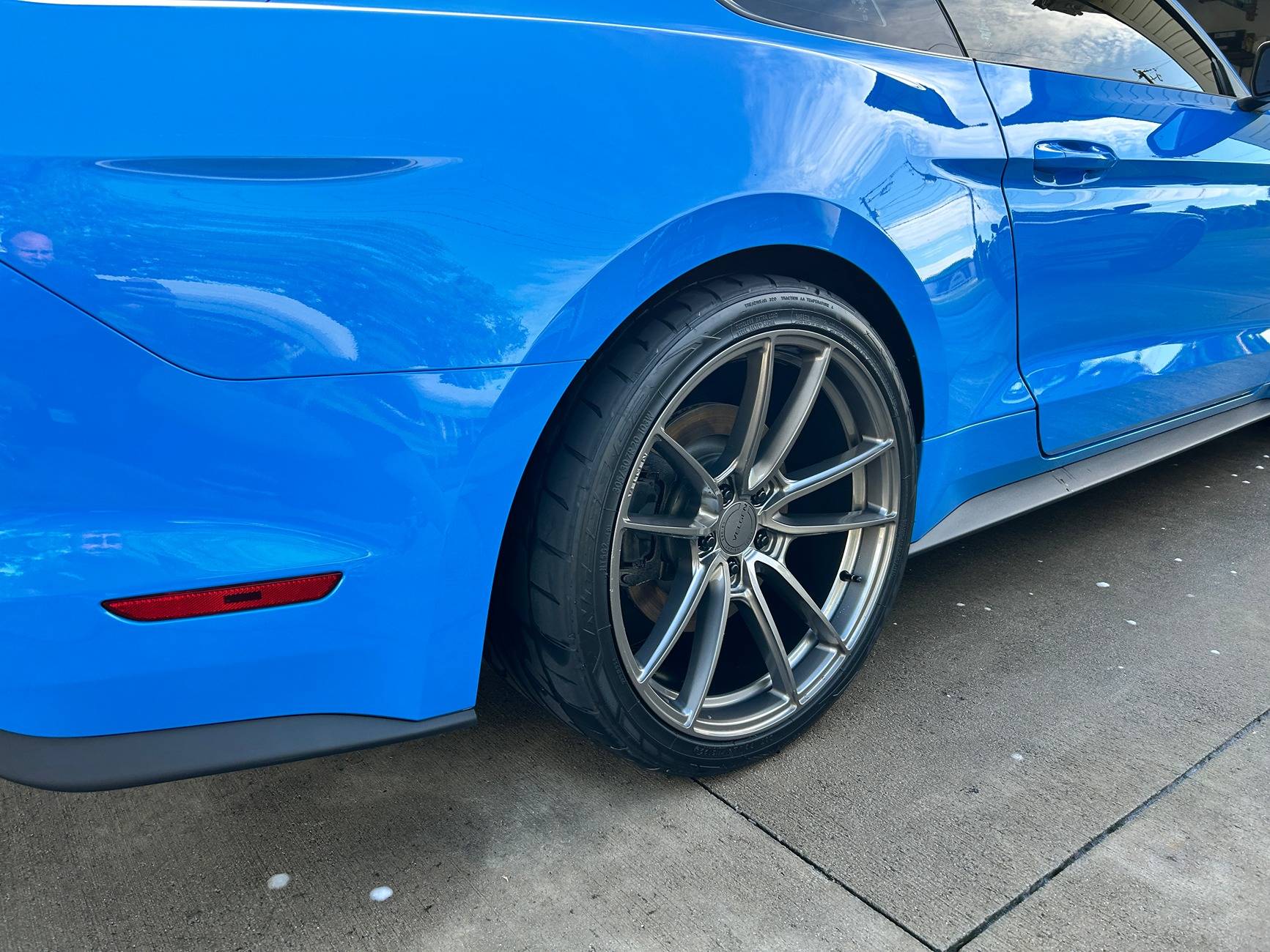

This was the Velgen VF 5 setup in Gunmetal. They are 20's but you get the idea..

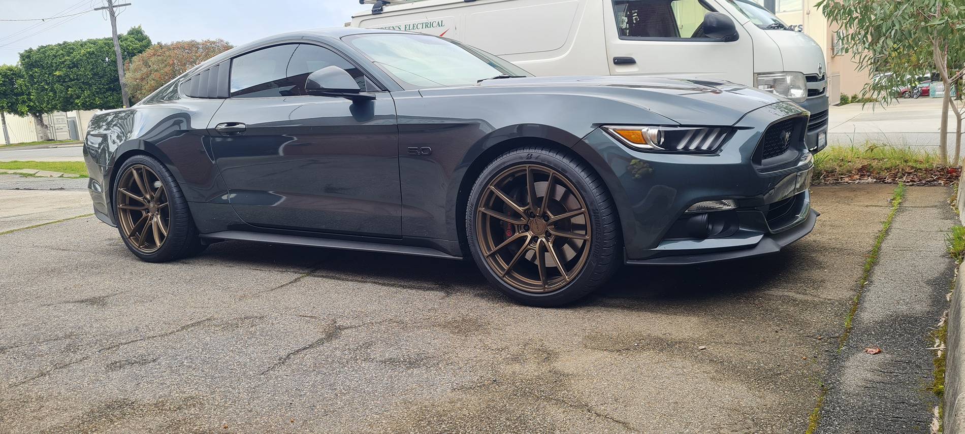

So It has been like year since I have been on this site but since this thread has starter was the perfect time to post my car after just upgrading my rim have had the original rims since 2015, these Velgen VF5 in bronze are fantastic 20x10 front 275/35 and 20x11 rears 305/30
just a quick photo on phone just now
