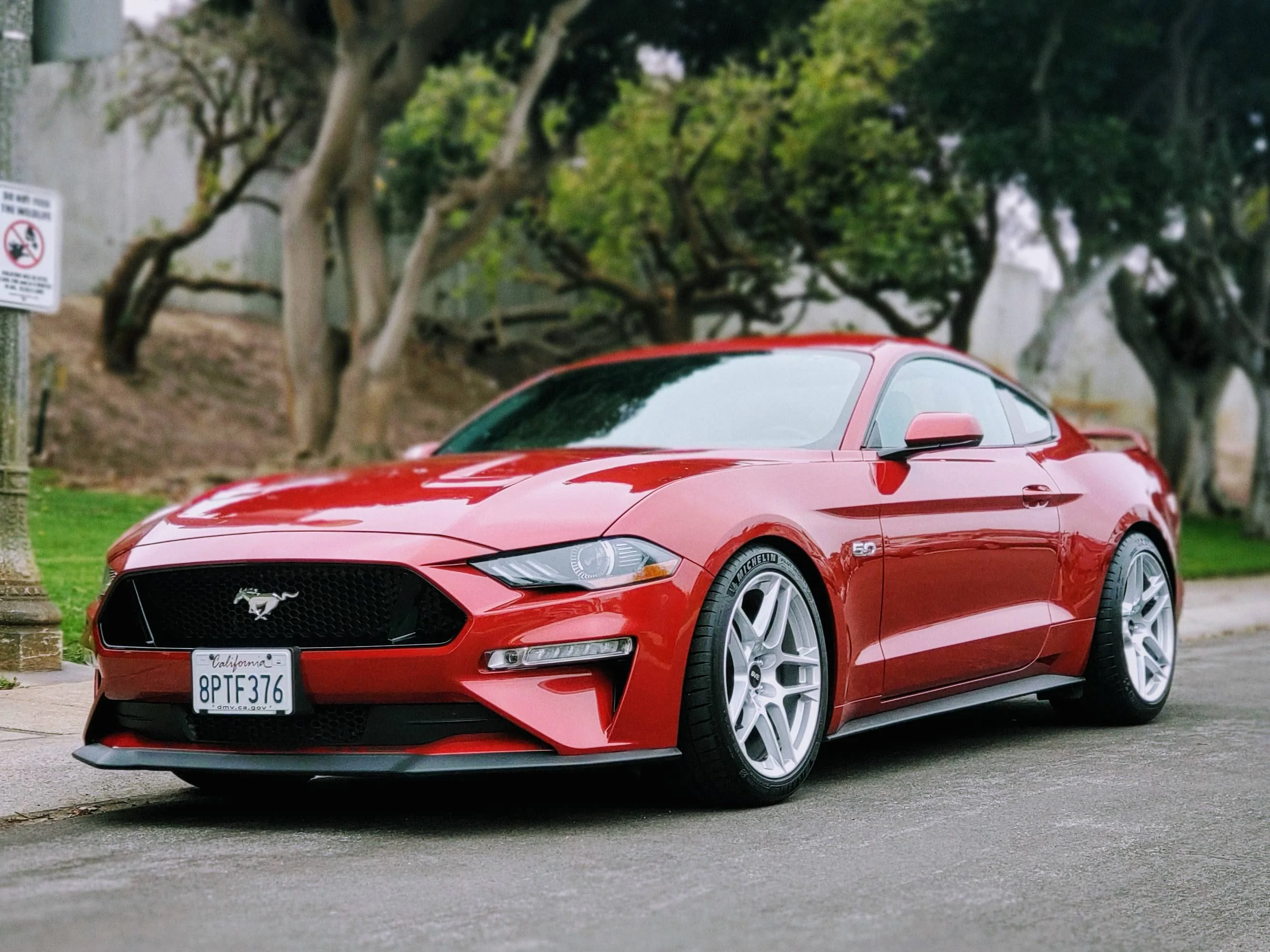

Those aren't even Mustang offsets. A 22mm offset will protrude out by 10mm past the fender of what a 19X11 ET50 wheel. A 19X11 50mm offset wheel on the Mustang is right at the edge of the quarter panel. Your mechanic is wrong. In fact most shops won't even install a 305 on a 9.5" wheel as the minimum is a 10" wide wheel.
Here is my car with 19X10 et35 and 19X11 et50 with 285/35/19 and 305/35/19. These are right at the end of the.
