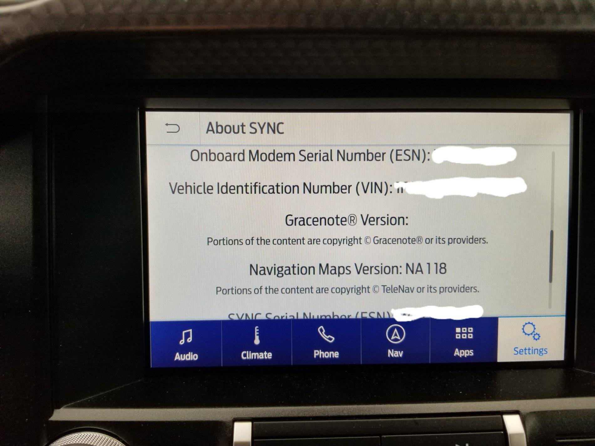

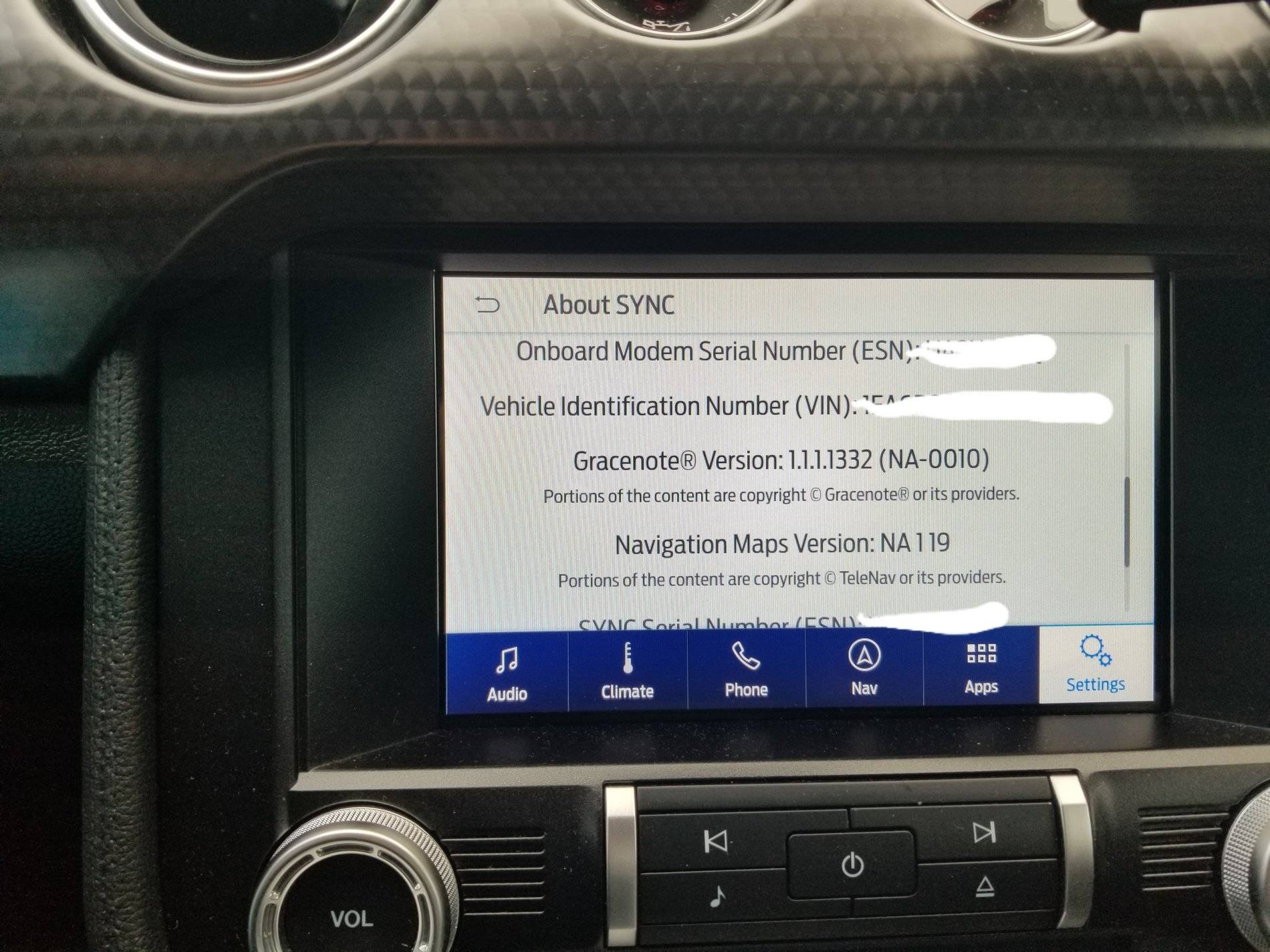

I updated my maps which now it shows NA1.19, I noticed that now there's a version for gracenote.
