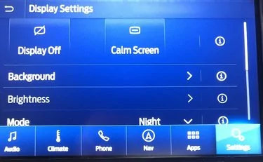

"Ford has launched a new “Calm Screen” in the 2020 Ford Explorer that will help motorists to get away from a world where everyone is frenetically hooked on the latest notifications on their smartphones and other devices. The “Calm Screen” mode is available on the model’s instrument panel display.
When the motorists wants to take a breather, all he needs to do is to select the “Calm Screen” setting and most of the data that is displayed in the main part of the screen will vanish. The only information that will continue to remain on the screen will be those related to the speedometer, the fuel gauge, odometer, temperature and compass direction. The color of the screen will also turn into a soft blue, which is a color scheme that Ford opted for as blue is considered to be “soothing and tranquil” color
This option is similar to the Saab “Night panel” which used to shut off all the interior lights except the one for the speedometer....."

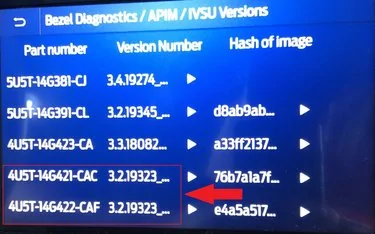

Diagnostics show I have the 1.19 Files; I guess I will make an appointment at the dealer to hopefully update/reset the APIM to get back the Navigation Commands.

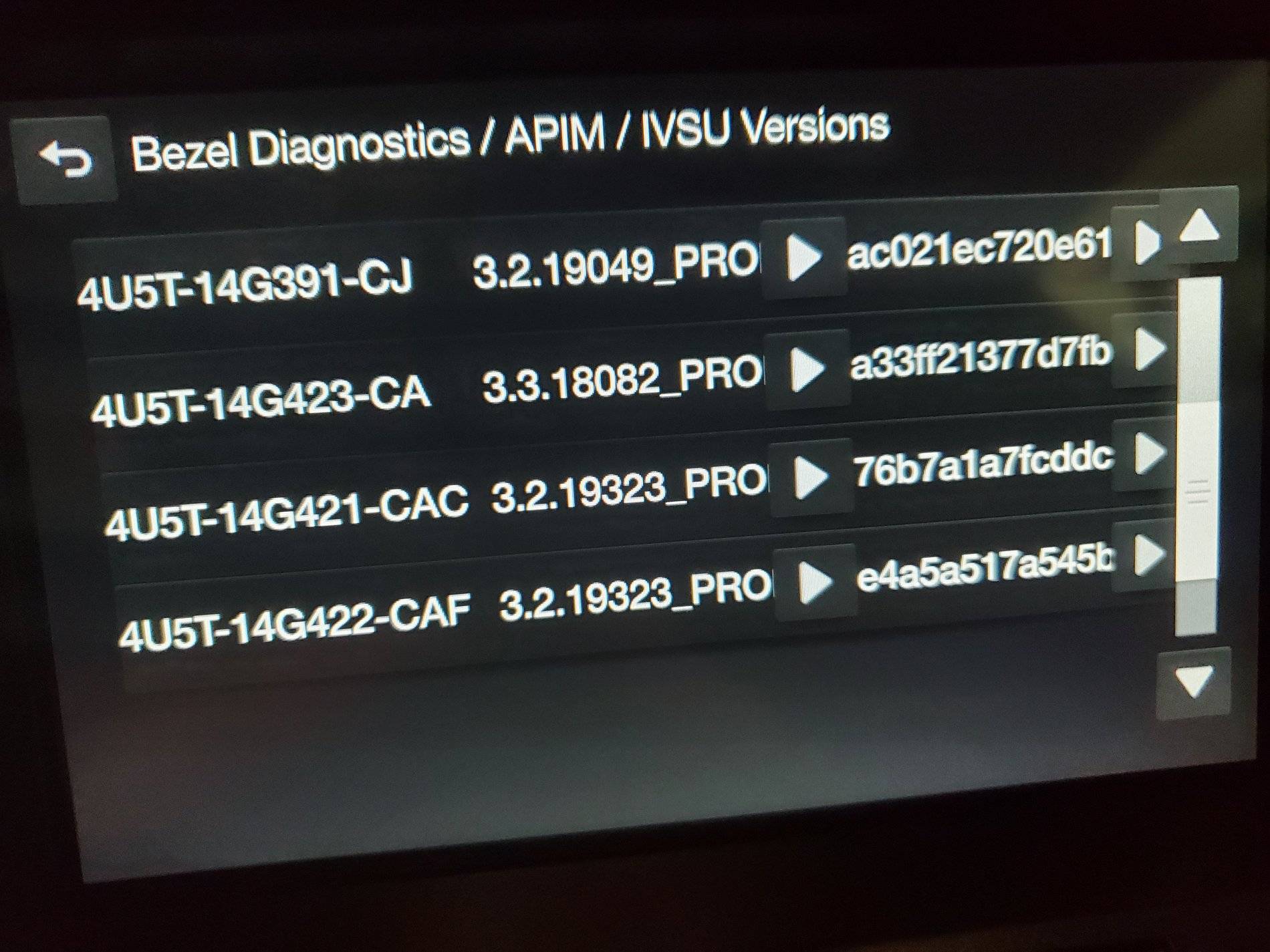

I don't know if anyone has posted this previously but I called Ford Sync Support today about my apparently failed map update despite using the correct license file. Sync's screen indicates it has the 1-19 map version but won't respond to navigation voice commands.
The rep checked the status of my system which means the car had "talked" with Ford's system via my home wifi.
He said the system had installed the maps but needed one more step to finish the process:
Remove any USB's
Start engine and let is run for at least 5 seconds
Turn off engine
Open driver door
Lock driver door using the door lock switch
Close driver door within 3 seconds MAXIMUM of locking the door
Wait at least 2 minutes
Then start the engine.
Navigation voice response and whatever else isn't working "should" work
