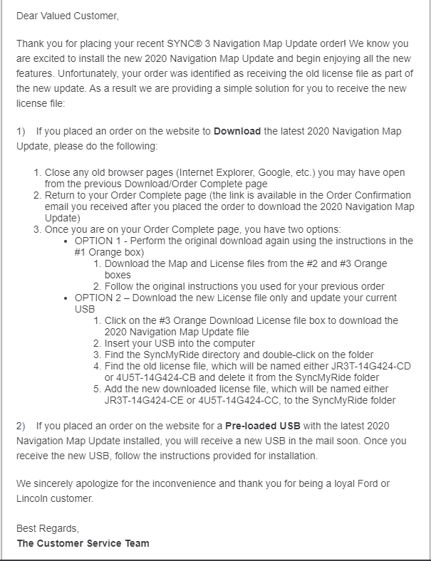

It seems that you get more than one map update as this is the second one I have been able to get as i had gotten one in Jan. I just got the new CC license file (it was CB a few days ago) so I won't know for sure if it updates to 1.19 until I go through the update process. When I updated to 1.18 in Jan, it stayed at 1.17 due to some bug apparently.
1st attempt failed b4 it even started!!.. The headunit did not like my 64G 3.0 USB. Unsupported!. gonna try a 32G 2.0 USB
It works fine with my 3.0 64gb sandisk ultra. I have not performed the actual update as the license file was not correct (CB version). Now that I have the CC version it gets me past the ver_err06 error. Will try to go through the entire update today or tomorrow.

Received an update from Ford on my 1.19 update issue. For anyone receiving err05, this is why:
Thank you for contacting the In-Vehicle Technology Team of Ford Motor Company. We do apologize for the inconvenience you are experiencing with our Ford/Lincoln Product.
I received your escalation regarding the Navigation Map Update Installation Process. There was an issue with our navigation partner ALOM. ALOM will be sending an email advising some steps for correction soon. This affected consumers who previously ordered map update NA1.18. If you did not order that update, please let me know and we’ll see what could be causing the concern.
But in the meantime, here is some information that can help correct the issue you are having. If you’re not sure of the information below, ALOM will have more information out to you soon.
  1. Download consumers impacted: Consumers who placed orders for the NA1.19 Map update between 6/30 – 7/7 using the download option at the syncnavigation website can do the following:
    1. First – please close any old browser pages (IE, Google, etc.) from the previous Map download/Order Complete page as a precaution
    2. The user can then return (click on the link) to their Order Complete page where they originally downloaded the most recent Map & License update files (the link is available in the Order Confirmation email they received when their order was placed for the NA1.19 Map download update)
    3. Once on their Order Complete page, they can click on the #3 Orange Download License file box and the new NA1.19 license file will be downloaded
    4. The customer will place this file in the SyncMyRide Folder of the USB drive obtaining the map update.
    5. The Consumer will then remove the incorrect license file which file name(s) could be the following: JR3T-14G424-CD.TAR.GZ – 4U5T-14G424-CB.TAR.GZ (also the files may not have the TAR.GZ on the end).
  2. USB Consumers impacted: ALOM will ship new USB order to these consumers with the corrected NA1.19 Map Update and license files
Please let me know if you have any questions by replying to this email or contacting a representative by phone. If contacting by phone, please provide the case number in the subject line of this email.

Hi Jonathon. It's getting really hard to keep track of all the posts on two different thread, but this was posted the other day. This addresses the license error but still does not rectify why 1.19 still doesn't show up for owners with 3.3

Meh, just got this from ALOM Sync 3.
