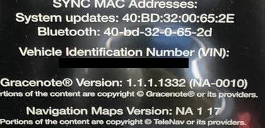

My "about " screen was displaying NA 117 even after updating to NA 118 last year

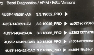

The IVSU screen showed this...

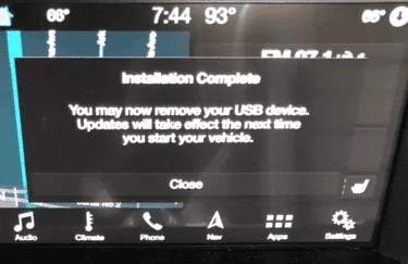

Once the USB was inserted, this came up and remained on screen throughout...
The system rebooted 3 times without any intervention on my part. this message came up for a few seconds each time...

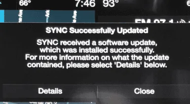

The last time this came up and remained on screen until I turned the car off...
Ended with this...
Notice the change in file names for the last two..

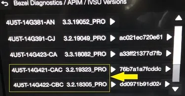

If remember @UofMEngineer reported the 14G421 file was the map file and 14G422 was voice command.
That thread is Has anyone with Sync3 Nav successfully updated their maps?
Also, I can confirm voice command is working
