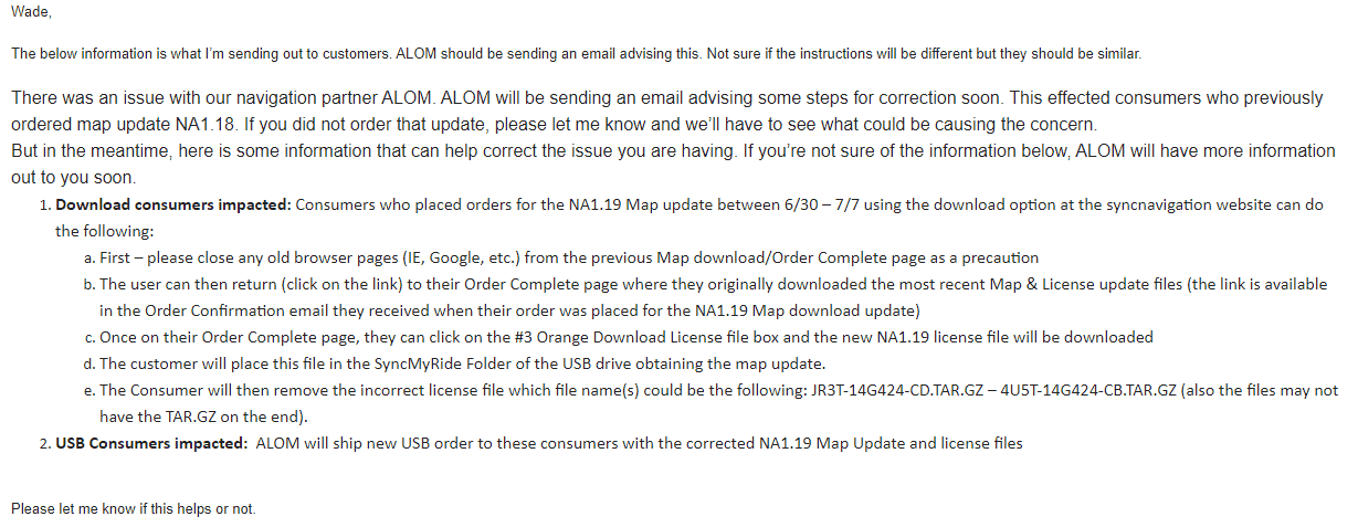

just an FYI, those that are redownloading their files looks like thats a smart move, i just got this email from support after i contacted them about verifying i did indeed have 1.19 files and not downloaded and installed 1.18 again.
so, take that for what its worth, if i get new/updated info, i'll update here also
EDIT: so i sent a reply back with the filenames of each and every file in my map update (syn32.zip) and listed the file name of my license file.. all of which can be found in the screenshot in this post: https://www.mustang6g.com/forums/th...-update-june-29th.143298/page-21#post-2954499
the support agent i spoke with assured me that those files are indeed the 1.19 files, and that my license file is also correct (4U5T-14G424-CC.tar.gz), and that if i were to install those files, i would be running the 1.19 version of maps.
when i responded and said that is the version i installed but the version number in the "About SYNC" screen had not changed, the agent then mentioned the bug that @Bikeman315 has been talking about. in SYNC 3 3.3 (and only 3.3) there is a bug where it will not list the map version OR gracenote version correctly. however it will be fixed in the next version of SYNC.
they didnt tell me what the next version number was (assuming 3.4), however they did say that they are currently working on it, and COVID-19 has held up the release because all the engineers are still working remotely.
so there is still hope out there for a 3.4 release... soon™️

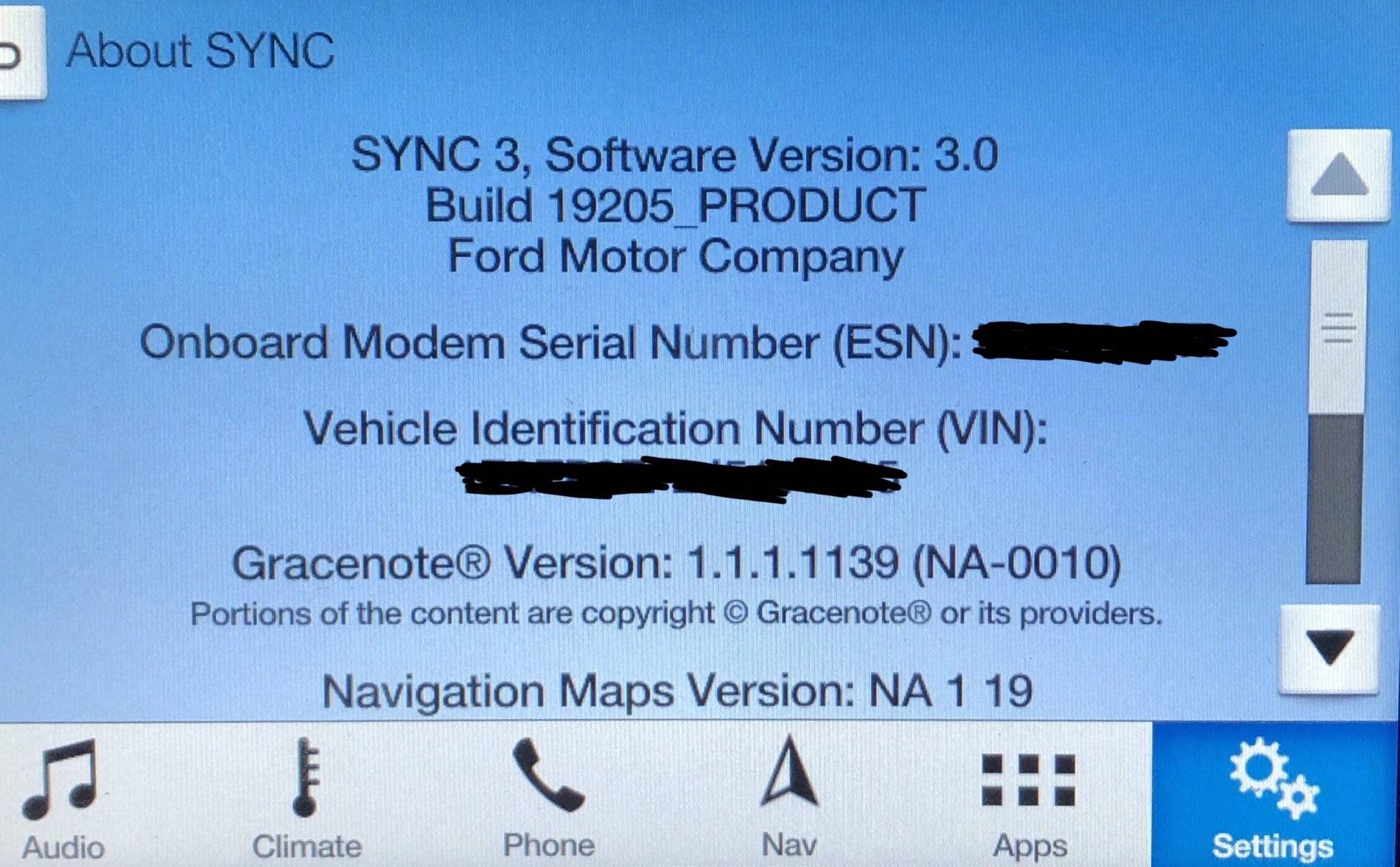

Just another proof of concept, sync 3.0,Nav update to 1.19
20200708_121624 by chefjpd, on Flickr

I just got this email from support after i contacted them about verifying i did indeed have 1.19 files and not downloaded and installed 1.18 again.
Hey, didn't really understand those instructions, but at any rate, I deleted the confirmation email after a successful installation, deleted the downloaded files, and also deleted the USB contents to put something else. So what the hell am I supposed to do? And should I do anything? My voice commands are working perfectly... although I rarely use them. I was one of the first to call customer support (they didn't know anything), but I never received any emails. Wonder if I should just tell them to give me an extra free upgrade, and leave it alone? Suggestions welcome :D.
