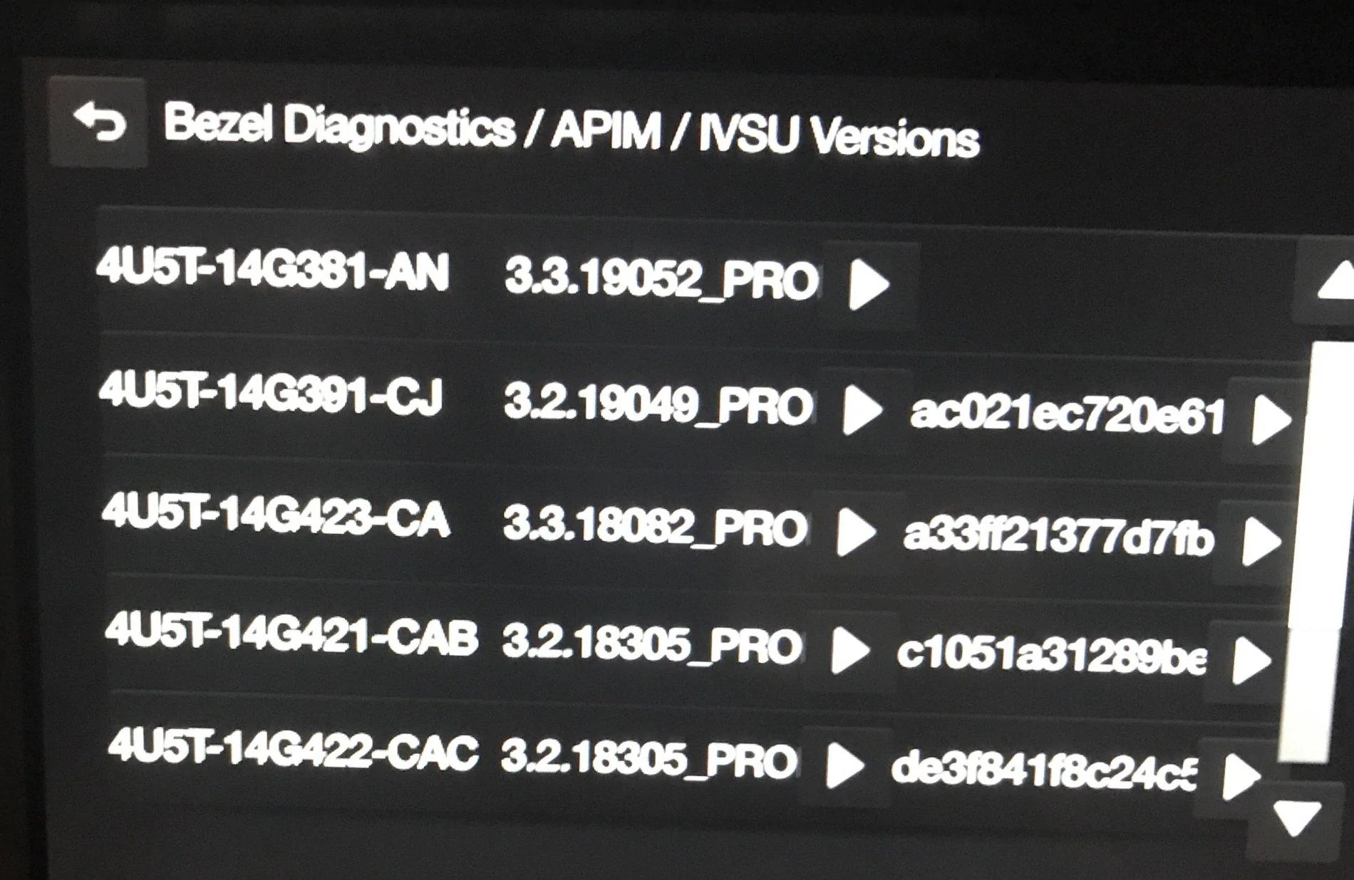

Thank You!. BTW, which one is the corresponding updated map version displayed on that page?
14G421 is the map. It's chunked so the x in -CxB will differe based on which chunk you're in.
14G422 is the voice nav data. Also chunked. -CAC in NA English.
