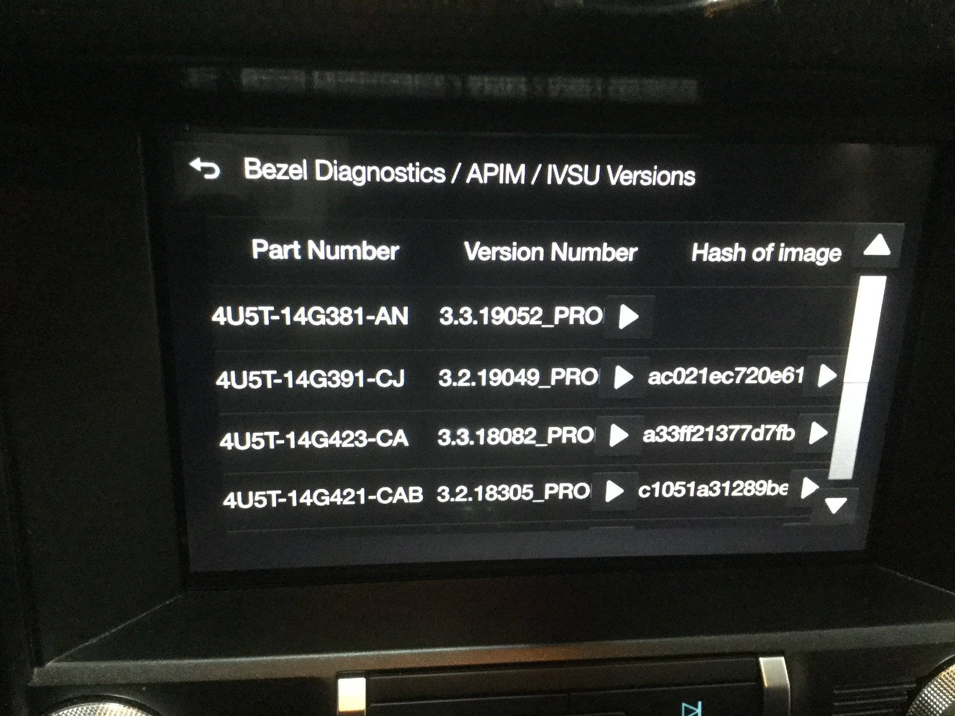

but before i get too far ahead of myself.. i still need to see that screenshot of "NA1 19" on the 'about sync' screen from someone before im convinced i dont have 1.19 already and just not showing..
you mentioned a couple other times previously about "diagnostic bezel mode" or something and you can see what version you have? how would i do this? got a link or some more info?
edit: nevermind i think i found it..
https://www.mustang6g.com/forums/threads/how-to-enter-into-“bezel-diagnostics”-mode.119109/
i guess i'd be looking under "APIM Diagnostics > Software Versions"?

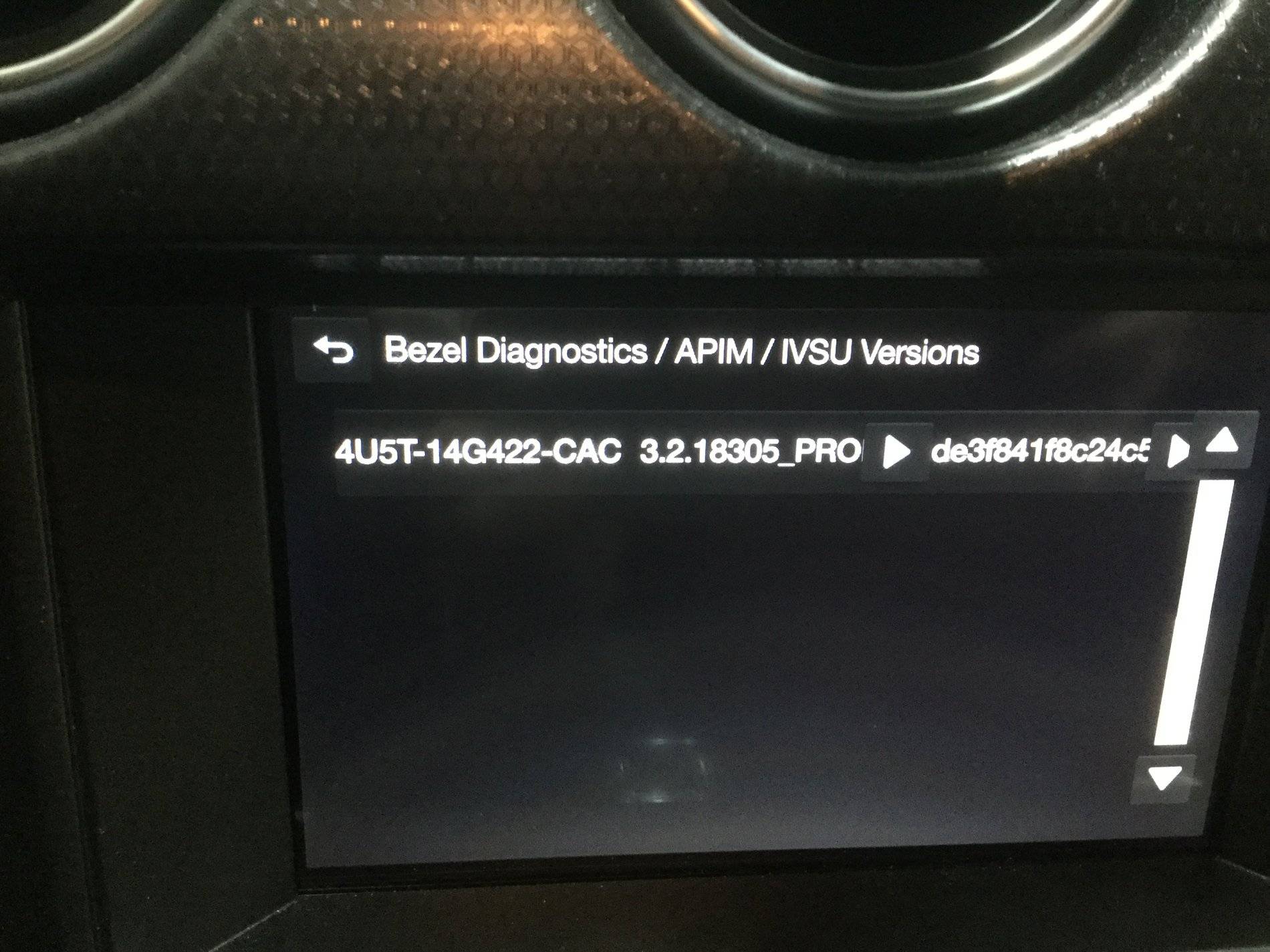

You got it. Here are the screens I got after upgrading from 1.17 to 1.18. Honestly these look like Sync update files but Ford told me I had 1.18 so who knows.

^^^ I would say just use the "About Sync" Screen. It will show which update is "supposedly" loaded.
But that was the whole point. 3.3 had a bug that showed 1.17 whether you had it or 1.18. I was told, by Ford, the only way to tell was through Bezel Diagnostics. Who knows what 3.3 shows for 1.19
