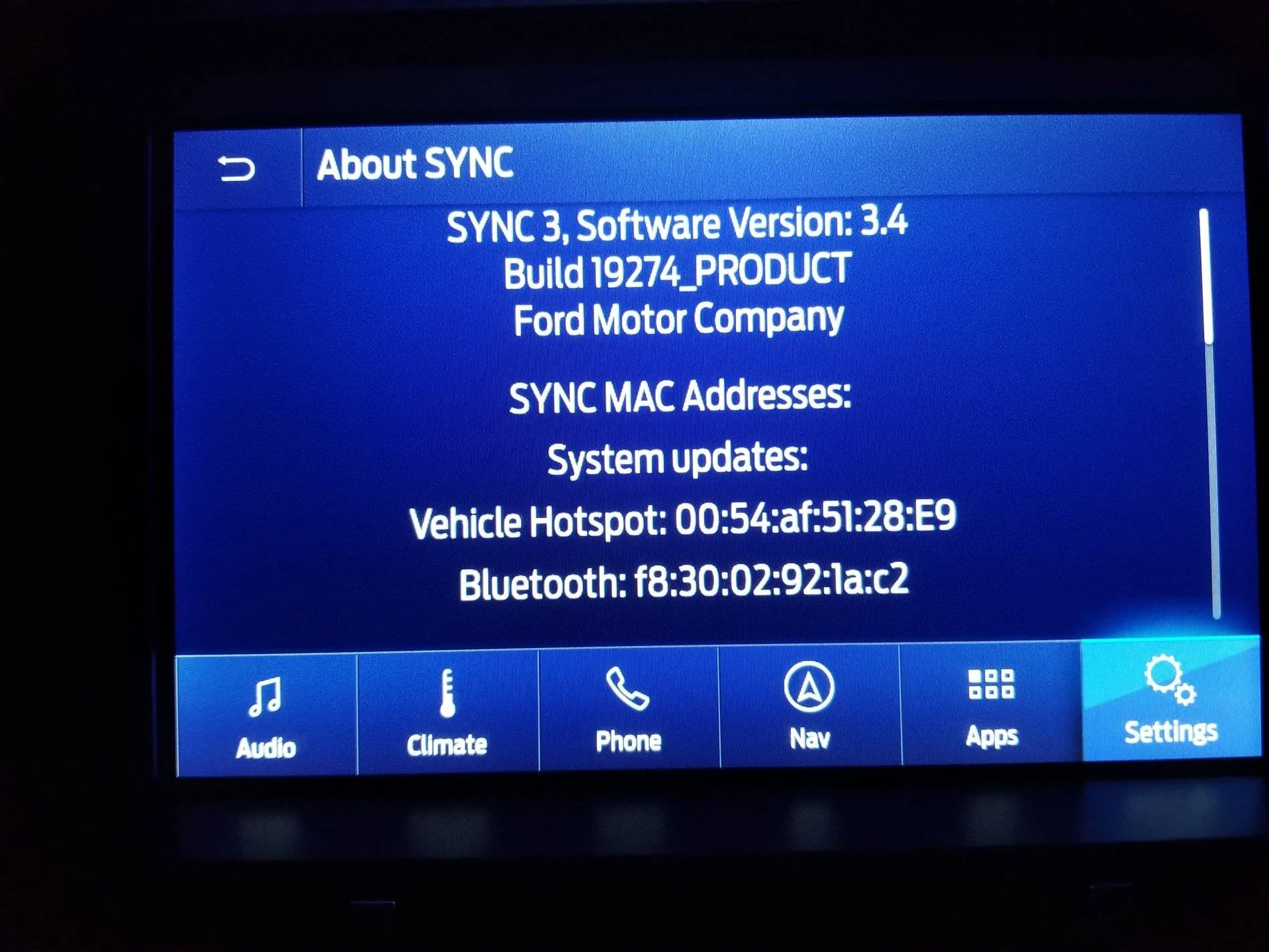

Check your “about sync” screen. You should have version 3.3 build # 19052. If you need to update go to the Ford Owner site. For nav you most likely have 1.17 although I guess you could have 1.18 depending on when your car was built. Either way 1.19 is the latest that everyone seems to be having and issue with. At this point I would hold off until we get this sorted out. Kind of the norm for Ford updates.

Sonofagun. They updated the license file to version CE and it works now. Thanks to M6G, but no thanks to Ford.

Drove around.for an hour and now have both Nav and software updated.

Woo-hoo!!! Success! NA 1 19. Took about 45-50 minutes
You're the first to claim 1.19; that's weird, but maybe Ford fixed whatever the issue was. Hey, you didn't specify if your own USB or Ford's $40 one; please let us know. If Ford fixed the problem, wonder how are they going to fix it for us. Hmmm.
