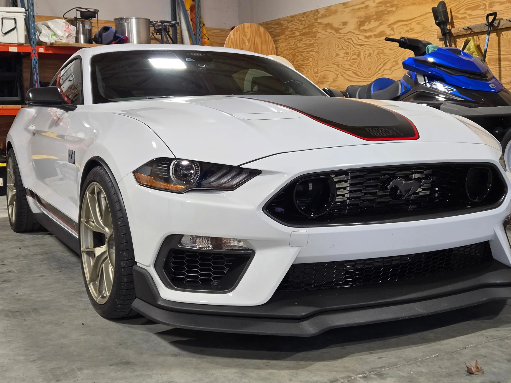

Hello to all on here and greetings from Hot Springs National Park.
Looking forward to sharing what I've learned and getting some of my questions answered.
Had my 21 Mach1 since new and I gotta say what a fun car it is.
At 13k miles had a ProCharger stage 2 kit installed. Now at almost 30k and loving every mile.
Thanks for having me friends.
