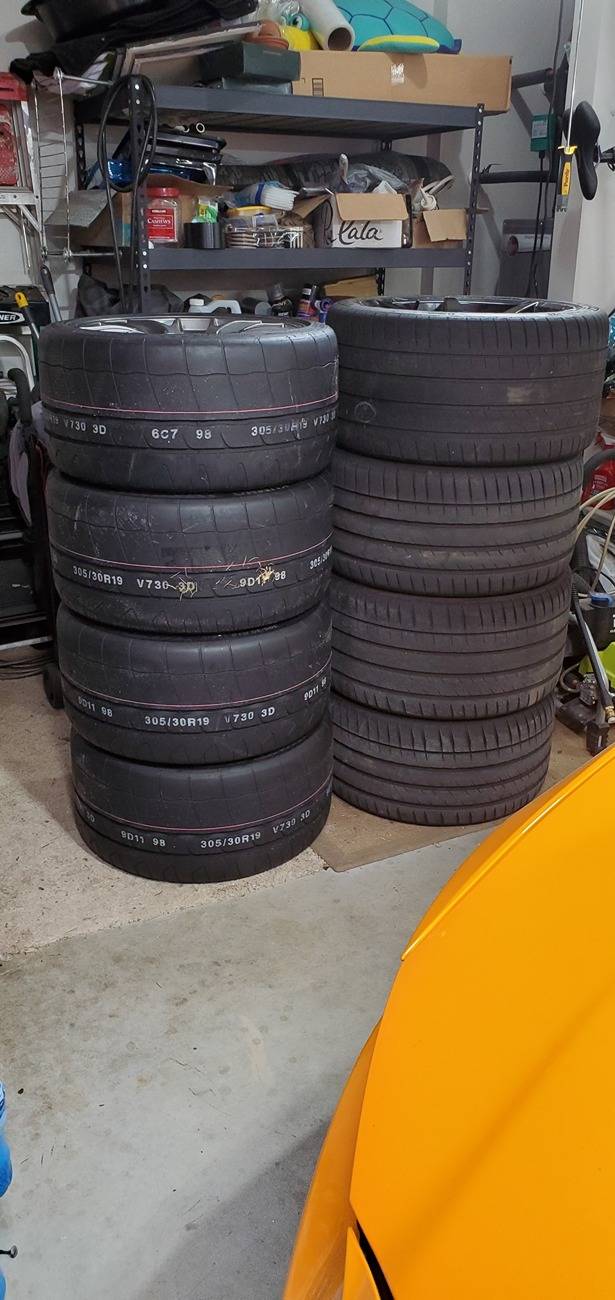

Agreed. I Atilla have a leftover set in my garage and even halfway through the season people looking at the outside tire edge thought I was on slicks. As you can see they're not even to the wear indicators. This was about 16 autocross events total I believe between a couple organizations and a year and a half in time. Obviously got very sketchy to drive to events on these tires as any moisture was a bad situation. They did eventually fall off on time but still stayed very grippy and never needed sprayed with cooling water like the Yokohamas do.

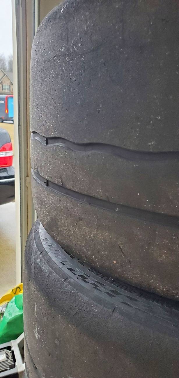

I'm not a track person but couldn't you adjust the camber/toe to even the wear on the one tire? Just wondering

They're worn perfectly. The outer treadblocks are molded shallower so they wear smooth. You can see them on the left when brand new here. One of the reasons I wouldn't recommend them for daily use at all.
