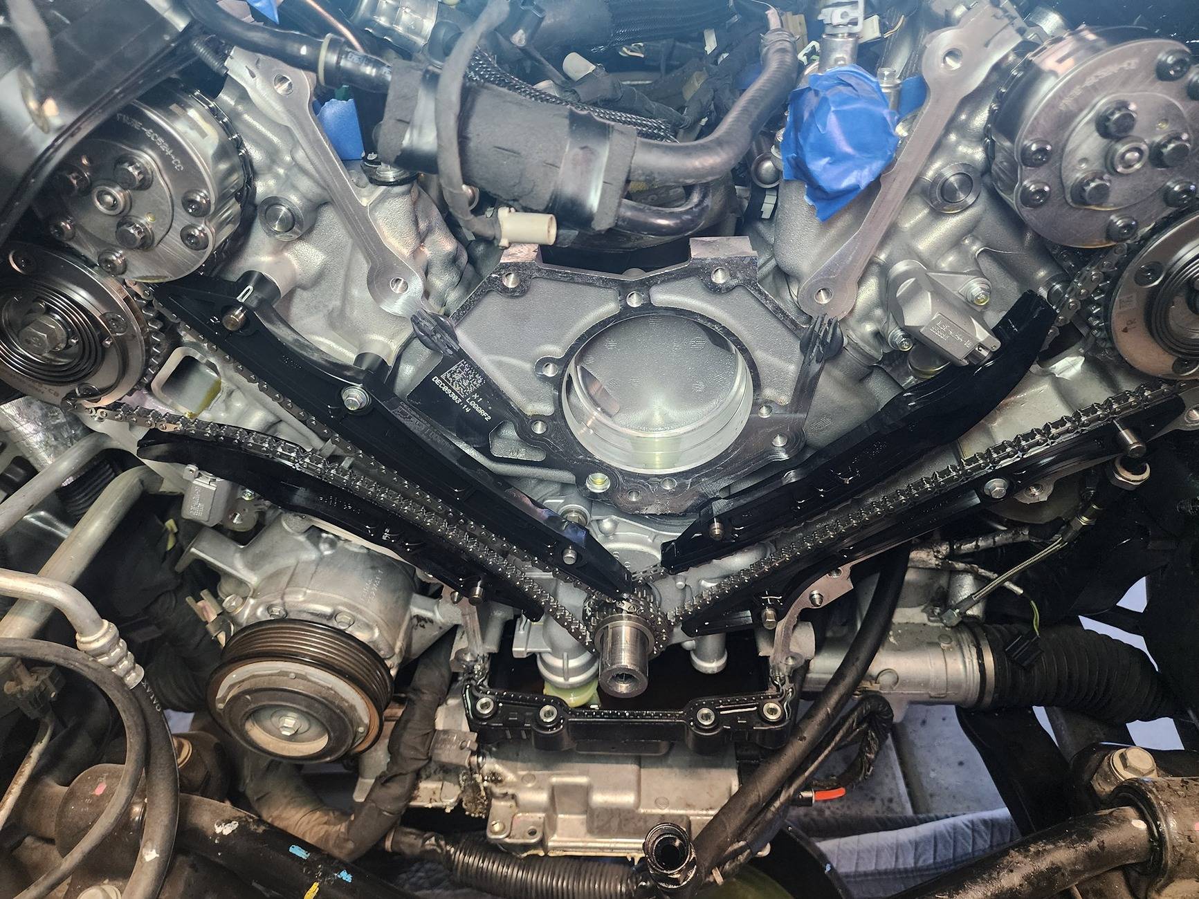

Anyone see anything unusual? Finally started opening everything up and didn't find anything sticking out. Pumped oil through the engine and flow looks good at this point, it was consistent everywhere. I'm going to pull the chains and gears tomorrow and scope everything as much as possible but so far I can't find an issue. Anyone have any other ideas? Right now I'm open to anything! Lol
I think the short block is just defective with an enormous clearance(s) somewhere there shouldn't be one. If you work backwards far enough and don't see anything that you did wrong there isn't much else it could be. In a post covid world new doesn't mean good unfortunately.
Maybe try plastigauge on a few rod bearings and mains if you can to see if they're in spec

Yeah unfortunately quality was going down before covid but that sure did excellerate things. If I don't find any blockages once the gears are out I think I'm going to assume it's bad gears for now and throw a new set in there and see what happens. If I still have low oil pressure at that point I'll have to pull the engine and do a tear down but for now I'll assume ford has built enough coyotes that hopefully they got that much right and it's just defective gears.
