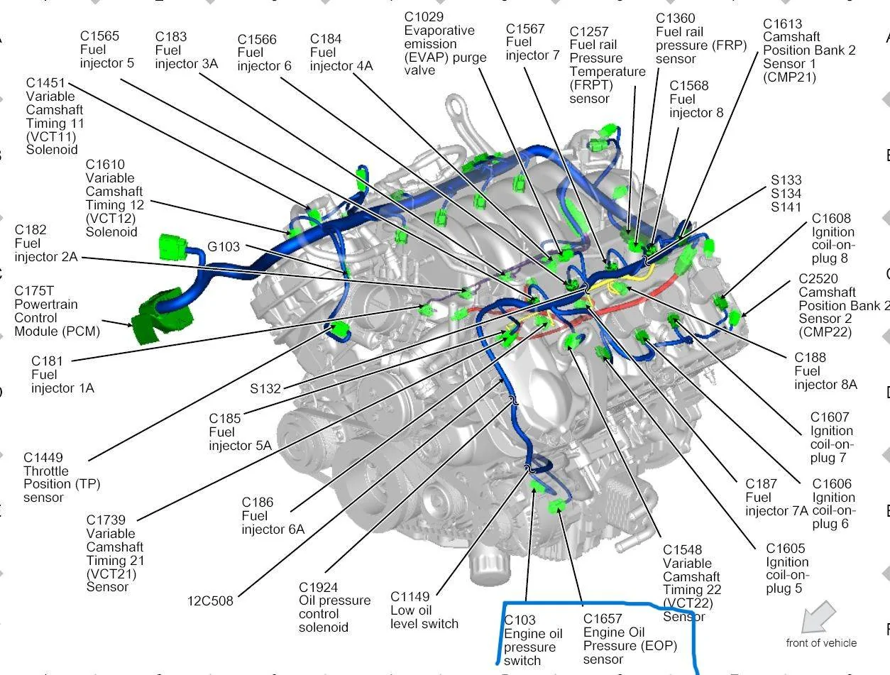

MuddyPaws
Mar 11, 2020
35
30
United States
2019 Bullitt
There is one pressure sensor and one pressure switch. The pressure switch should activate the low pressure warning light. You can show good pressure through the pressure sensor and a bad pressure switch can activate the low pressure warning light.
