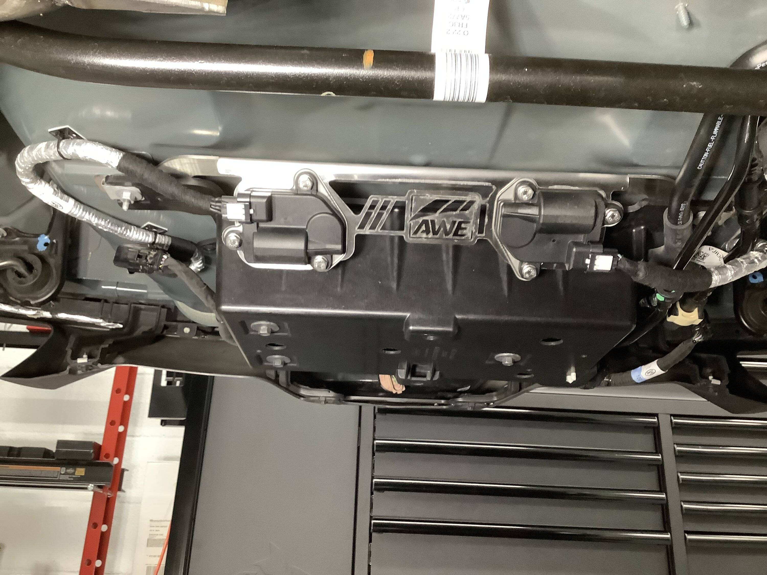

Maybe consider some Dynamax mufflers for a quieter exhaust note. If you want to retain your AE feature with them, you can have the AE portion of your factory exhaust carefully cut off and welded onto the Dynomax mufflers. Otherwise, you’re going to be louder and you’ll also lose AE as others have said.
https://www.dynomax.com/exhaust-sys...k-system-ultra-flo-welded-mufflers-39533.html
I gave up my AE for a Steeda axle back on my Bullitt and I put the actuators in a bracket to keep the exhaust malfunction light off on the dash. Not sure how the Steeda axle back will sound with the AE welded into it, but it would certainly be easier on the wallet and toned down with the different exhaust modes from mild to wild.
