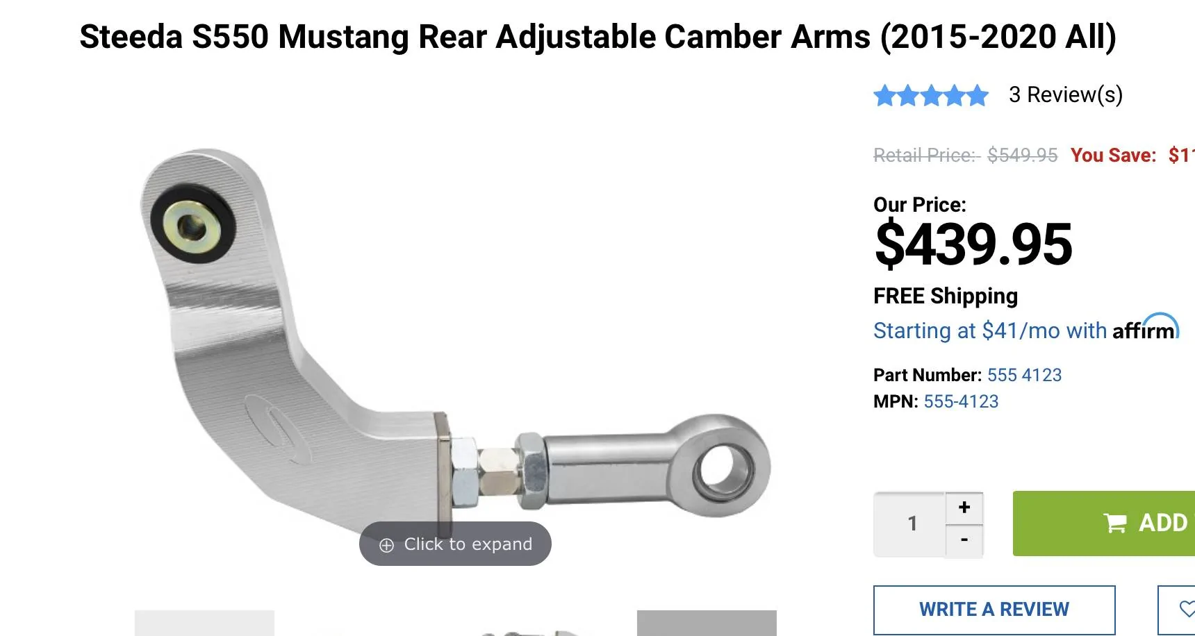

I had the Steeda adjustable arm in my last car, and it did work great. The only complaint I had is it’s a pain in the ass to get at the lock nut n the adjustment nut with wrenches because there is not a lot of room.
I will say the act of adjusting camber works perfectly, it was however a pain to do. Definitely not as much of a pain as the factory adjustment though.
I am a big Steeda fan, and have been their customer for almost 30 years. I always prefer her to buy their products. That said, I have never used the BMR piece.

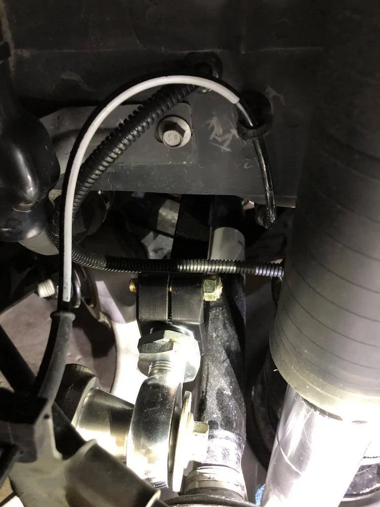

Do you also not have to secure the 'old' adjustment somehow? With something like this?
The Steeda adjustable arm does not do anything with the original top bolt. Does that come with the BMR adjustable arm, or is that a standalone piece, and who makes it? Being read I assume it is a BMR part?

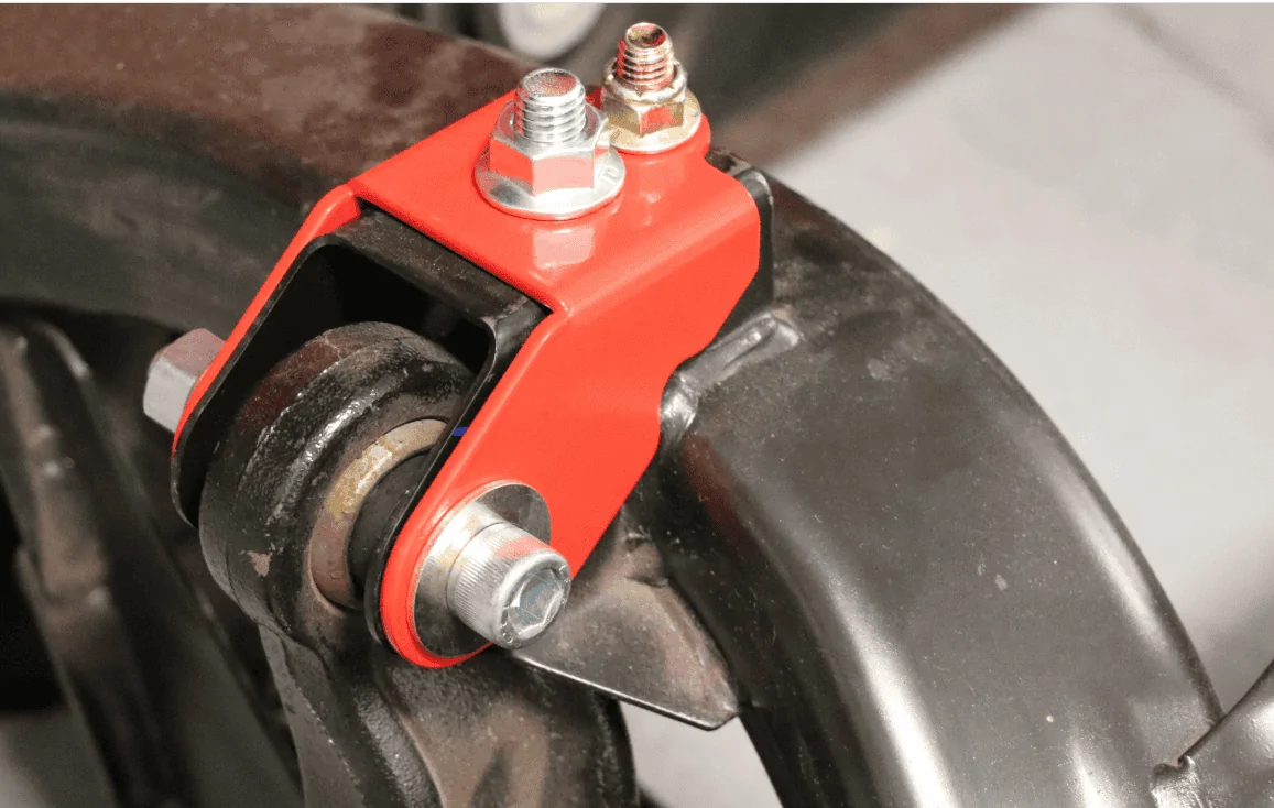

Its another BMR standalone piece that cost another $60. Honestly both arms should come with something like that. The BMR peice has 2 notches to lock in depending if you want more or less camber, basically pre-setting some camber.

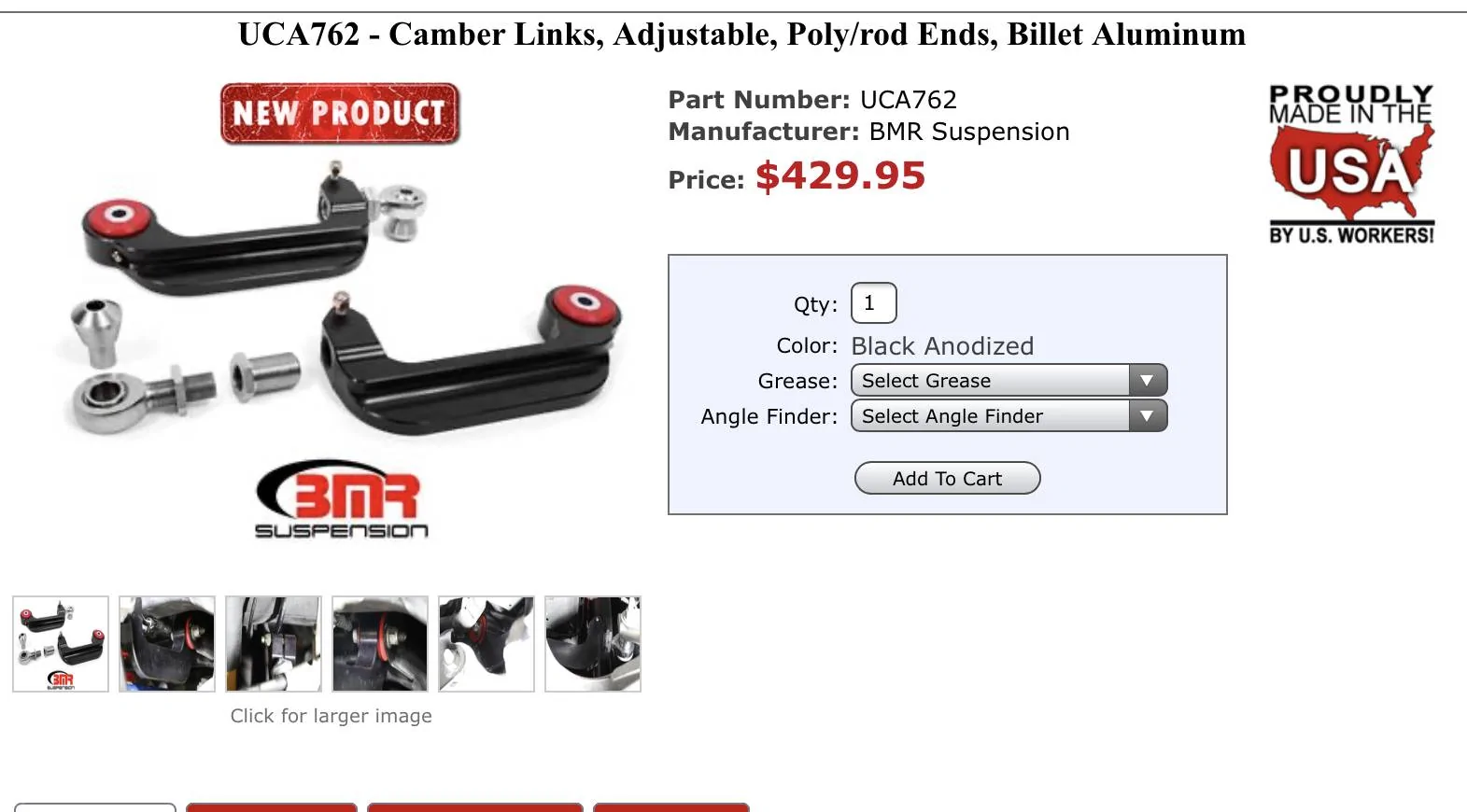

I went with the BMR adjustable camber link and the additional camber lock out kit. Camber link is in the car but my fat hands and arthritis made my mind decide installing the lock out kit was better left for another day. Like the Steeda version the jam nuts are tricky to get at with a pair of 1-1/4 wrenches.

Nope sorry for messing in the big boys thread. I would buy the BMR adjustable camber arms again quality in my view is excellent. No fitment issues on a lowly GT Premium bagged with Viking Crusaders.
