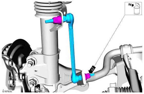

From the 2020 Factory Service Manual.
Remove and discard the 2 front stabilizer bar link nuts and remove the front stabilizer bar link.
Torque: 85 lb.ft (115 Nm)
Thanks Snoopy. I have the shop manual and used it for reference.

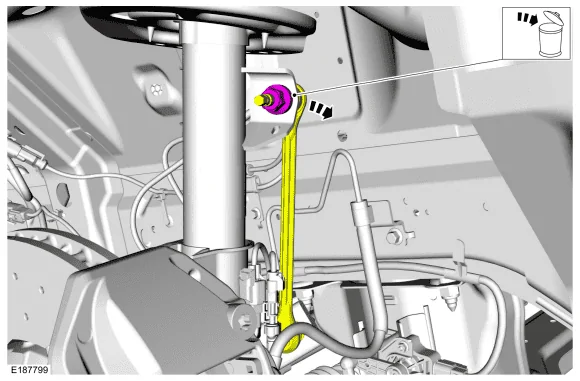

The dummy put the end link on the wrong side of the brake line when he reinstalled the strut. The 2 open oval holes on the bracket are where the magnaride wires go held in by christmas trees. He probably broke them when pulling it apart.
The
Magnaride cables are on the other side.

Problem has been fixed. Removed the upper nut on the vertical link and disconnected the fender brake line bracket. There was just enough room to tuck the link under the brake line and back into proper position.
