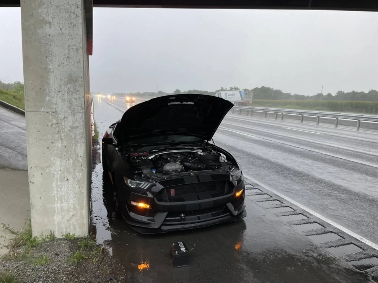

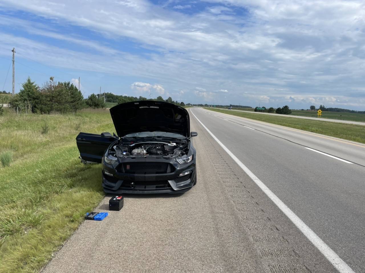

I got the service charging system annunciation, and as the voltage dropped slowly, electronics started shutting off.
I ended up charging my battery, buying two spare batteries, and drove the 4 hrs home with no alternator (changing batteries along the way.) Stock battery gives you about 1:15 of run time with everything off, and the larger batteries I bought with more amps last 1:30-1:40
FYI, I can tell you definitively that the screens shut off at 9.6 volts, and the car shuts down about 30 seconds after that.
