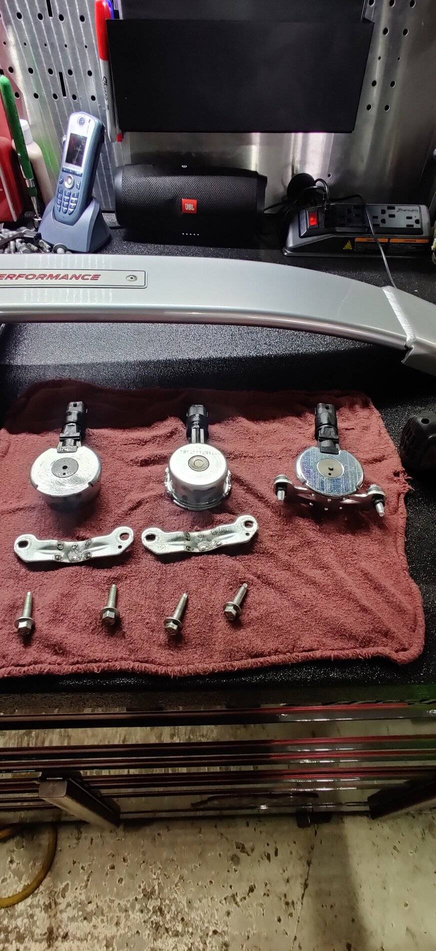

Sorry, I should have been more clear. The pic is from when the dealership was replacing the vct sensors/solenoids at my last visit.
This car is under warranty…. I’m not tearing it apart to diagnose, believe me.
