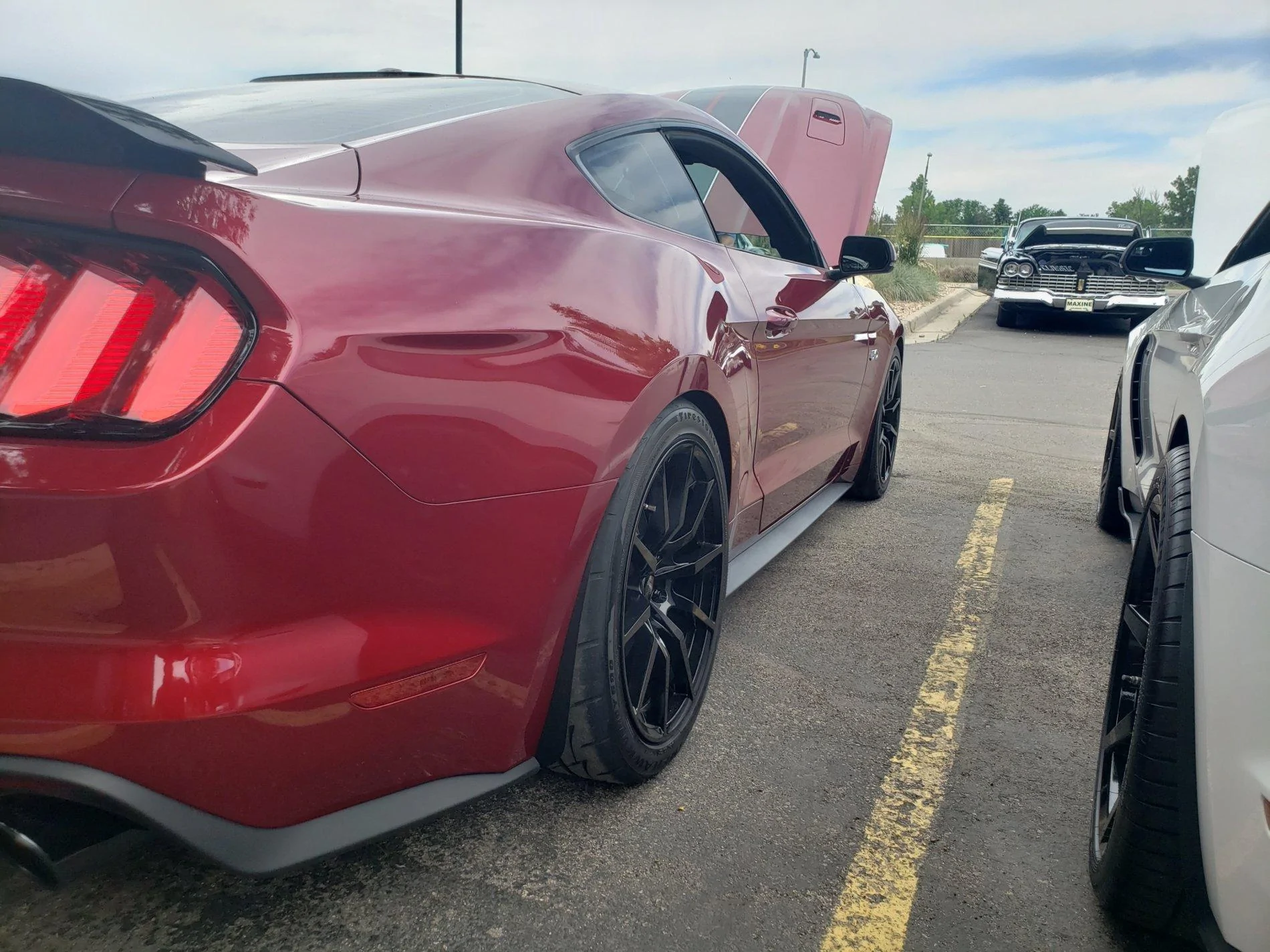

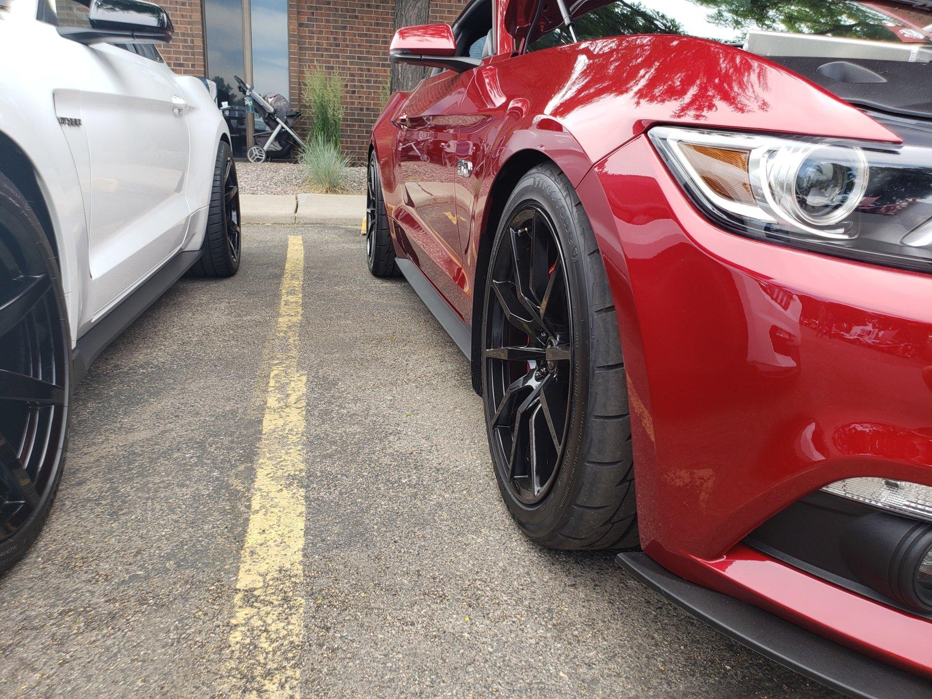

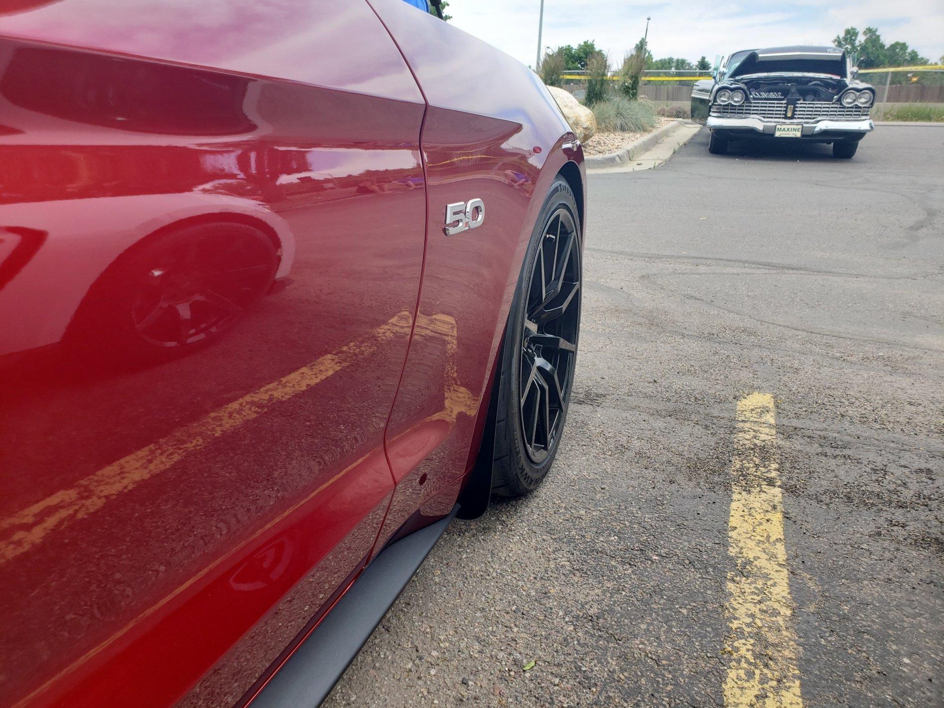

A couple of shots with 19x10 square fitted with 285/35/19 , 40mm offset on the Ruby Red. The GT350 next to me is running an 11.5 wheel with 325/30/19, 55mm offset on the rear and 11's on the front with 305's. Definitely get the poke on the rear ones.

I like how those stay inside the fender lip. 5mm difference in offset from what I've been eyeing.
Your stance with those actually look perfect. Are you on stock ride height or lowered? Is 40mm offset the sweet spot to run 19x10 squared? I'm taking it you have no issues rubbing or tires hitting fender?
