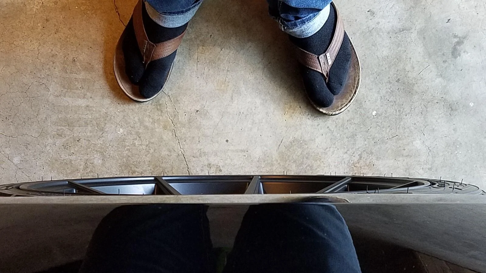

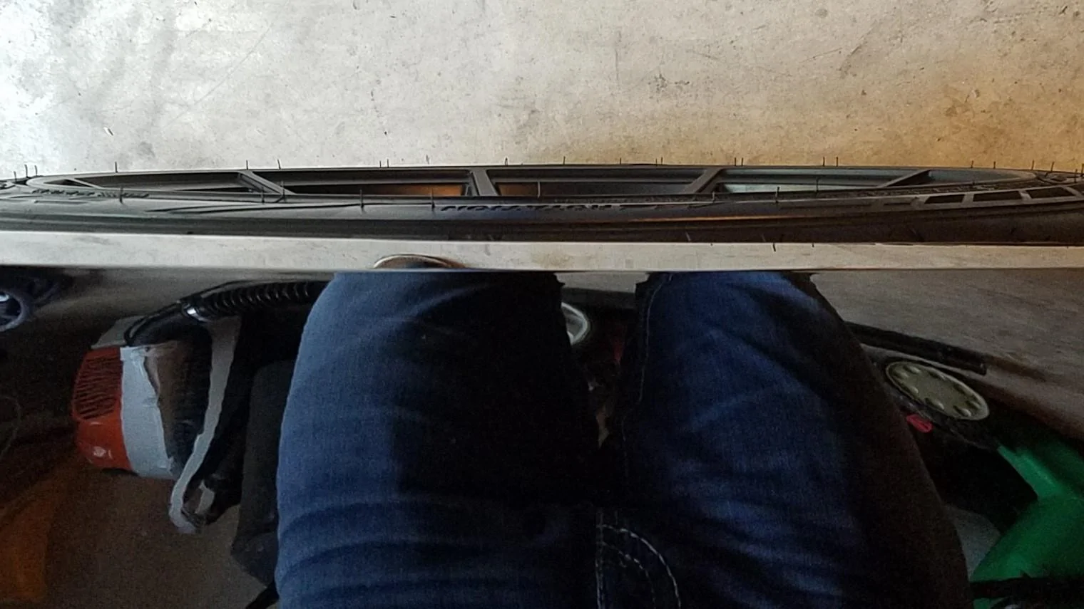

Thanks for the responses. One last question...the driver side rear wheel sticks out further than the passenger side. Photos below. Any idea what is causing this? I want to be able to have everything corrected at the same time. I did not notice this prior to the alignment. Don't hate on the flip flops and socks!

Subframe is misaligned with the body from the factory. Mine sticks out more on the passenger rear. Basically, loosen 4 blue subframe bolts and use a prybar to visually align the subframe to the body of the car. Then retighten the bolts. Then go on the alignment rack again.
This is why it's happening.
Get the Steeda alignment pins and/or BMR CB005 cradle lockout kit (which has significant performance benefits by removing most of the subframe movement) to make sure the subframe is aligned. Just shifting it over without anything to center it can make it off square, and result in odd behavior.
This is "normal"
Even with both of those installed, my RR wheel is closer to the fender than the other.

As for your rear IRS being off center, my car did the same thing when I lowered it. Steeda alignment pins solved that entirely. I added the IRS bushing supports to shore that soft rubber thing up and eventually a zillion other things but the alignment pins and the IRS bushing supports is where it's at for a budget mod without altering the factory IRS forward bracing. Get the Steeda IRS braces for the trifecta if you want to go that extra step toward improving handing. But if it's a street car and you don't want to risking adding really any NVH, Steeda alignment pins and IRS bushing supports. Bada bing, bada boom.
