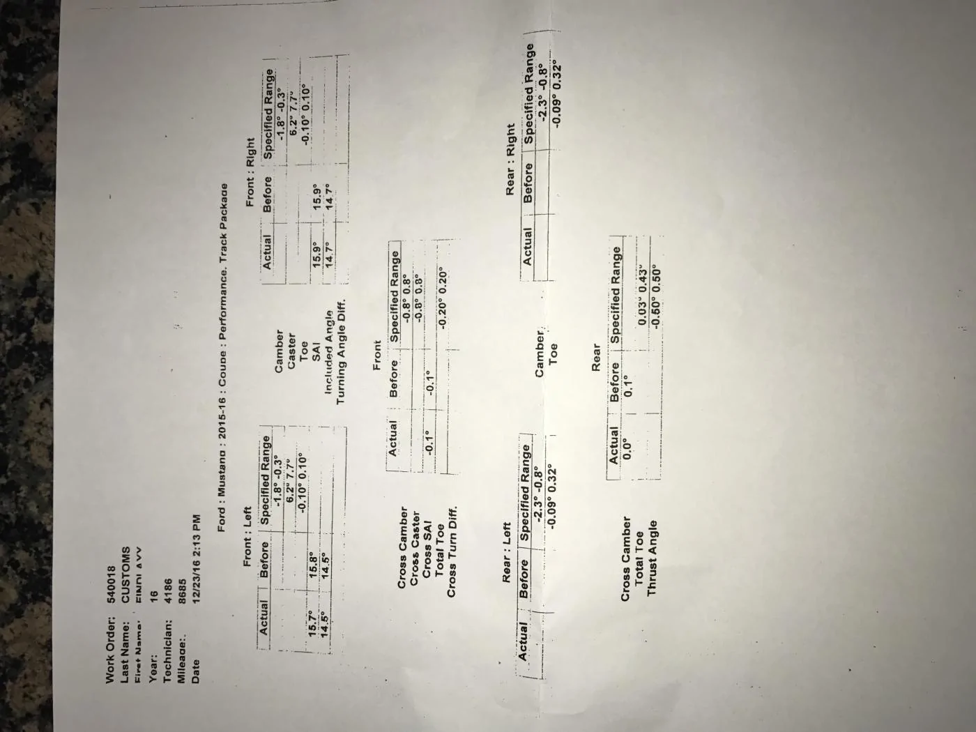

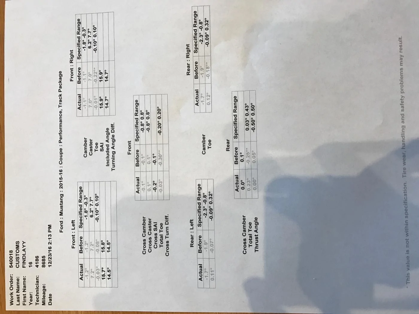

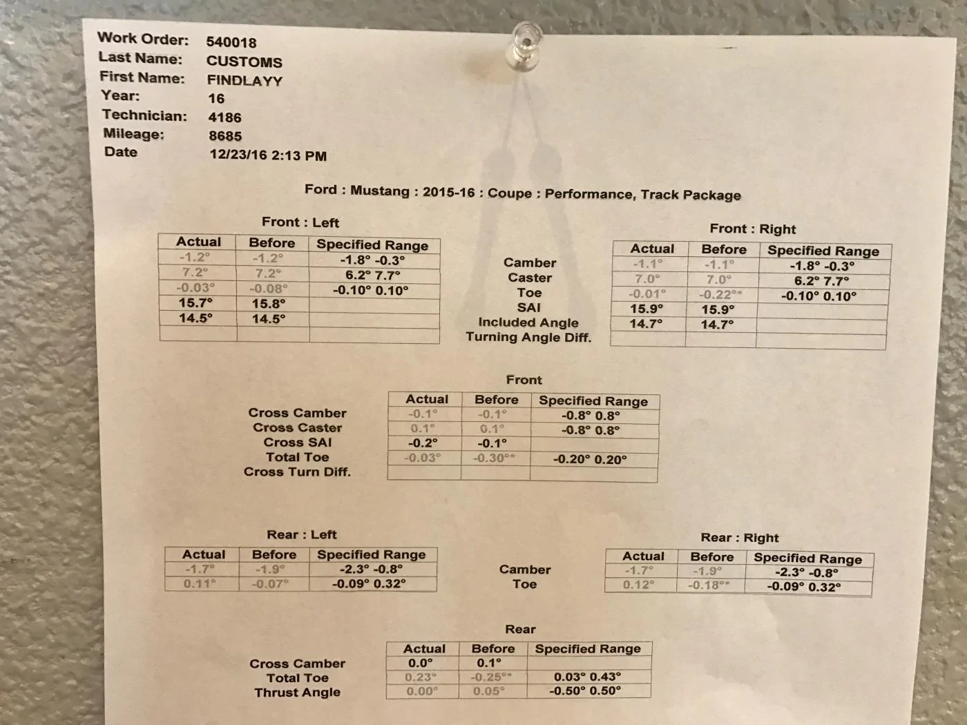

I disagree on your assessment. toe in in the rear is used to increase power out stability. For speed, you should run as little as you feel comfortable with. If the back end is twitchy coming out of corners, you can use more toe in to help. In the front, I didn't center the steering wheel. That's why the measurements don't match. I wasn't doing an alignment, just a quick check. Total toe is what I was looking at.
Do you work in a shop? Have you done an alignment?
Oops, I flipped the signs - my bad. Your total front looks perfect but why go through the trouble without centering your steering wheel?
We agree.
Edit - I've edited my response to OP as he's actually running front toe out which I would not do for a street car.

Everything looks great except the front toe.
I do not like toe out. Toe it in a touch....as mentioned (I think) in the posts above.
For a streetcar with SP080 springs I usually do:
FRONT
.03 - .05 toe per side, total toe to not exceed .10
REAR
.12 - .15 toe per side, total toe to not exceed .30
Saw your message pop up, haven't checked it - but hope that helps whoever is reading!

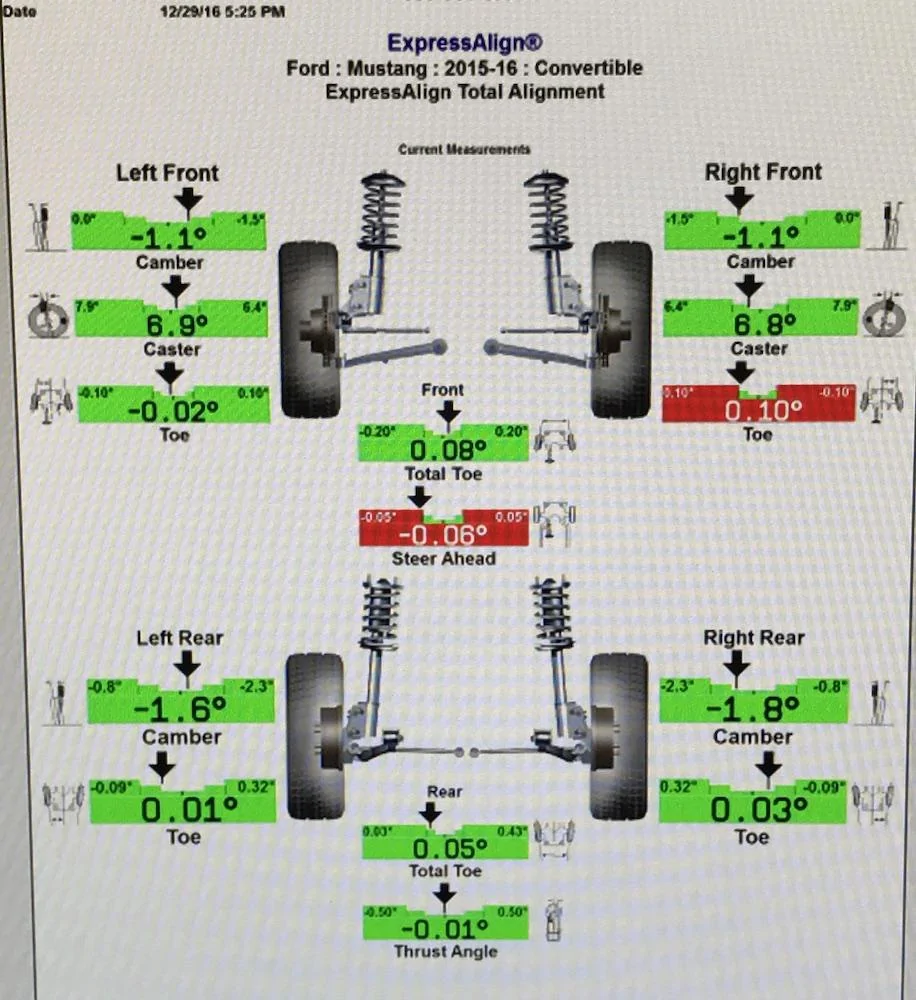

New Alignment Specs
Here is the new alignment measurements from today, let me know what you think. Thanks!

Yep, toe looks excellent for a street car. I'm sure the steering is nice and calm now.
