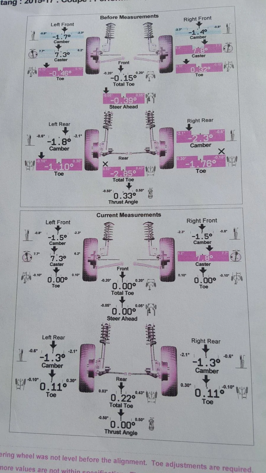

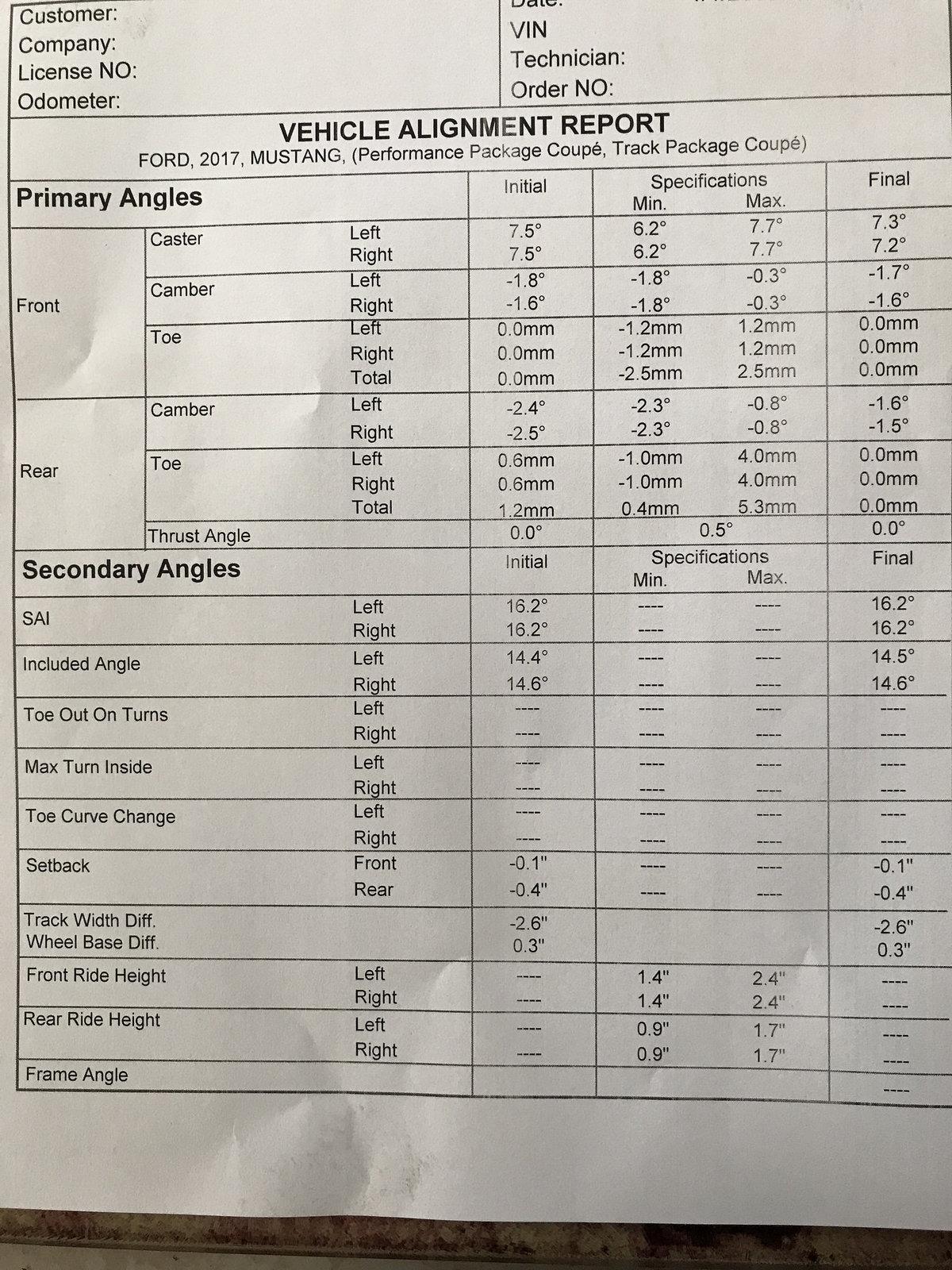

I went off Kelly's (from BMR) recommended specs. And these are my current alignment #s. Still have to install the camber bolts up front and not sure if it's worthwhile to get camber arms for the rear
Car handles a lot better than with stock alignment #s, grips the road so much better

where are Kelly's spec that you posted above located? couldn't find them

BMR 089/082 lowering springs, with some advice from BmacIL for alignment, also making sure you clock the bushing,,,,,Very happy with results.

Thank you again for the reply. So if I have them mirror Kelly's config I should have fairly moderate performance and no adverse tire wear? Just looking for a decent compromise between performance without skinning tires in a matter of months..what would you suggest if you don't mind me asking?
Yes, have them set it to Kelly's specs. Do not be OK with 'in the green'...you can have a goofy handling car with every spec in the green. Make sure it's extremely close on toe angles and within +/- 0.1 on camber. You will not see adverse tire wear. Toe is what really wears tires weird, not camber unless it's very, very high. One modification I'd make is to go closer to 0.00 up front for toe on both sides, but 0.05 in will be fine too. For track use go up in camber to around -2.5 front, -1.75-2.0 rear.
