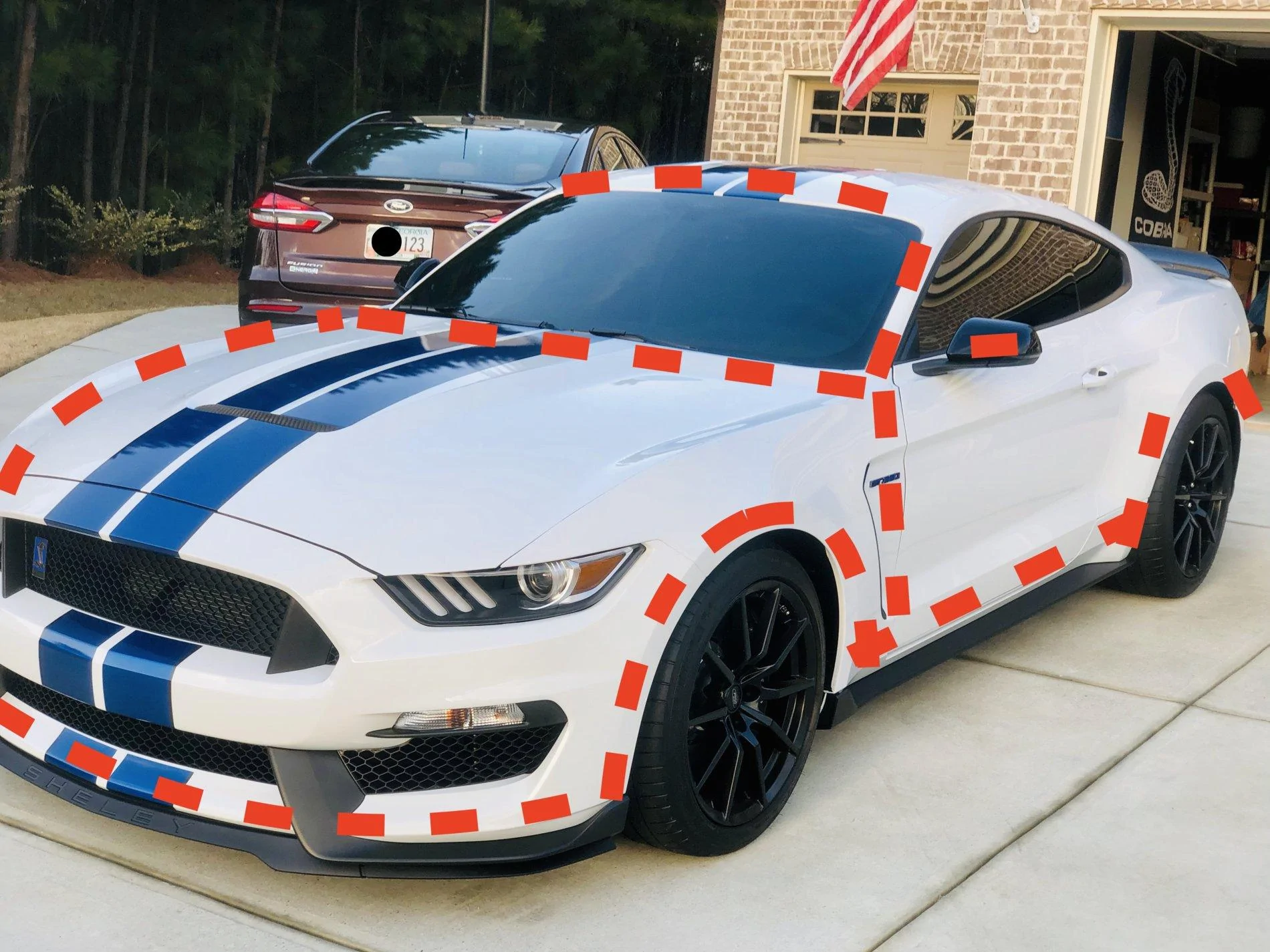

Need advice on PPF placement

I didn't notice if you have stripes. IMHO, stripes are all or nothing. If you only do partial stripes, it will look bad. Matte stripes need Xpel stealth.
No stripes Tom

I would do as your thinking.. Entire front including A pillar and roof line and the areas that you have marked.. I would also include the are behind the rear wheel. My car is wrapped in the same way
This is similar to what I am getting, just not the Pillars and roof line. I'm also having the plastic between the tail lights done as lots of dirt rests there.

If you are taking the car to the track and want to keep nice paint I would lean toward covering all forward and side facing surfaces. The leading edge of the roof will definitely take some hits as well, but the trunk and rear of the car don't need it.
One thing I've had some problems with is the lines of the PPF show up if you get any sealant on them. I tape the edges whenever I apply sealant and I've worked to clean the edges as much as possible, but they still show. I'm sure it will be better on a yellow car than it is on my black car, though.

Get the whole car done we do at least three cars a day with XPEL and Suntek for 3500.00 Canadian.See some of the work on youtube at Derand
