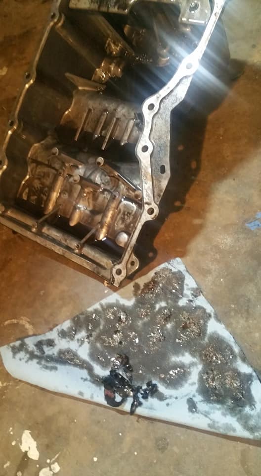

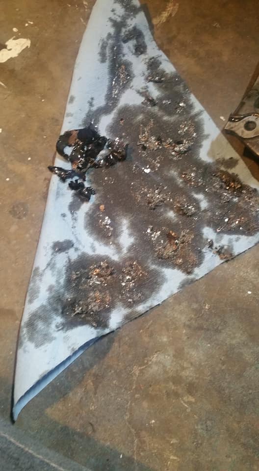

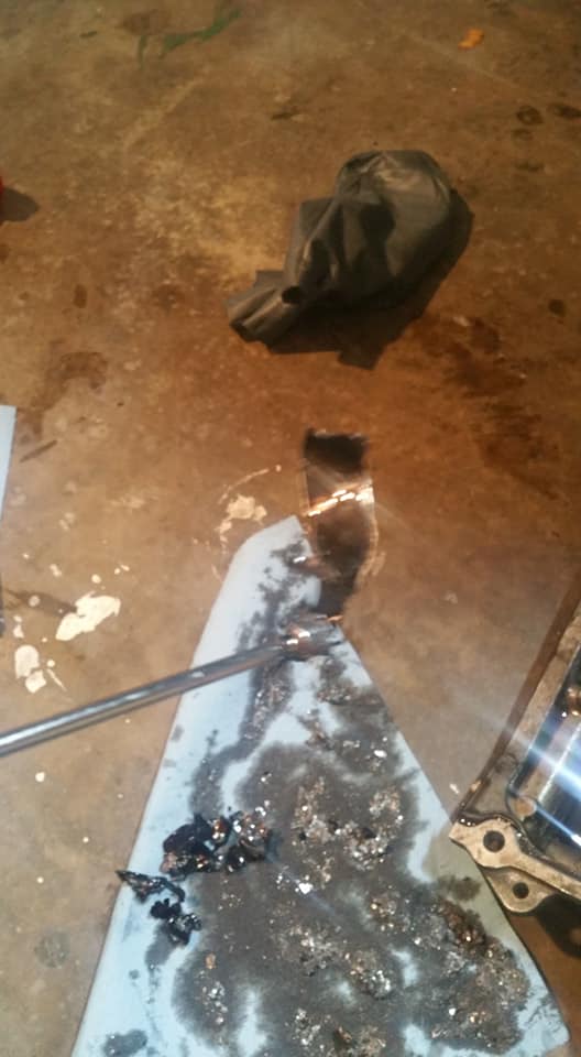

long story short- I was getting a loud, hollow aluminum knock. Pulled the valve cover and took a peek at the cams and everything looked ok. then pulled the oil pan and found a lot of this magnetic thin metal scrap and some non-magnetic scrap (aluminum).
I'm going to try and pull the rod caps and bearings tonight out of the bottom to see if there are any clues, but wanted to check in to see how tough it is to pull the head to get a full picture of the damage?
my manual shows you need all these special tools and it looks like a major pain in the ass. Any of you hardcore guys have any tips/tricks/recommendations?

Regarding your images - that is a lot of metal to find in the pan. Is your engine on an aftermarket tune or stock tune? How many miles?

thanks for the reply, cobra. i'm at 65k miles, but i bought the car used in 16 and it had previously been a rental car- so I'm sure shoddy maintenance + bad gas + renters getting on it before it was warmed up or the engine was broken in = wear and tear
I've got some basic mods and am protuned by PD.
finally tore down the engine and it spun a rod bearing on cyl 1 and cyl 4 bearing was on it's way. wish i knew the definitive cause of this, but doing a rebuild with some king bearings, rods, & pistons.
luckily the second it started to show symptoms (loud knocking) I had it towed back to my garage or else i'm sure i'd be much worse off

OUCH, lots of metal shavings + spun bearing = oil starvation and seeing how it was a rental with lots of neglect and abuse that is guaranteed. Moral of the story never buy rentals. Lucky for you it looks like you're a DIY guy, best of luck on your rebuild.

seems like my damage was mainly to the crankshaft as you can see in the pics. I've got it at a legit engine machine shop, and they will be grinding the journals down to be smoothed out. They will also be servicing the block and head. just trying to figure out how far down the rabbit hole i want to go! Looking into tossing in some darton sleeves to shore up the open deck, but not sure if it's worth it. maybe doing an upgraded valve kit. Seems like +1mm valves seem to be a thing, but not sure what the cost/ benefit is there.
