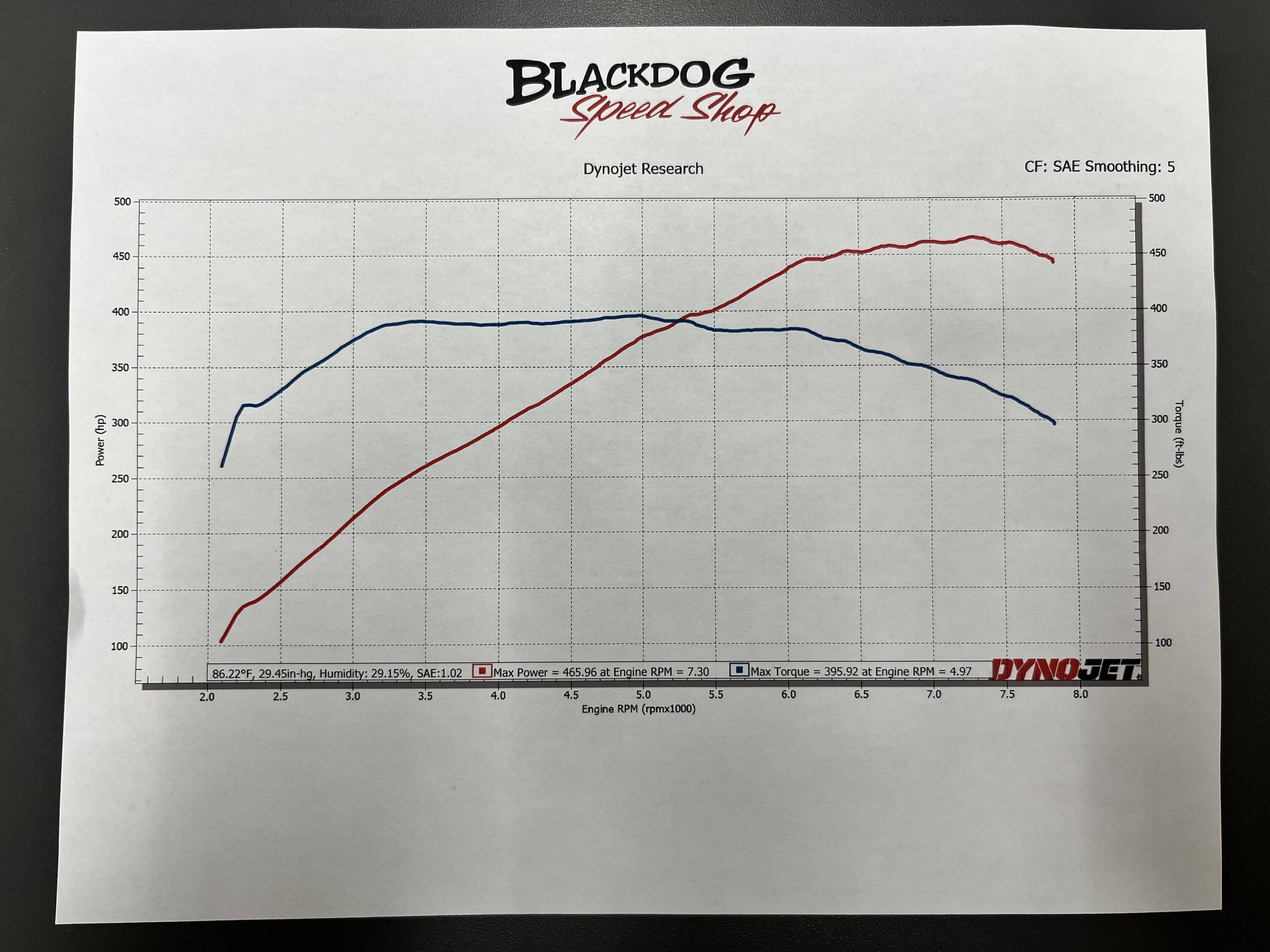

I’m at arguably 548hp depending on what you think the line losses are. With LTH and a Tune. Cams will get you another 30hp approx.
Losing weight is #1 priority. I’ve taken 192lbs out, and lost 25lbs myself hahaha. You can tell the difference.

Impressive numbers without Cams! Do you have a stock dyno chart to compare, it would be fun to see the delta!
What tune are you running and the LTH? Would you care to share more about your build and satisfaction with the tune? Curious about noise and everyday drivability.

Thats... really high reading dyno IMO.
Most full bolton GT's are in the 500WHP range, and I think the BEST ive seen from a Bullitt/Mach1 engine with tune/headers on 93oct was 500wheel, and best ive seen with just e85 was about 490 wheel. Headers and e85 shouldn't be really much over 520 even on a great day. I'd love to see what you did stock on that dyno for a comparison.

His dyno sheet shows 466rwhp/396rwtq so in spec for what you have seen.

There’s a thread and you may need to jump to another one inside that one. Since then (Optima Battery and rear bumper bar to get to 192lbs, plus me -20lbs so even more, hahaha) Next DA1 driveshaft. (Crap there’s photos somewhere too I posted, someday I need to put them all in one place. You can click on my name and search my reply’s and/or posts)
I don’t drive it on the street but at low rpm it’s calm.
Yes 466hp @rear wheels, is what at crank to compare to stock 480hp rating? 530hp, 540hp 548hp?? That’s why I said arguably. Anyway fun times.
https://www.mustang6g.com/forums/threads/2021-m1hp-lwt-dyno-548hp….177257/
Someone posted stock M1 dyno, not concerned with the past or exact gain, rather what is it today.

AH the sheet wouldn't get bigger for me I was going off the number he mentioned.
