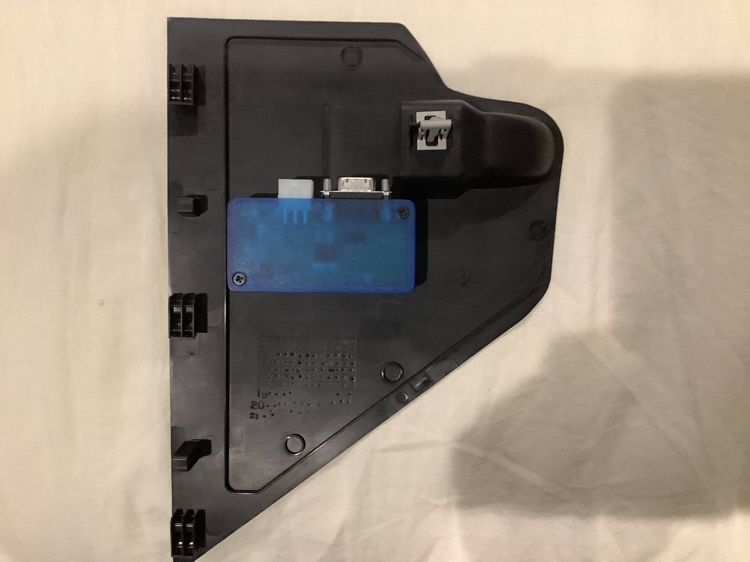

NP. I spent a lot of time trying to figure out the best location for the box before settling on this spot. The good thing about this location is that it‘s a lot easier to run the wiring to. Another option I considered was mounting it on the outside of the fuse cover, but after some pondering, I figured it would be best to get it completely out of rhe way of any passenger’s feet. Don’t want somebody’s foot resting against the reset button and erasing my settings.

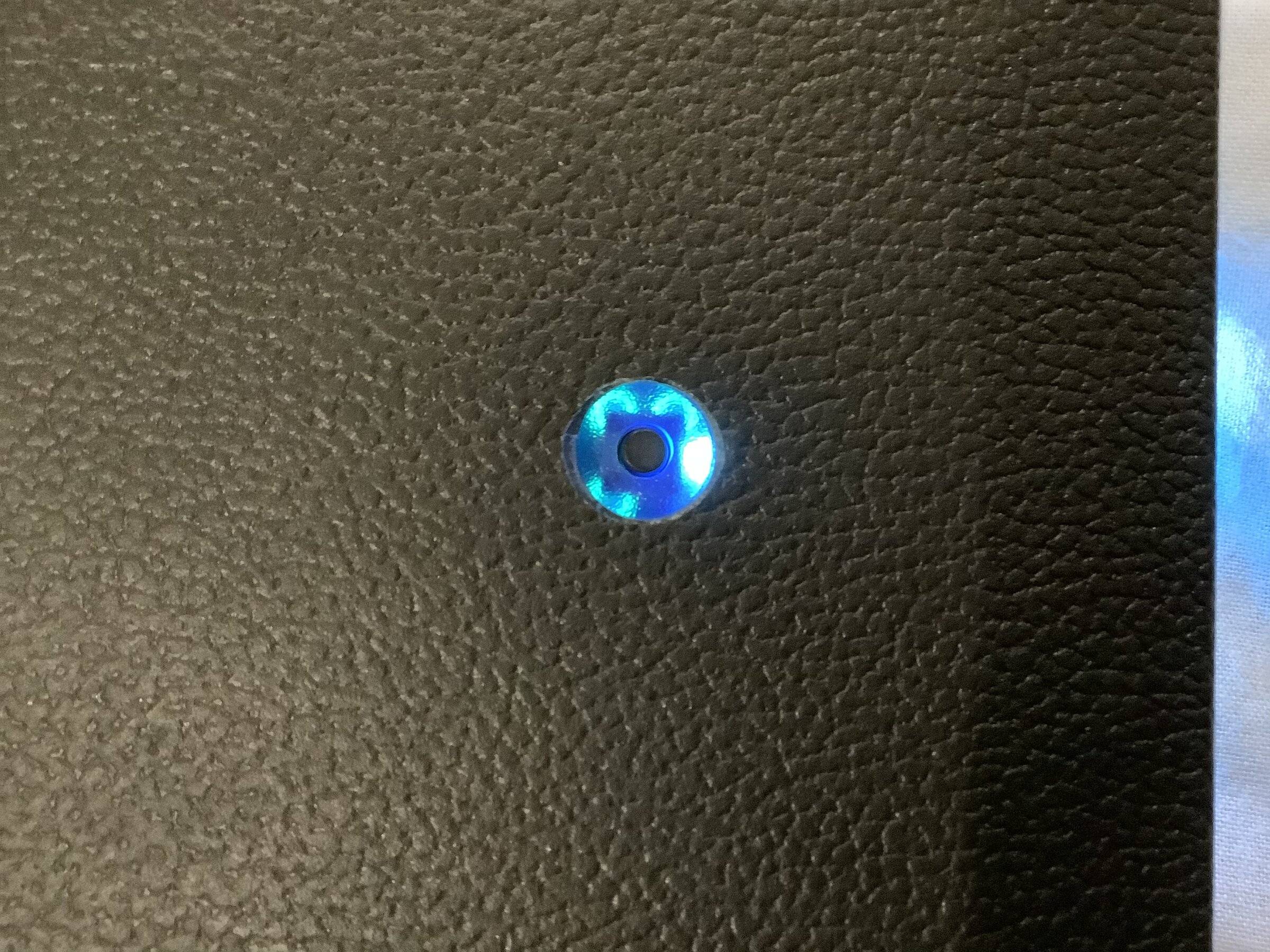

Okay WildHorse, here’s what I came up with to mount my WOT Box on the inside of my fuse panel. Note: You can see where I drilled a 5/16 hole in the fuse panel to allow access to the reset button on the WOT Box. The hole is just the right size to allow the LED light to shine through, so that I can reference the status of the WOT Box.

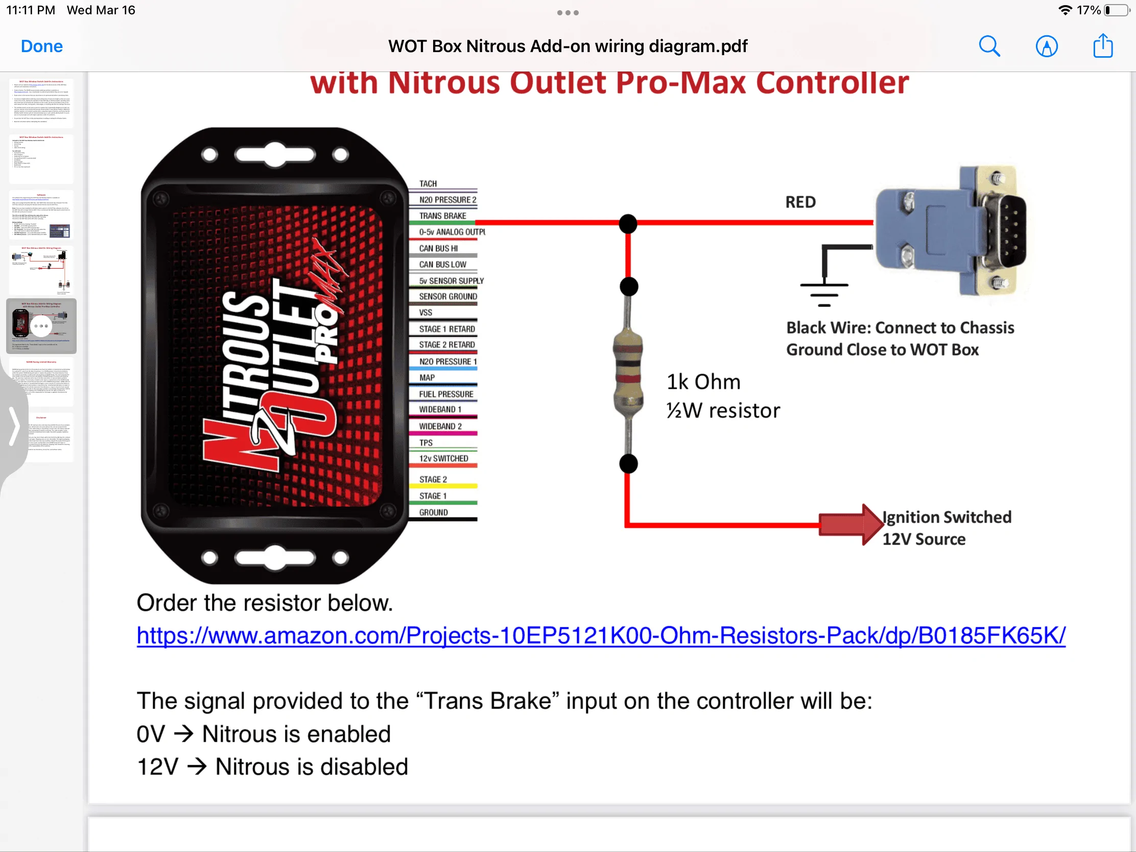

Lastly, I am also using N2MB’s Nitrous Add-on harness. I hope everything works out well with the integration of the Nitrous Add-on, with my Nitrous Outlet ProMax Progressive Nitrous Controller. I don’t think anyone has done this before, so we shall see. N2MB worked with me and sent me the attached wiring diagram which should allow it to integrate properly.
