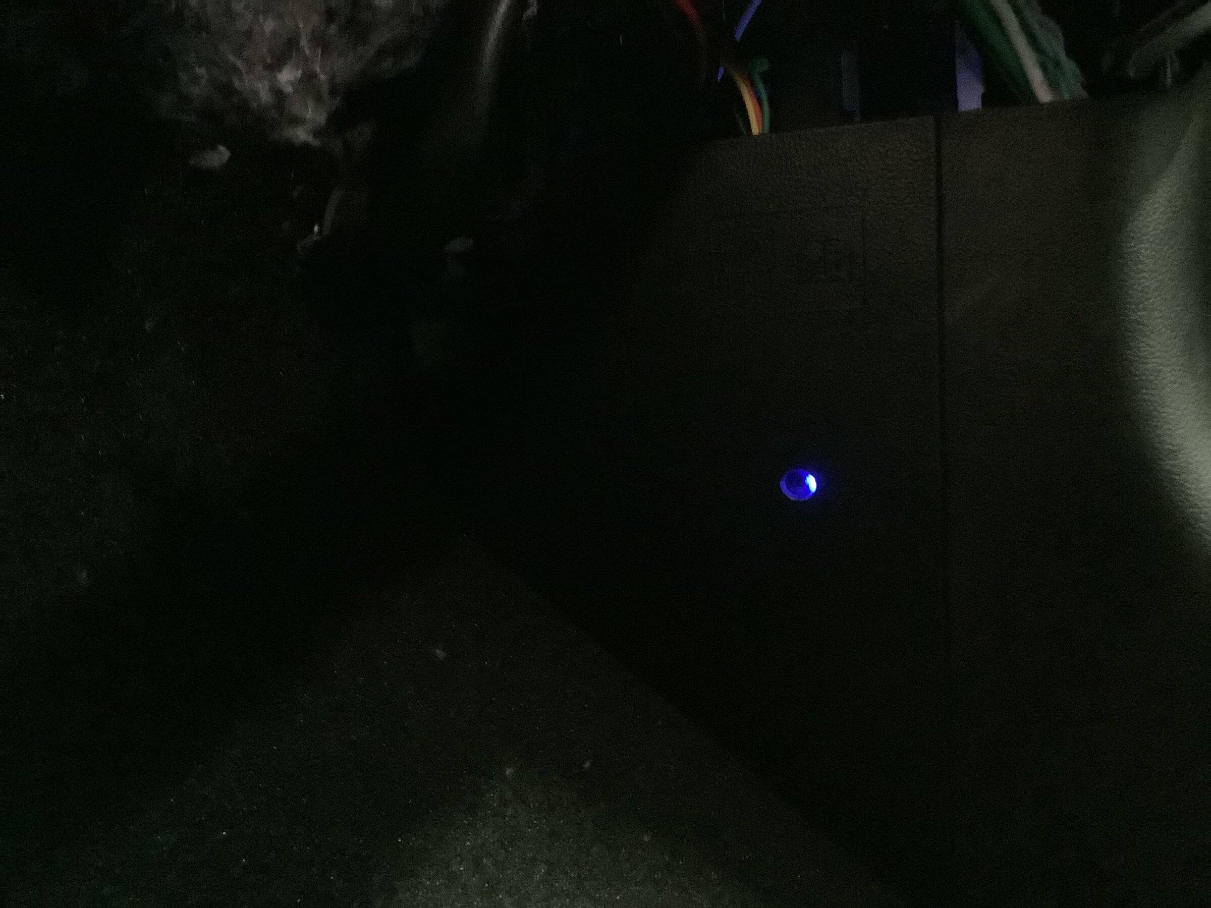

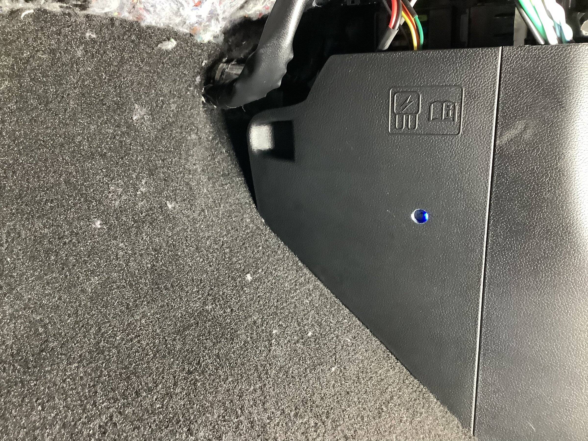

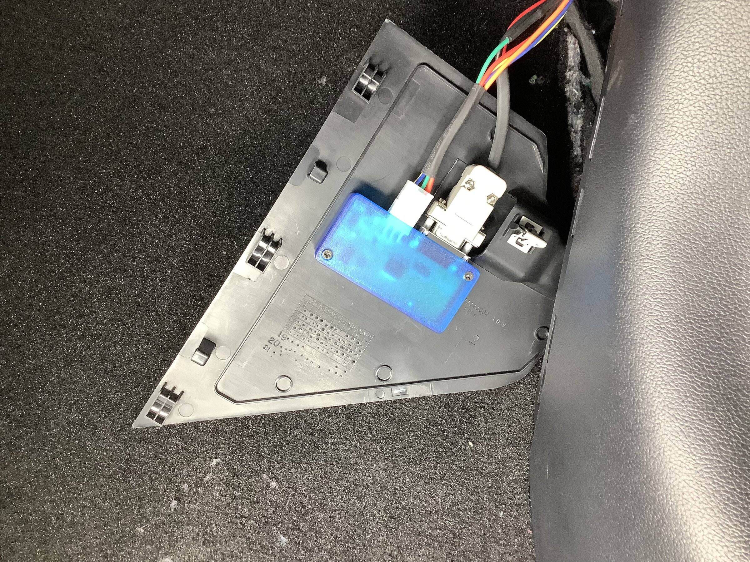

Finally,a few pics of the WOT Box and Add-on Nitrous harnesses connected to the WOT Box with the cover secured back in place.

You can always splice in a LED and place at wherever you want.
That‘s a good idea and one that would have been worth considering, but I can see the light from the driver’s seat. I‘ll only need to look at it when setting and or troubleshooting. Hopefully, I won’t have to mess with it again. I’ve had enough WOT Box nightmares for a while. Getting that thing installed was a huge PITA, especially trying to integrate it with my nitrous controller.
Right, but I hate copying somebody else's genius, so I'll do my lame idea ha-ha.

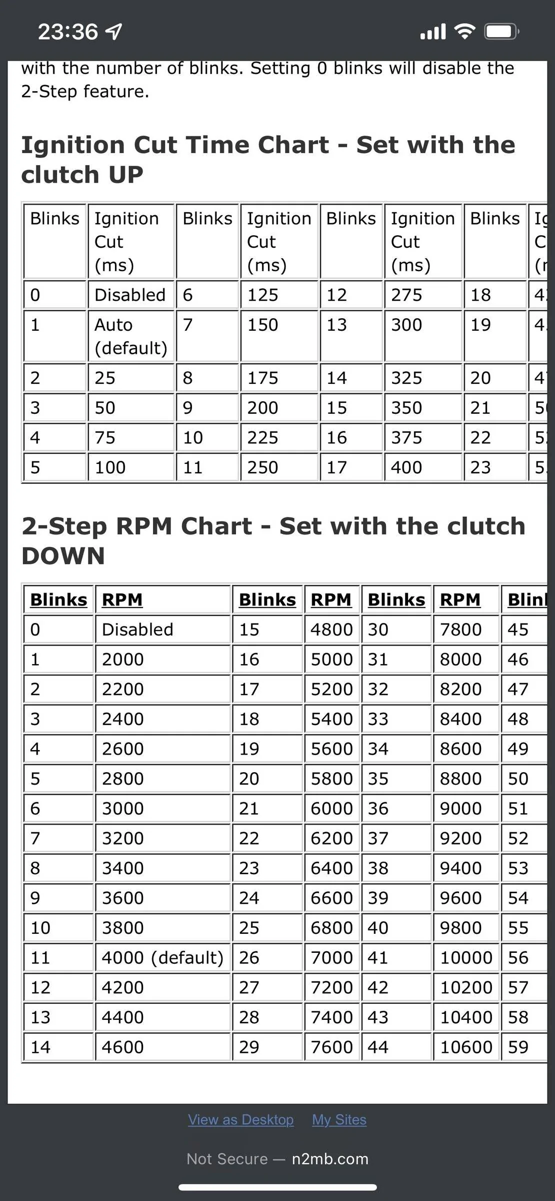

Unless you want to bring your laptop everywhere. There’s a button on the box that you can do on the fly adjustments to your settings.
I’m lazy and just tuck mine into the glove box so that when I’m adjusting setting I can reach over and grab it to press the button.
Thanks! That could come in handy for motor runs only, but I believe I’d need the laptop to enable/disable the nitrous feature with the nitrous add-on. I will make a copy of that cheat sheet though, just to keep in the car in case it’s needed. Thanks again for posting that.
