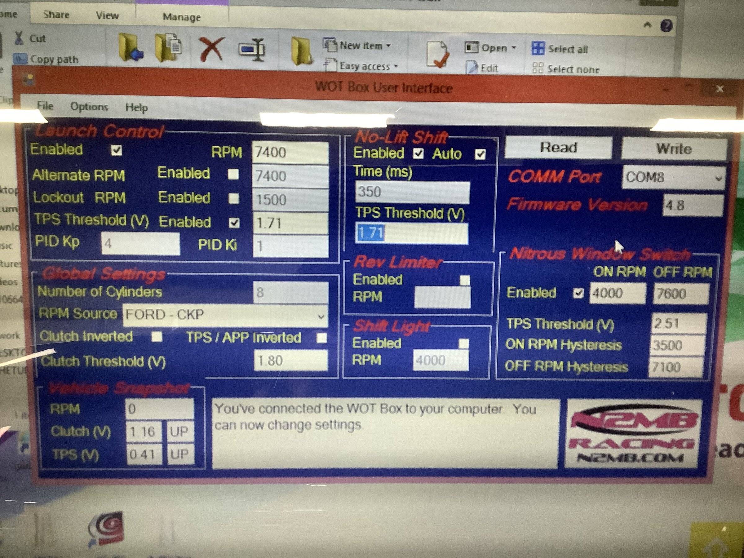

Here’s a pic of the software for an idea of what’s adjustable.
Those are your settings ? Is the lockout RPM your launch RPM ?
Yes. The owner of Clutch Tamer instructed me to launch between 7400-7500 rpm with the Hitmaster clutch mod. he said when the clutch begins to grab it’ll pull the motor down 2K rpm. That’s why he recommends 7400-7500 rpm launches.
