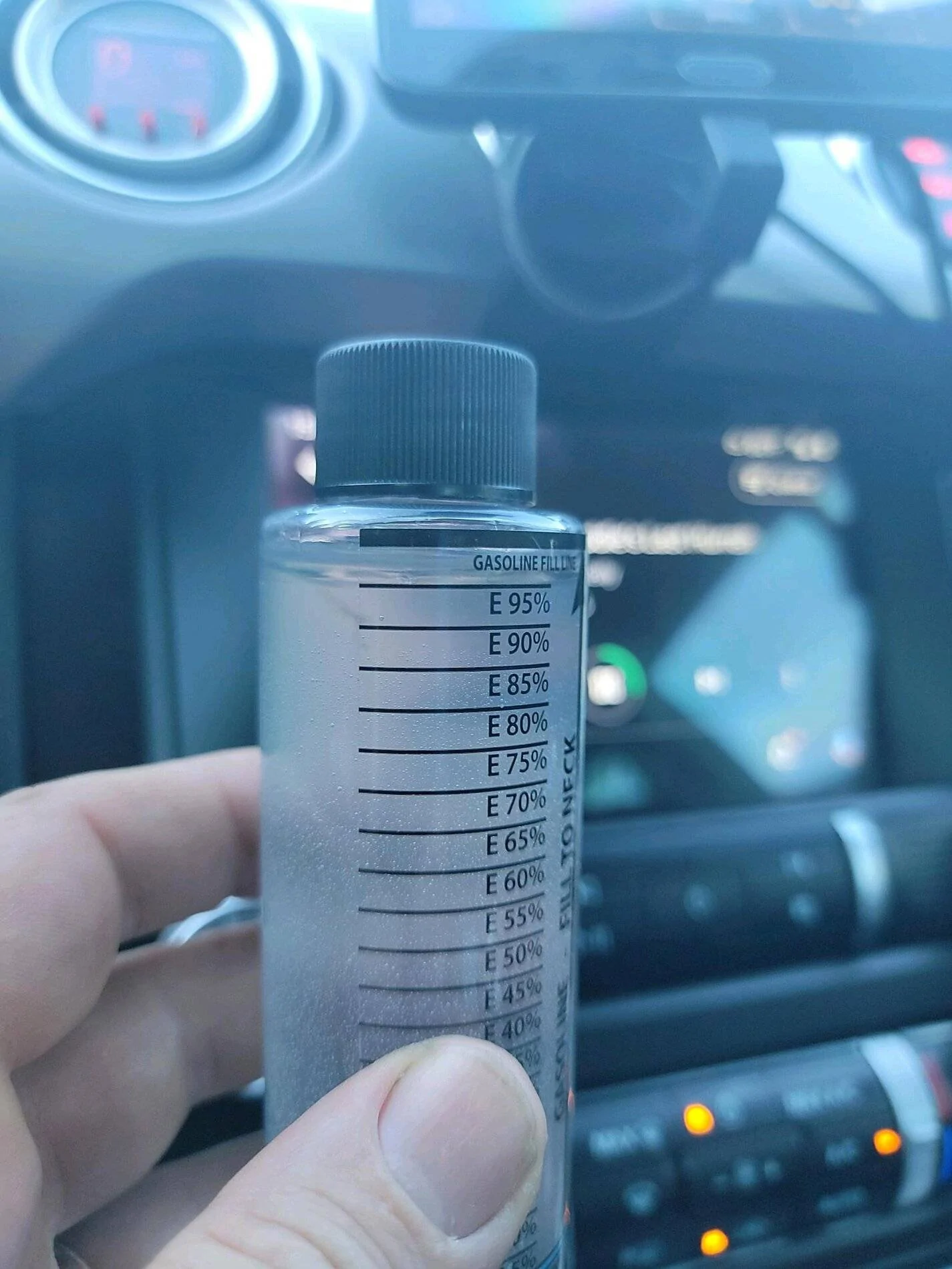

2.73 a gallon, car is filled up along with four 5 gallon cans I have. Thought about going and getting some 50 gallon drums; never seen it test this high. Did it twice to confirm, car sensor also verified it.
