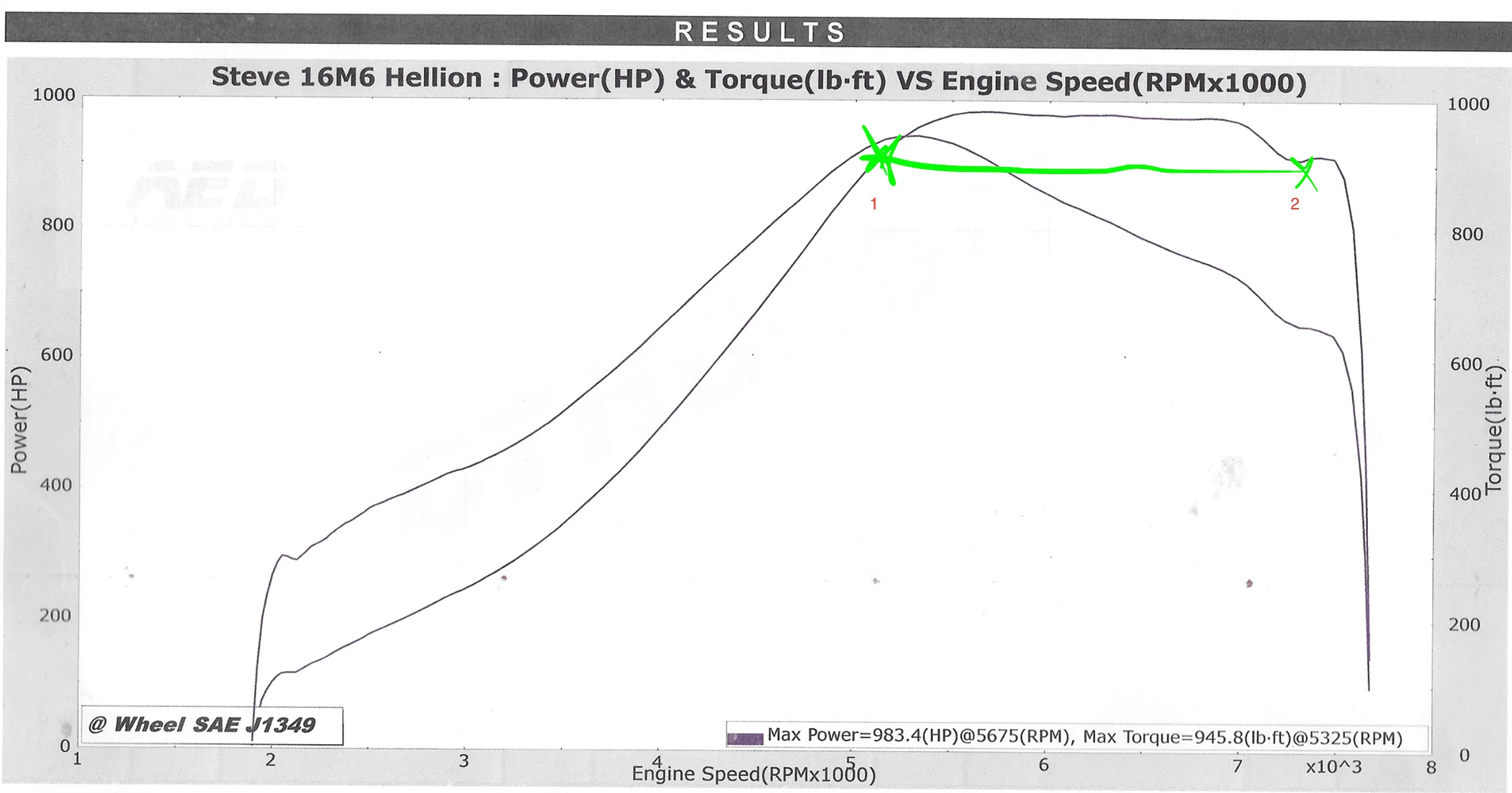

This is getting over-complicated. The whole point was you want to ride out the HP until it's less than what it would be when you shift.
Someone originally made a bad assumption looking at the original graph (saying you would not need to go past 6500).
It's that simple. Works for every car. You don't need math.
Erase the torque from the graph becuase it's just misleading. HP is the only one you care about for shift points in 1/4 mile racing
