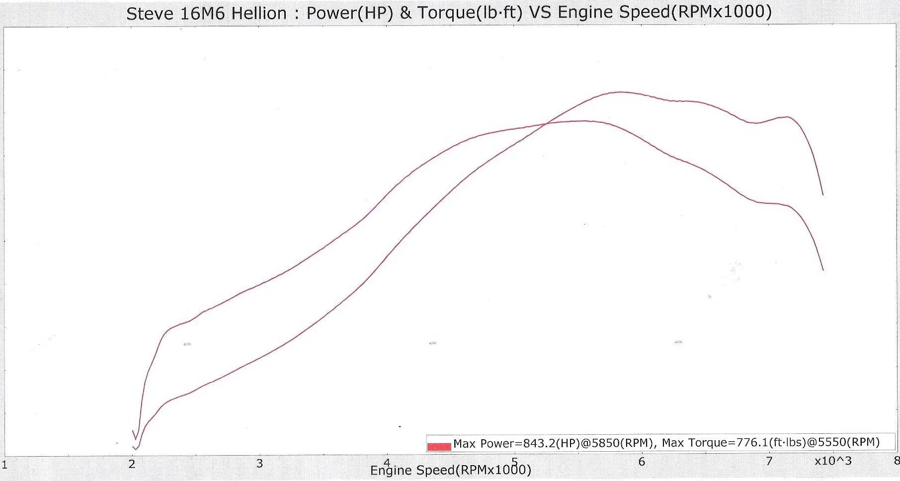

The car made 843 hp on 12 psi on e85, we were having some valve float issues the first time we tuned the car so i installed cutouts which really helps but my tuner said im pretty much at the limit of this system due to the two turbos down pipes joining together causing too much turbulence and creating back pressure causing valve float I have attached a dyno graph lemme know what y'all think

Seems to peak awfully early. It was well on its way to 900+ if it kept making power to 7500 or so.
The drop off doesn't look like float to me, but maybe the graph has all the smoothing in it? Does it hold 12 psi to 7000+?
Either way its a beast and must be a ton of fun.

Yes it holds 12 psi almost 12.8 till 7k I could of raised the boost but stock motor with stock manifold

I got the same kit and installed cutouts yesterday, hopefully dyno next friday. 843 wheel is good power on 12lbs

Nice numbers. My tuner said I was having valve float issues as well beyond 12 psi. I did bumper exits, 4 to 1 headers, and valvesprings...I think we're good to go now. But I have the 55mm turbos and GT350 intake manifold.

I put cutouts in just before catback to try to help with the back pressure but what my tuner was saying is there just too much exhausts gases moving through one small cross over section. Im also running a phyrometer right at the x section and getting temps of 900 degrees F.

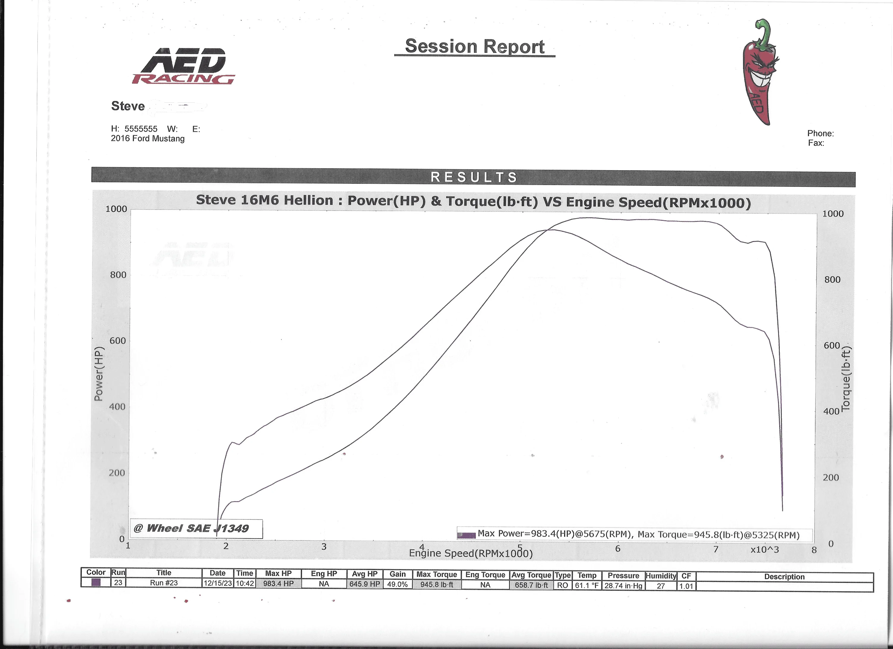

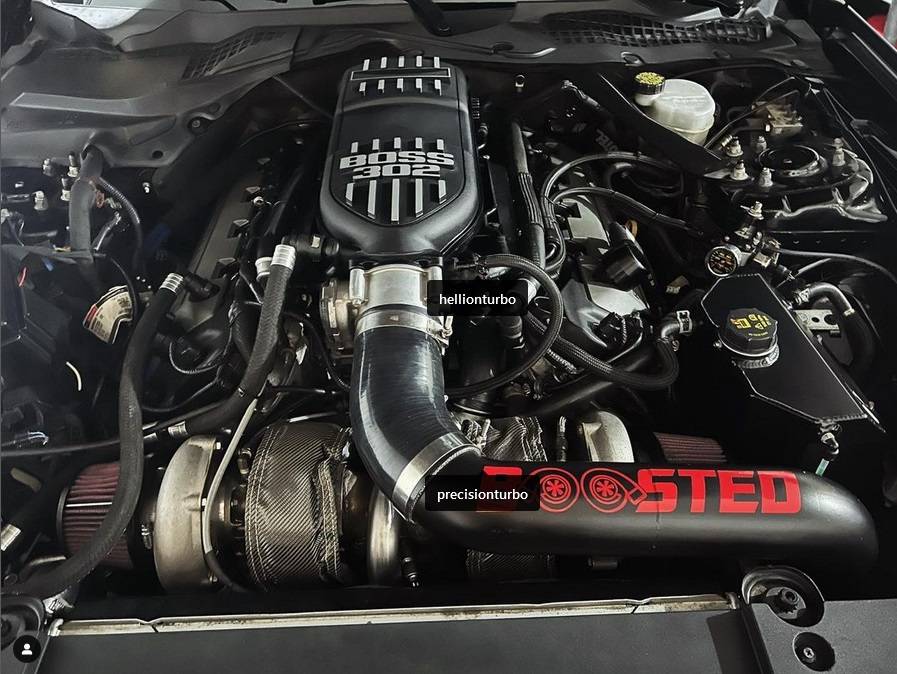

Upgraded to boss302 intake , valve springs and some fresh timing components
made some good power
made some good power. still 12 PSI right?
looking much better up top, still something going on right at the end, but for the most part it's all cleared up. Did you change out the valve springs?
