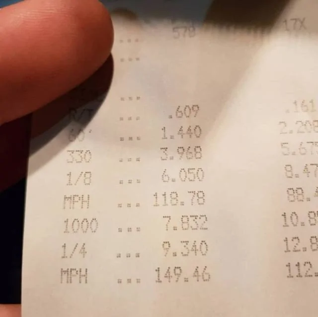

Took my car to the track friday night and ran a new best 9.3 @ 149, Full weight premium 3950lbs race weight, stock motor around 15.5psi or so on this pass. We have found the limits of the stock fuel system with BAP running Q16 fuel in this weather with open dumps we were starting to run lean assuming around 900WHP. Also found the limit of the stock half shafts the next pass after this they do not like 1.40 60's at this weight lol.

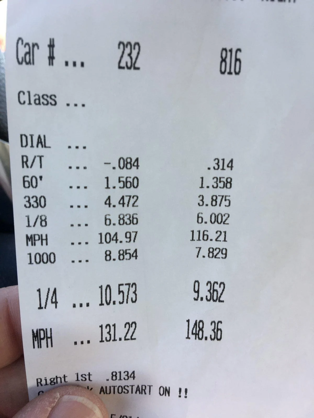

I was close on the Paxton yesterday with 3.48.
Damm that paxton on the e.48 is flying!!!.To op was you on a transbrake to get your car to stall that high up on your launch?

He must have weight reduction no way a 3.48 paxton is going that fast and or surviving, And yes my car does have a 2 Relay Trans brake it was set at 3600 that pass... Next pass I tried 3700 and it broke a half shaft!

Yea he had his back seat and pass seat,but for a 3.48 pulley he is flying.He put it on me with my d1 lol.
