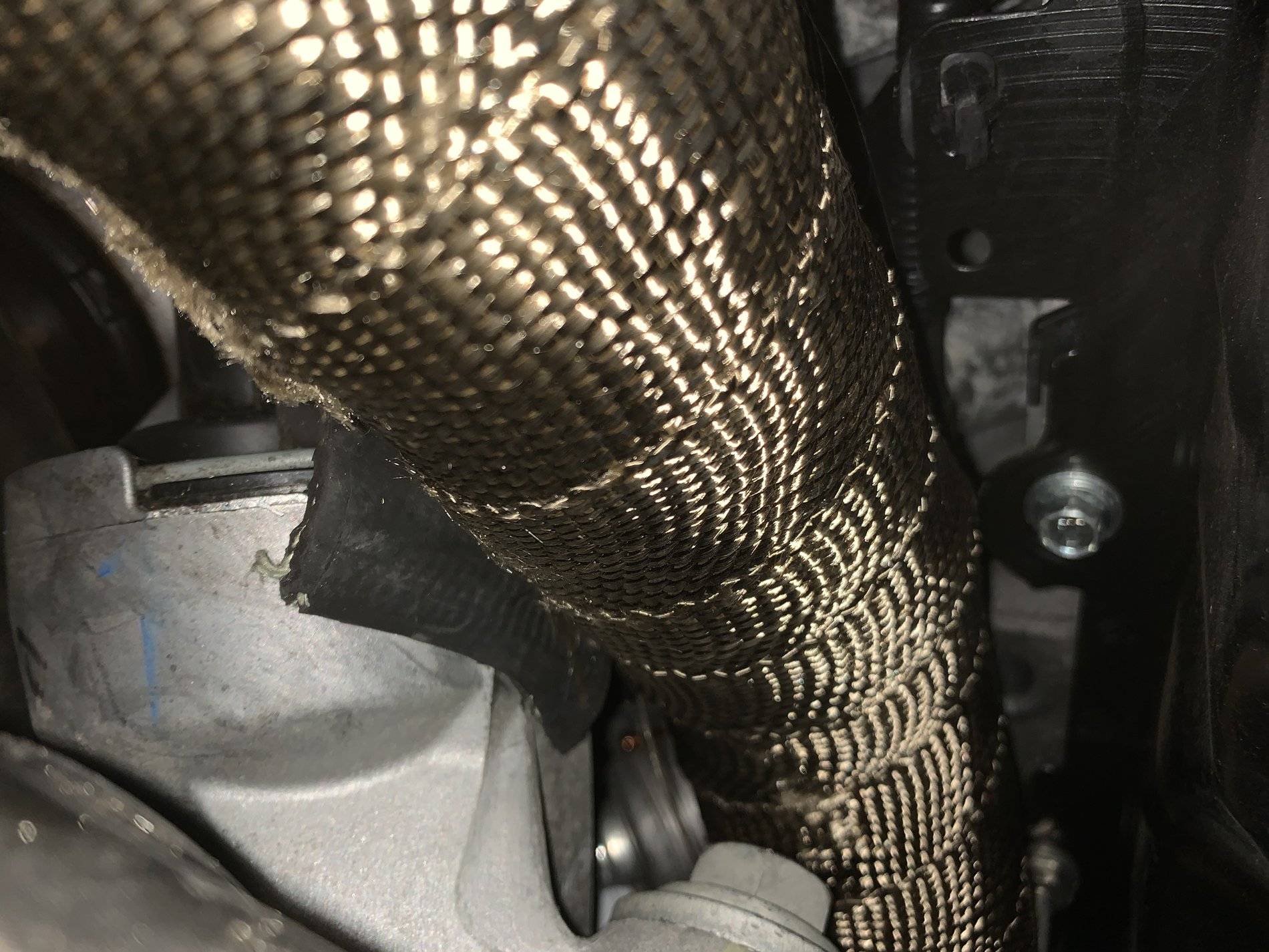

Anyone with hellion top mount twin kit have false knock issues? I had them bad on 93. Went e85 and lowered the knock sensitivity, Still seeing 10* knock. Any common spots where the hot pipes hit that i’m missing?

was under the car all weekend. Moved anything that looks like it’ll hit/ put cushion on anything that was close. It comes about 17% throttle. Iv tested with race gas/ lowering the boost its the same every time.
the 2 hot pipes leaving the turbo are on the sway bar. But theres no way to move them or cushion them, they’re stiff in there not sure if that causes it.

I got rid of that front sway bar early on and haven't had any false knock issues. If you have exhaust pipes touching the sway bar, it's probably best to remove it.

Was able to actually move them away. I found the driver side pipe touching the steering

Yea those down pipes are the only biggaboo that i dont like about this kit. I wrapped the down pipes and it fixed it. Thought about removing sway bar but i dont want to loose stiffness. I have PP car so sway bar is thicker than stock one, maybe swap for the stock one might work.

I was able to move it off the sway bar. Found it touching by the steering column
