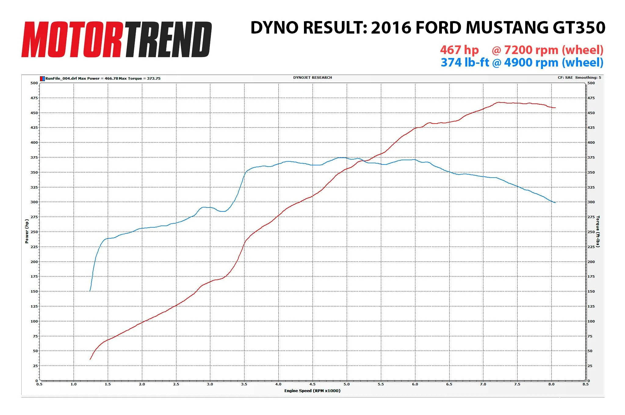

You have to take the RPM into account, it may make more torque at that RPM but that doesnt matter because its power over time that matters. 1197*6900= 8977500 per min
1207*5800 = 7000600
Basically, making 1197 torque 6900 times per minute is better than making 1207 torque 5800 times per minute which is why horsepower matters more than torque for acceleration. (horsepower is derived from torque and RPM)
and when I said he doesnt have to rev that high earlier in the post I meant like 8k plus.
Optimum acceleration will always be through the highest peak HP powerband not the peak torque powerband.
Just no.
The dyno reports the physical torque the motor is creating all the way to drum AT THAT RPM. It's already a result of what the motor can produce AT THAT RPM.
Look, this isn't a difficult concept. Torque is what produces force, which is what accelerates the mass of the car. In SOME CASES, where the torque is much higher lower in the RPM range, it's actually faster to sacrifice gear multiplication in favor of increased torque production. You're free to read up on this if you wish. There's mountains of literature on the subject. I'm not making it up and it's not something revolutionary.

My dude, acceleration is force over time.
Consider the following two engines during a 2 second pull:
1. A v8 engine making 500ft lbs of torque at 3000RPM
2. A v8 engine making 300ft lbs of torque at 7000RPM
Engine #1 is running at 3000RPM, and makes 8 power strokes of 500ft lb of force every two revolutions - or every 0.005 seconds (60 seconds / (3000RPM / 2 * 8cyl)). That means engine #1 applies a 500ft lb force 400 times during our 2 second pull - a total of 200,000ft lbs of force.
Engine #2 is running at 7000RPM and makes 8 power strokes of 300ft lb of force every two revolutions - or every 0.00214 seconds (60 seconds / (7000RPM / 2 * 8cyl)). That means engine #2 applies a 300ft lb force 934.58 times during our 2 second pull - a total of 280,374ft lbs of force.
Engine 2 is making less torque, but making about 40% more power. The fact that we measure horsepower at all is for this reason - you need to consider the rate at which the torque is applied. Torque is a measurement of force at an instant, and horsepower is a measure of that force and the rate at which that force is applied.

In a word no. The dynomometer measures the torque being applied to the roller at that RPM. So the number of combustion events required to produce that torque value at that RPM is already baked into the result.
Moreover, the power is "inferred" based off the change in torque. Or more simply put, the power is a component development of what the motor must do in order to produce the torque at that engine speed.
Which is why you see the power increasing when torque is either flat or in some cases declining. In order to maintain the torque the motor must continue to increase power output up the RPM range.
At a 1:1 drive ratio with a fixed rear ratio, the motor must increase power output all the way up the rpm range in order to maintain a desired torque output.
This isn't a difficult concept. It's why they make transmissions in the first place, to increase the torque multiplication as the engine runs out of rpm/power to sustain it as speed increases.
Your example is laughably flawed. When a motor vehicle tops out it's generally either RPM limited or torque limited (meaning it runs out of rpm to redline and can no longer accelerate or apply more power to accelerate the car any further, OR it runs out of torque required to push against the exponentially increasing wind resistance).
