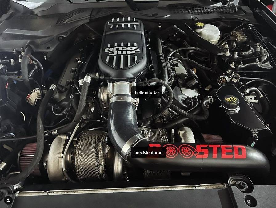

Installing Boss302 intake and now the throttle body position sits a little different from stock intake, whats the remedy for this ? I was maybe thinking cutting charge pipe and welding a piece of pipe to pitch it up

Any info on this? I have a boss manifold and a 90mm tb and wondering how the fitment for a hellion kit might go

Sry for late reply, but i had to modify charge pipe and get a 45 degree hose to make it work
