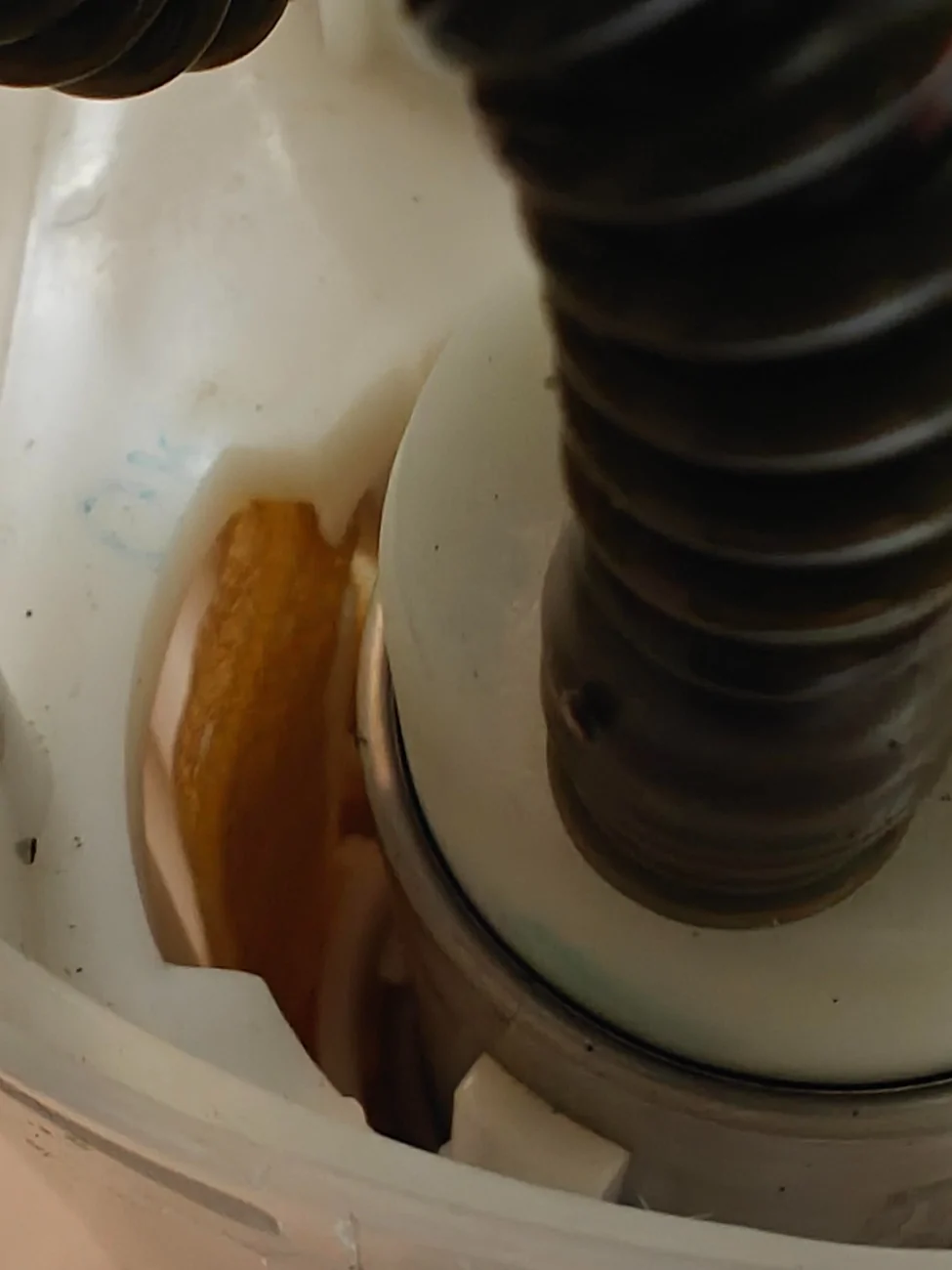

@Vandor did you by chance clean out the tank to see if it had any debris in either saddle? I’m just curious to know how much gunk gets in there over time. I ask because the fuel socks often turn from white to black in no time.
One member recently posted about changing pumps at the track and his socks were as black as coal.
My socks were clean and the tank was clean for me. I didn't notice and build up of any kind. The socks are a little yellow that's about it

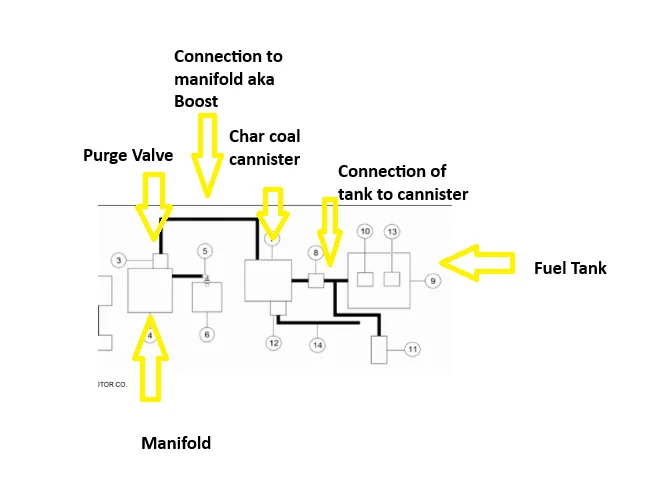

I thought a lot about this. I think what's happening is purge valve solenoid is failing and allowing a little bit of boost into the evap system. This I believe goes to a coal canister and then to the tank. I think you're allowing boost into the evap which is blowing into the coal canister and then the tank. This would explain the "Black as coal look"

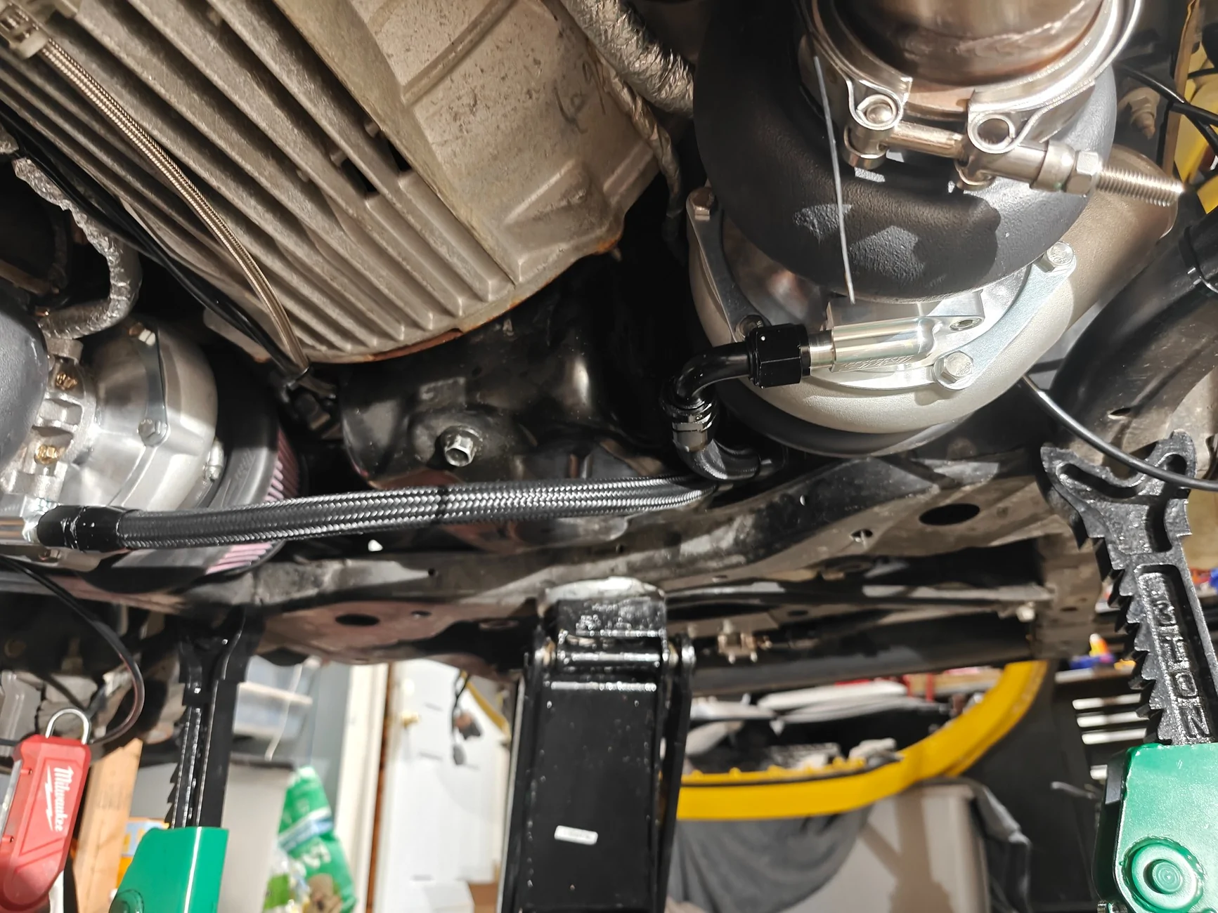

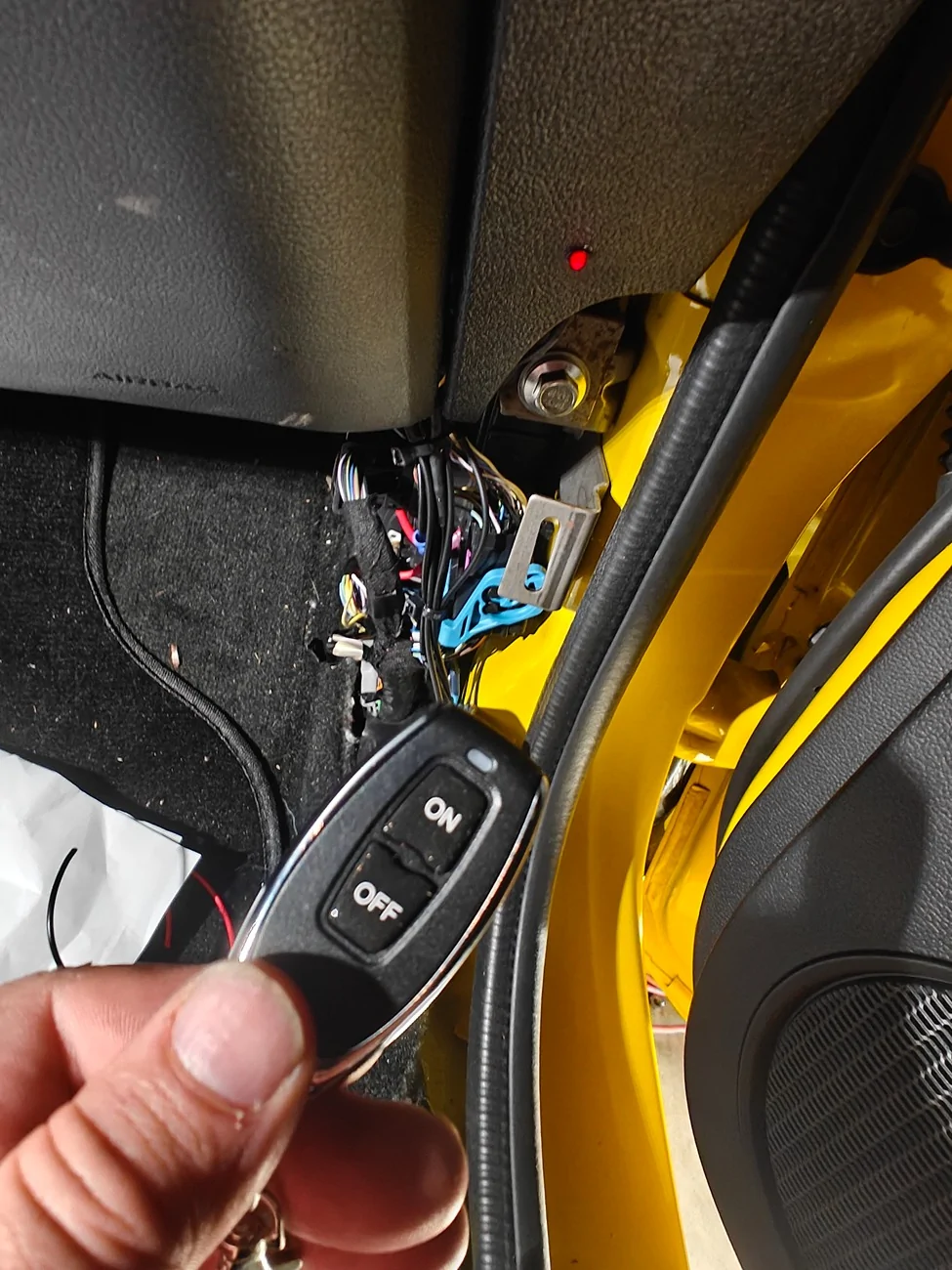

Turbo oil return lines are all done and my remote kill switch has been wired in. Also all the fuel lines are done except one I made too short so I have to redo it and the fuel system should be good to go. And good news! The charge pipes are on there way from Hellion :) Once they're in it's time to start talking to Lund and some 94 sunoco in the tank.

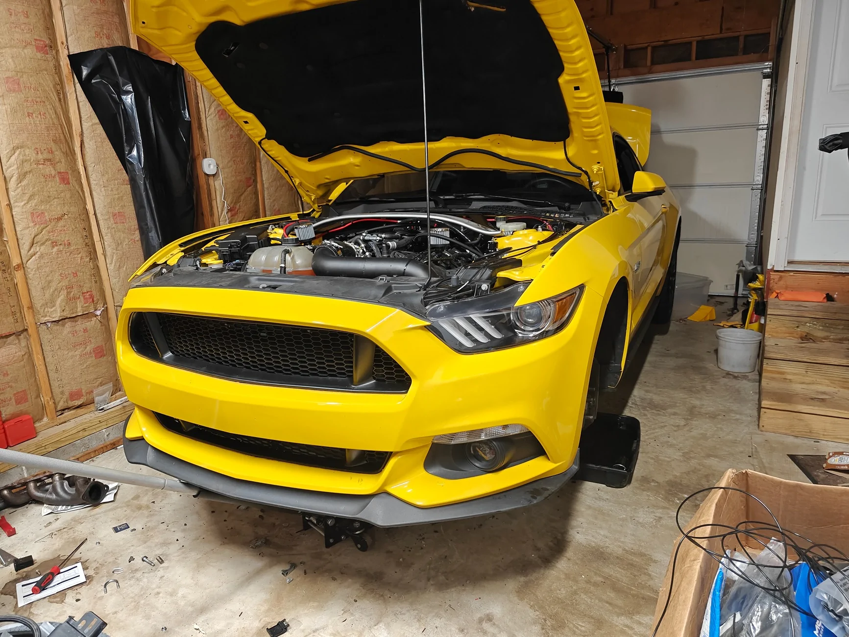

ok pipes are in and BOVs are hooked up to the vacuum manifold. I checked all the fuel lines are on and tightened. I replaced the grill inserts with the blacked out ones and bumpers on and wheel bins. I changed the oil to a 5w-40 synthetic and sunoco 94 has been filled into the tank with a can of boostane pro. I just have to smack the wheels on and shes done. I decided to go with palm beach dyno and my HP tuner comes today in the mail. I just have to read the stock file and send it off. Hopefully I'll have my base map tomorrow and I can start her maybe even get a drive in, we'll see. I left rear seats out for now to check for leaks but that's the only part that needs to go back in.
