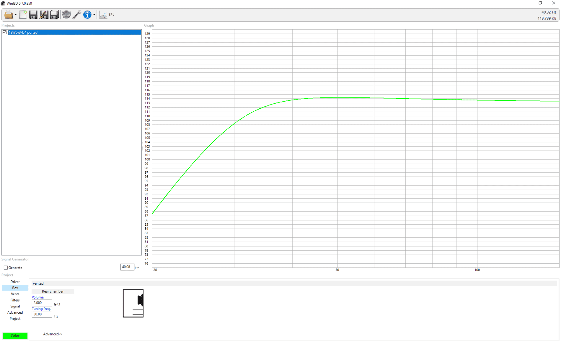

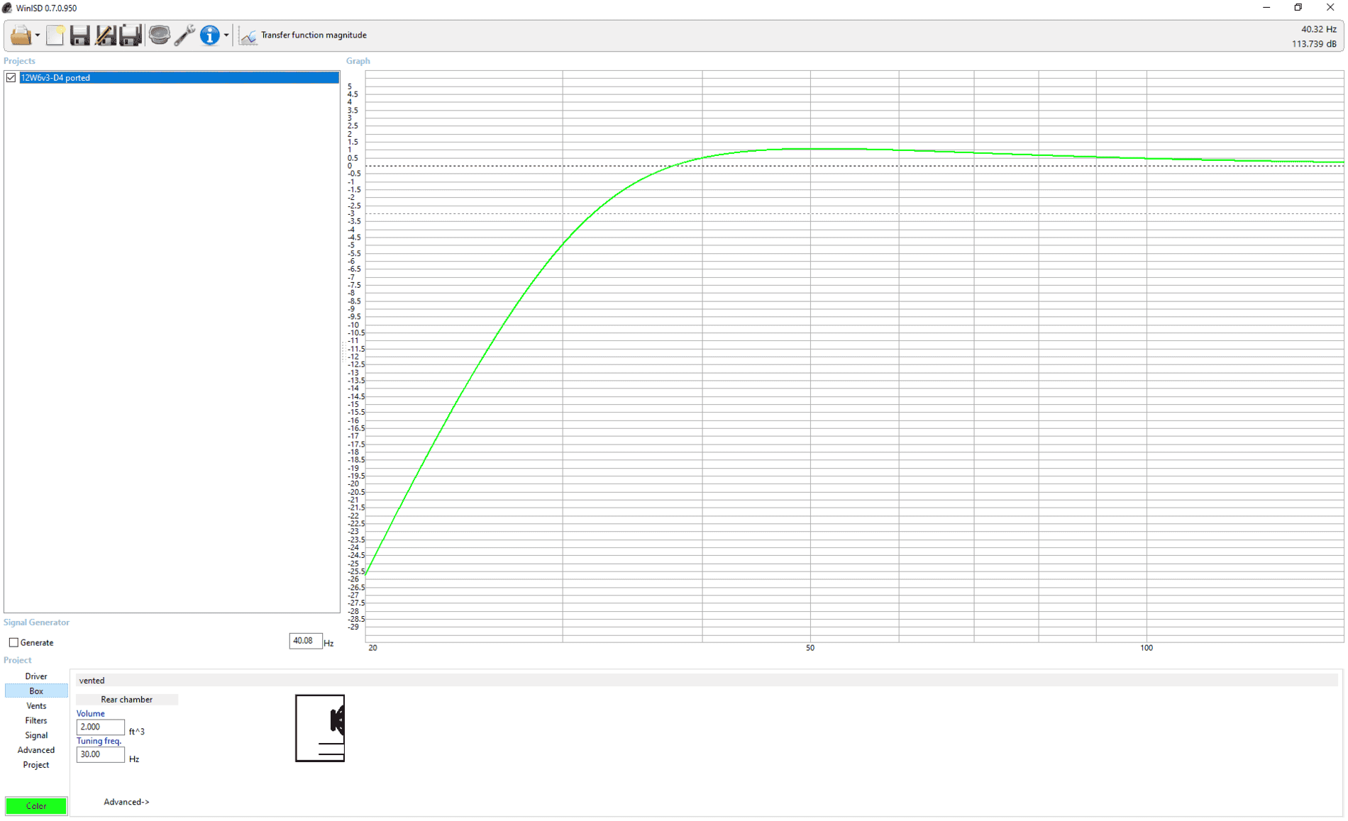

It took more than a month but I finally got my hands on a 12W6d3-D4 sub. I sat on Crutchfield's waiting list for a while before deciding to just pay $20 more and get it somewhere else. The sub and the Precision Port are sitting in the garage, waiting for me. I've got my box design done. 2.0cf net, with a 4" Precision Port. Tuned at 30Hz and WinISD shows ruler-flat down to 40Hz. Should be a nice sounding box.

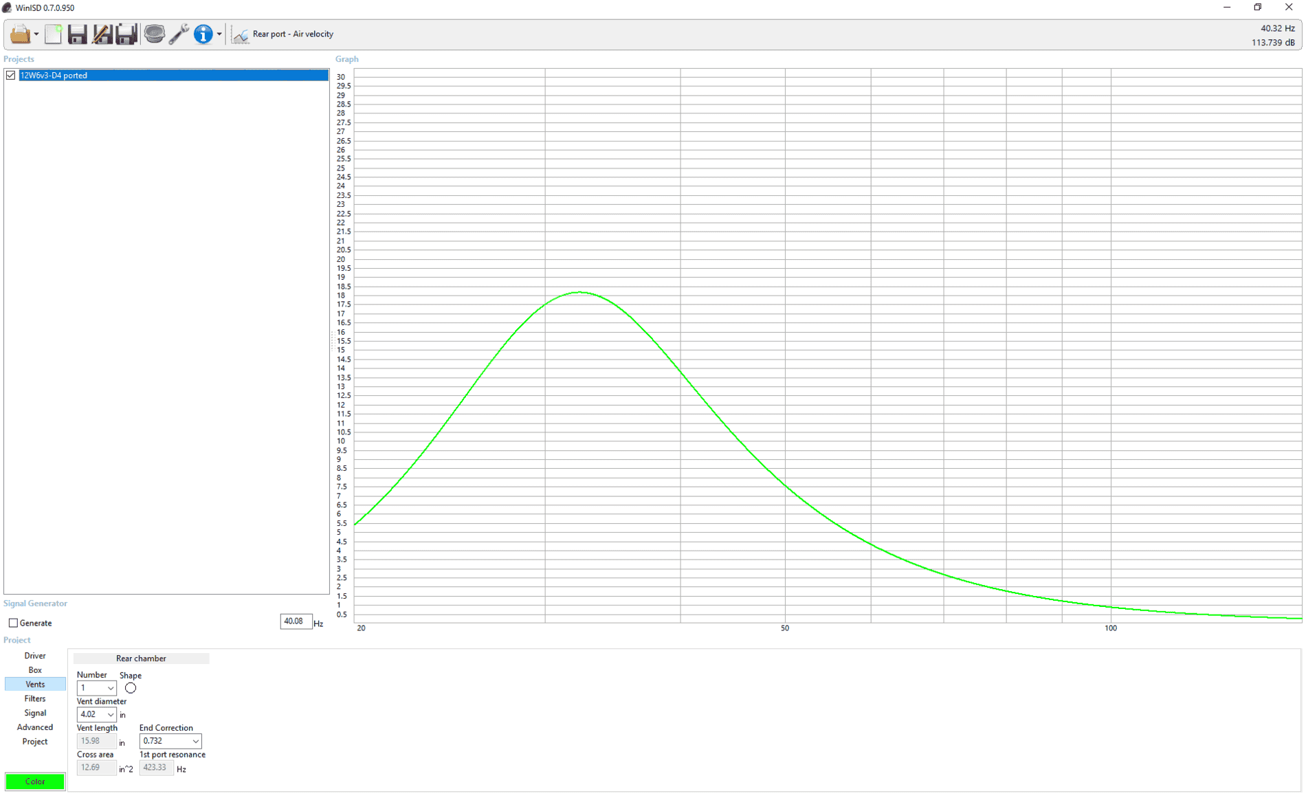

Some WinISD screen grabs from my box design for the 12W6. These are all with input power of 600w.
The port velocity around 33Hz looks a little high, but the combination of the flared Precision Port and the box being in the trunk, I won't hear any port noise from the driver's seat.
Transfer function - nice and smooth, no peaks. Should be a nice-sounding box.

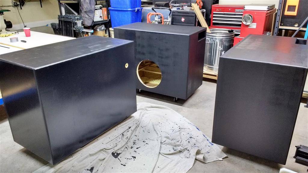

I've also built my own subs and mains for my home theater setup. I didn't design the mains...just built them from plans. The subs, I designed myself since they are easy compared to trying to figure out crossover points etc for a mishmash of midbass and horn drivers. That's way above my head. Subs need a bandpass filter and off you go. :beer:

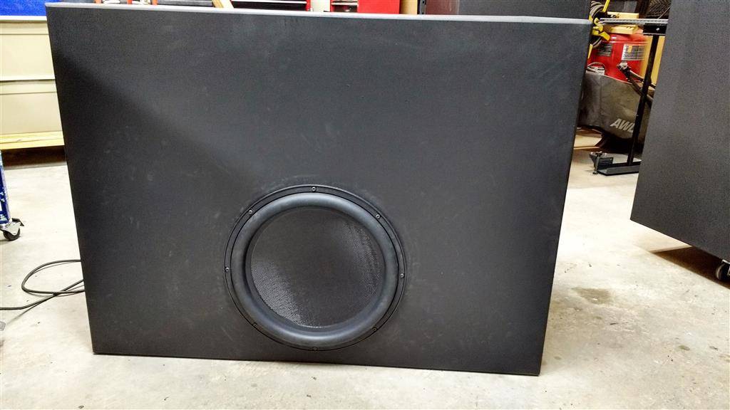

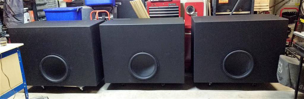

These are 16cf net each (whole lot of bracing), ported and tuned to 12Hz. The drivers are Dayton UM-18s. https://www.parts-express.com/dayton-audio-um18-22-18-ultimax-dvc-subwoofer-2-ohms-per-coil--295-518

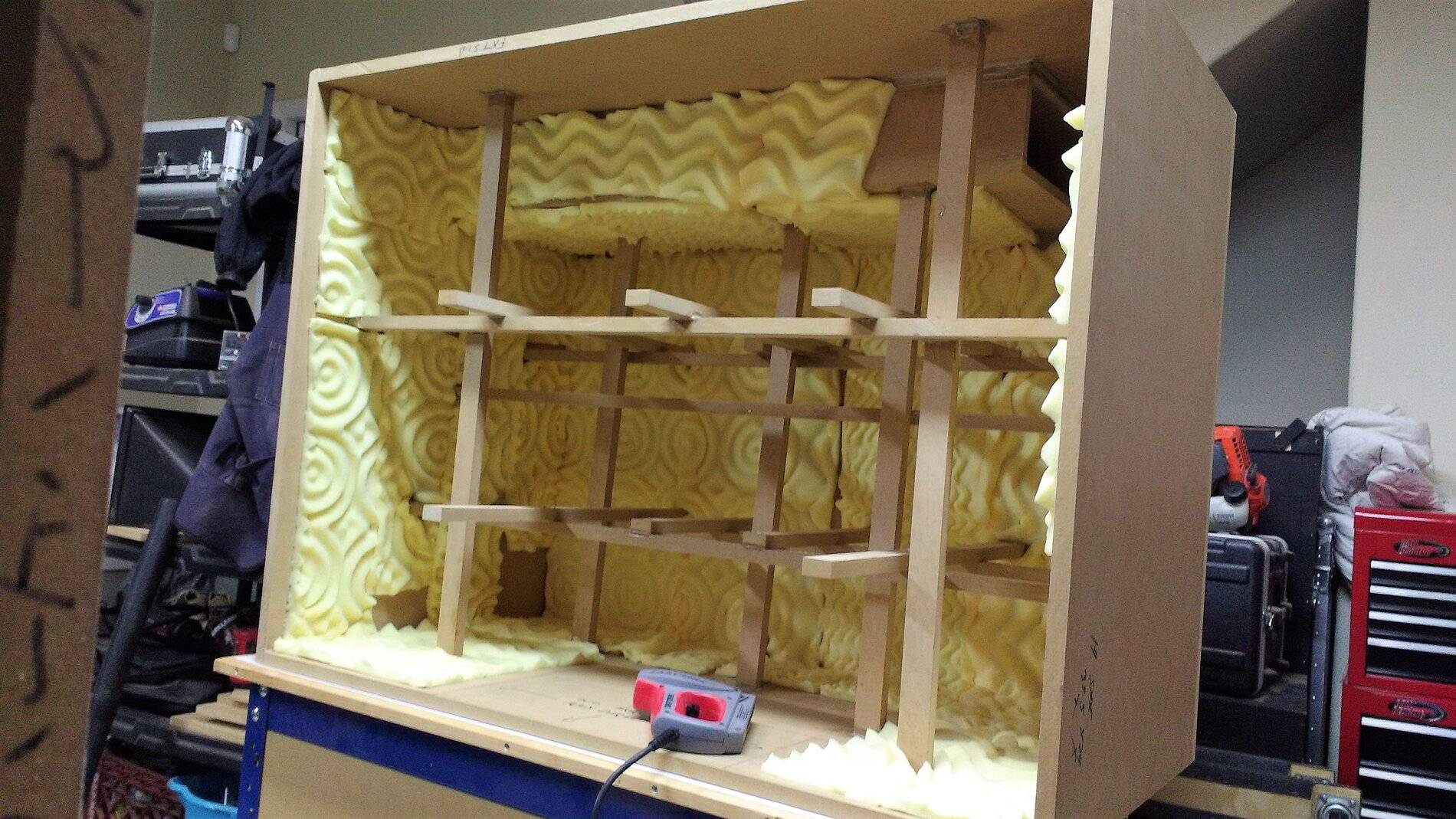

The boxes weigh about 400 pounds each. The entire baffle is solid 1.5" MDF. These are utterly ridiculous and I'll never build boxes this big again. The theater is still a work in progress, but the subs are total overkill. :D

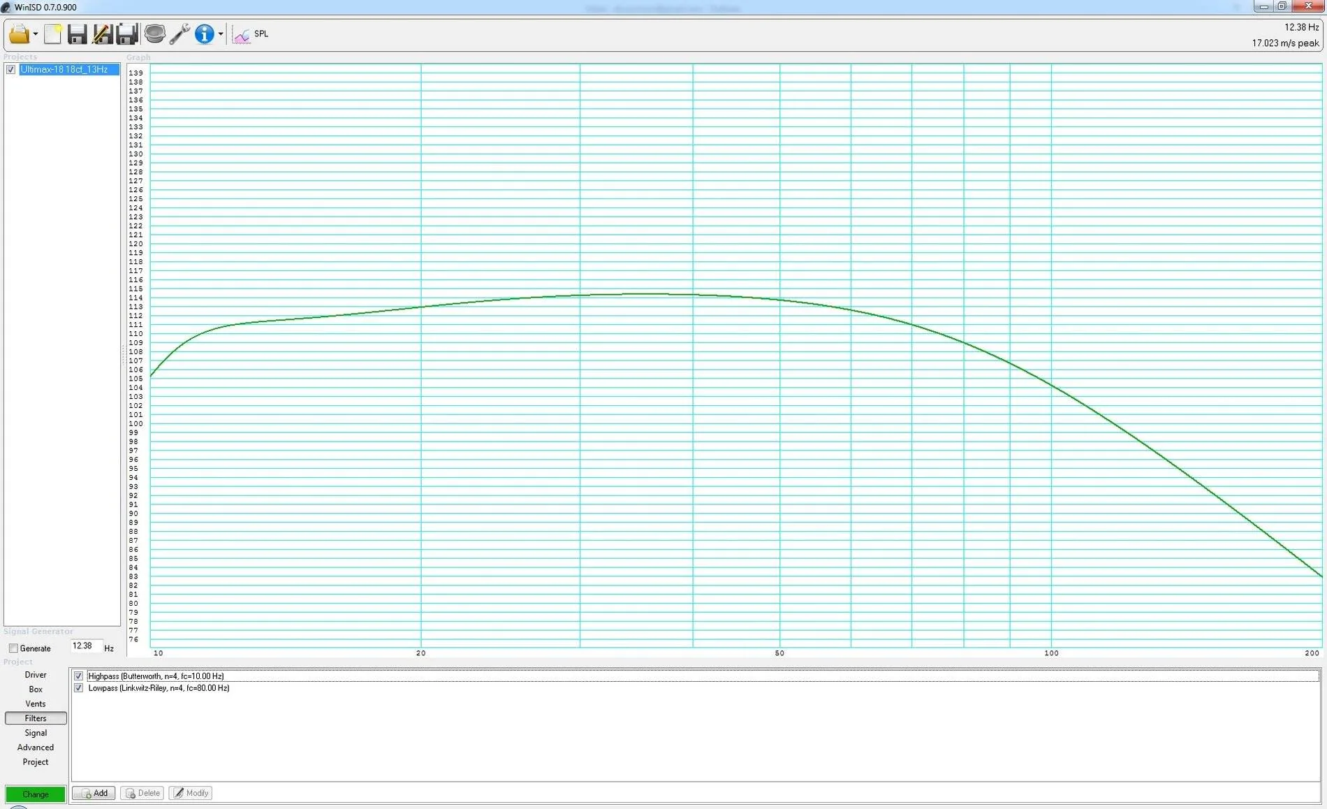

Frequency response. They play subsonic, no problem.

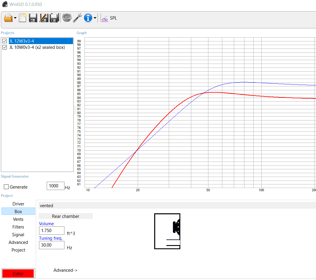

@Cathul Very nice! Did you model this in WinISD? What driver? How much does it weigh? Looks like a beast!
I was tempted to buy this box: https://www.jlaudio.com/products/ho112rg-w3v3-car-audio-h-o-wedge-subwoofer-systems-93136
Looks nice, price isn't too bad and is known to fit in the S550 with a slight tweak to those metal tabs on the rear cross brace.
Then I modeled it in WinISD using the specs that JL gives for a ported box. I compared it to a sealed box using a pair of JL 10W0v3-4 drivers (which I purchased on sale) then changed my mind about the pre-fab ported box when I compared the SPL plot (red is 12" ported box and blue is 2 sealed 10's):
The 12" ported box will play a little deeper but the dual sealed 10's will play louder. With a little EQ the 10's can dig as deep as the single ported 12".
